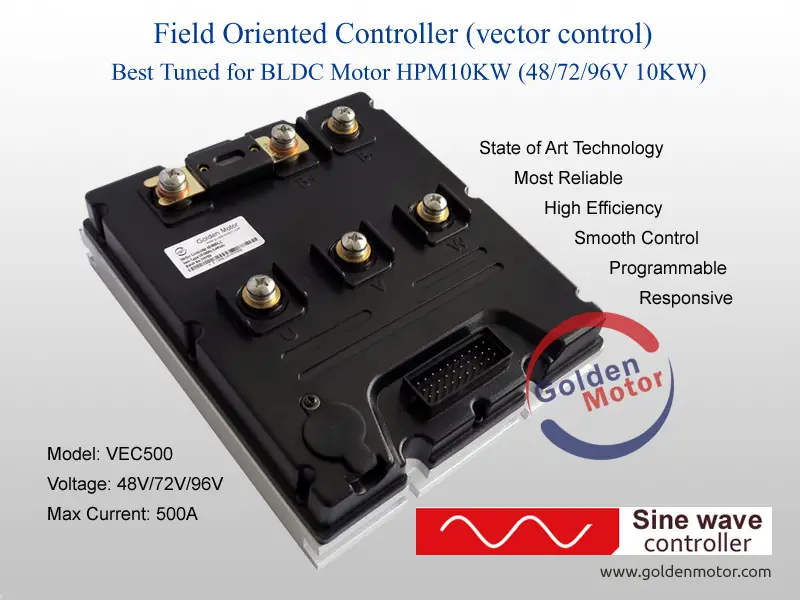

I have the specs on the 20kW BLDC motor. I have the specs on the 40-50C batteries. I have the specs on the 500A Field Oriented Sine Wave Vector Controller. I also have a calculator and all the calculations are in line with each other and speak for themselves. Speculations and approximations are pretty much meaningless at this point.

The vector controller should have a few Acceleration Profiles that I can choose from that will prevent my wheel and hub from being torn to pieces. I just need to understand where the physical limits of my bike are exactly. I have nothing to reference for any kind of guideline.
