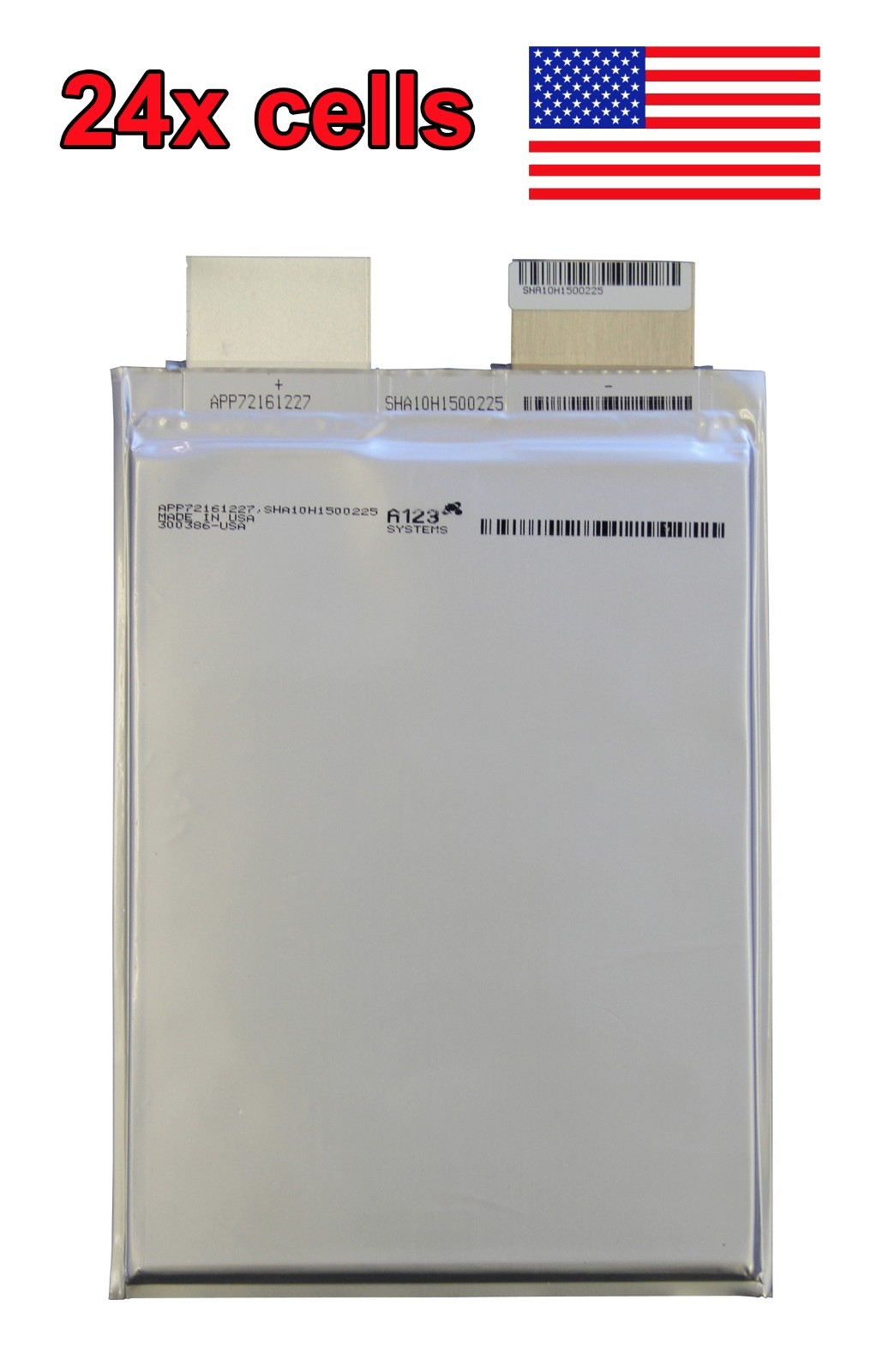

I can hold 60 of these (30 per ammo can). That will give me 66V 60Ah @ 60 lbs.
I think I'll be going with these.
3.3v A123 Amp20 20Ah Prismatic Lithium Pouch
Nominal capacity: ~ 20Ah
Nominal voltage: 3.3V
Dimension: 7x166x227mm
Continuous discharge rate: 10C 200A
Peak discharge rate: 40C 800A ( < 10 seconds)
Application: Passenger and commercial plug-in hybrid electric vehicles
Weight: 480g

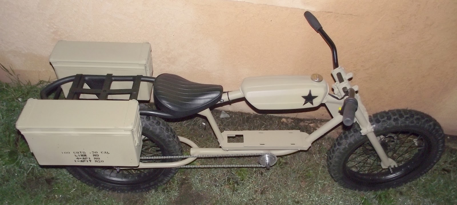

Where did you get that bike??? I never seen nothing like it before. Man, that's a whole lot of power. And I mean a whole lot. You might want to hire an electrician so you don't blow up your house.
I welded it together from a bunch of steel tubes.
Whole lot of power? That's a good thing right? LOL
