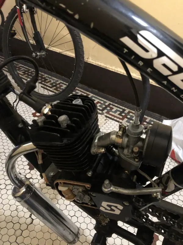

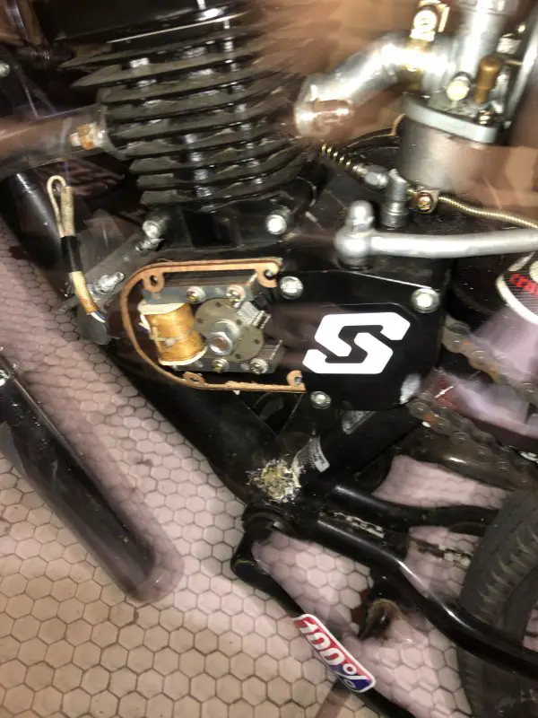

hey I been reading this forum for a while and can’t find a solution so decided to make a post. I bought a used 66cc bike off someone it’s broken in beautifully and it was running amazing. I use it for work as a courier and I only rode it for one day about 6 hours. I sat down to smoke a cig and it wouldn’t start. I pedal release the clutch and it just rumbles and doesn’t turn on. Please help:( I love riding and it’s something I’m trying to get into. I will attach some pictures of the engine and bike itself

To check for spark remove the sparkplug and reconnect the plug wire, lay the plug on the head and push the bike with the clutch out, you should hear the engine turning over and you should see the plus fire.

I was waiting for night time to come so I could check and there are 0 sparks. Is it the CDI system that I need to replace entirely? Or can it be the coil in it?
Oops I forgot to take the spark plug out ‍♂️ Let me go do that lol brb
I cleaned the spark plug real quick and plugged it back in and it turned on right away :D I’m assuming I wasn’t getting sparks I’m guessing because I have a dirty engine maybe hasn’t been cleaned in years who knows. But i cleaned it pretty darn good and in 8 hours of riding before it stopped turning on it got tons of deposit and covered the entire inside part of the spark plug with it.
