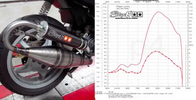

closer pic:
The spec of this cylinder matched with the exhaust should be arround 16-18hp peak at 10.000rpm. I adjusted the squish 0.50mm (0.020inch), i removed about 0.005 inch from the head, and made a little bit of magic inside the port. I beleive it should be arround the 18hp.
dyno of similar setup with same cylinder are about 10whp (a lot of loss due to the belt of the scooter)
