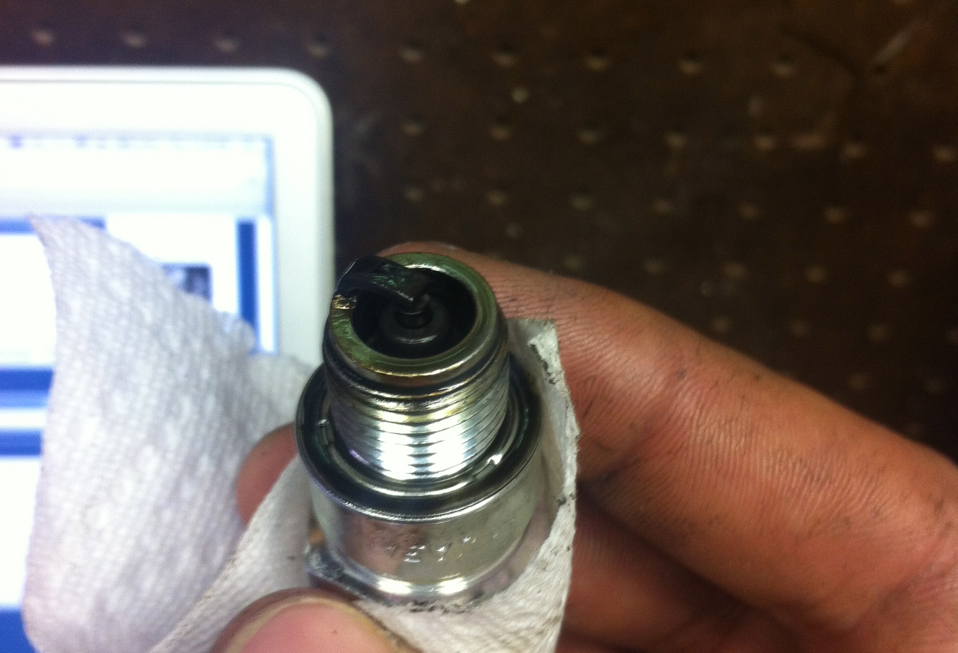

    Attached are photos from my spark plug, I ran it for 10 seconds full throttle then shut her down. Notice the porcelain part and the spark plug tip are pretty dark brown, but the ring has little oil on it (keep in mind I am using Lucas oil semi-synthetic at 24:1 (break in stage) and it is not as dark as other oils

    It may be a little rich but that's better than lean, 24/1 mix will darken the plug a bit so it might change when you go to the mix ratio you plan on running. I run a sbp high flow air filter that helps also.

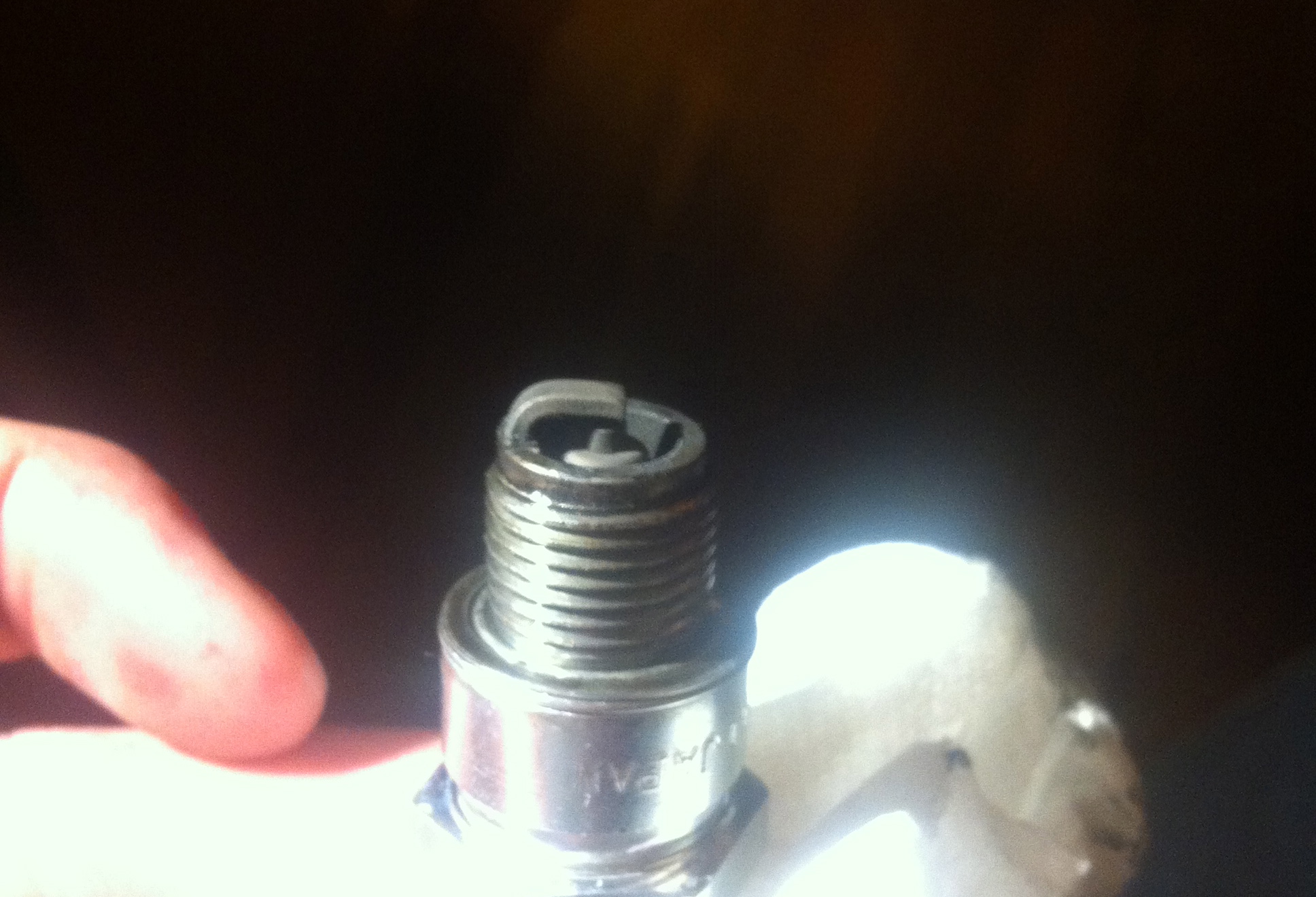

    Here's the plug after about 10-15 seconds WOT with the 65. Weird, there is a black buildup (won't just rub off) on the ring that wasn't there when I had the stock NT jet. but it runs way better. thoughts?

    With a break in ratio of 24:1 that color is to be expected. That ratio is heavy on oil which is great for proper engine break in.
    The carbon buildup should not simply rub off with your finger, ever.
    10 to 15 seconds really is not a long enough time duration to properly color the spark plug.
    Riding in down the road under a load (not down hill, that's cheating yourself) for 1/2 mile is the minimum I hesitantly recommend. 1 mile is better, 2 miles are perfect.
    Also, once a spark plug is heavily blackened by a very rich carburetor tune or low gas/ oil ratio the spark plug gets a permanent stain on it and getting a true color imprint becomes nearly impossible.
    I recommend burning through 2 gallons of fuel before worrying about fine tuning the engine. So long as it starts without excessive struggle and runs down the road without stalling you are good enough for the break in period.

    Other members here have said that the angled plug heads run hotter than the straight plug heads. If it is shaved as well like Greg58 thinks, then it definitely will run hot.
    I doubt that you have done any damage yet. You would have seen a silvery deposit on the spark plug which is actually aluminum melting/ burning off from the piston's crown.
    Also, extreme heat will eventually warp the cylinder head and cylinder and over time lead to a blown head gasket which you do not have.
    A spark plug's temperature has everything to do with it's ability to keep itself clean.
    Also, running a spark plug that is too cold will not give a good color imprint as it needs to be self cleaning and a too cold spark plug cannot do that.
    A B7HS plug will be able to burn off the oily deposits better as it will run hotter, but not make the engine run noticeably hotter. You may even end up needing a B6HS in the end, but don't jump to that one right away. Change spark plug heat ranges one step at a time.
    Adding an extra head gasket will lower the compression ratio and reduce the engine's operating temperature. Also, lowering the needle clip position one notch will add more fuel which will help cool the burn temperature but also increase the tendency for 4 stroking which is the issue at hand. I vote for an extra head gasket.
