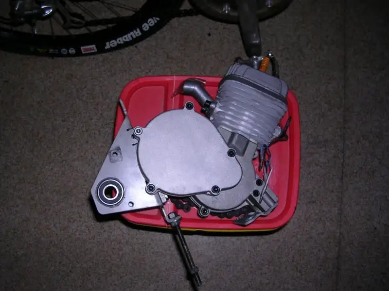

The balanced/ lightened crank engine from Dax came today and I started to put it in but my hand/shoulder gave up. I will prolly finish it tomorrow and fire it up for the first time.

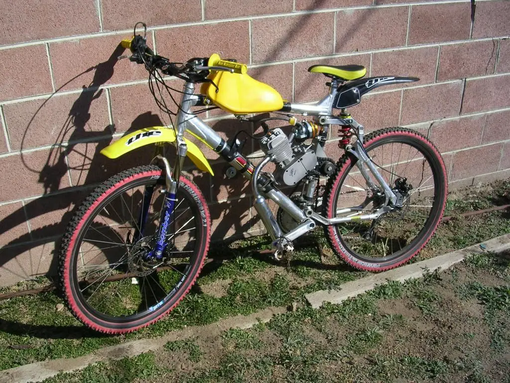

First smoke and first ride today!!! I am very happy with my first build so far.
Fired up on the 3rd try but flamed out because I was going too slow and didnt get the clutch in in time. Once it fired up I rode around in the back yard doing figure 8's then went out front on the street. I shifted a few times and went up the hill my street is on, its pretty steep but 2nd gear was no problem.
I went with the stock pipe for now since Im just breaking in the engine and running 20:1 so power doesnt matter yet and it gives me more time to decide exactly how and where Im gonna mount the SBP pipe.
I put on the new wheels/disc brakes after the first ride and it stops great. The second ride was my little dirt farm road/trail daily ride, I still havent hit high gear yet or sustained any speed but I did a steep dirt road in first gear and had to help by pedaling. I did some slow manuevering around some trees, hit the berm on the trail and even the ski jump but I didnt get any air yet.
Then it happened.........I ran out of gas. I didnt put much in just in case there was a leak and didnt figure I would go far but I couldnt help myself!
I had to pedal about 3/4 mile to get back home, I was wondering how hard these things would be to pedal since theres so many chains, and sprockets, not to mention you have to pedal thru the clutch even tho its pulled in it adds to the drag. It wasnt to bad to pedal engine off but I wouldnt want to go too far.
Overall so far this thing is great! Smoooooooth ride!

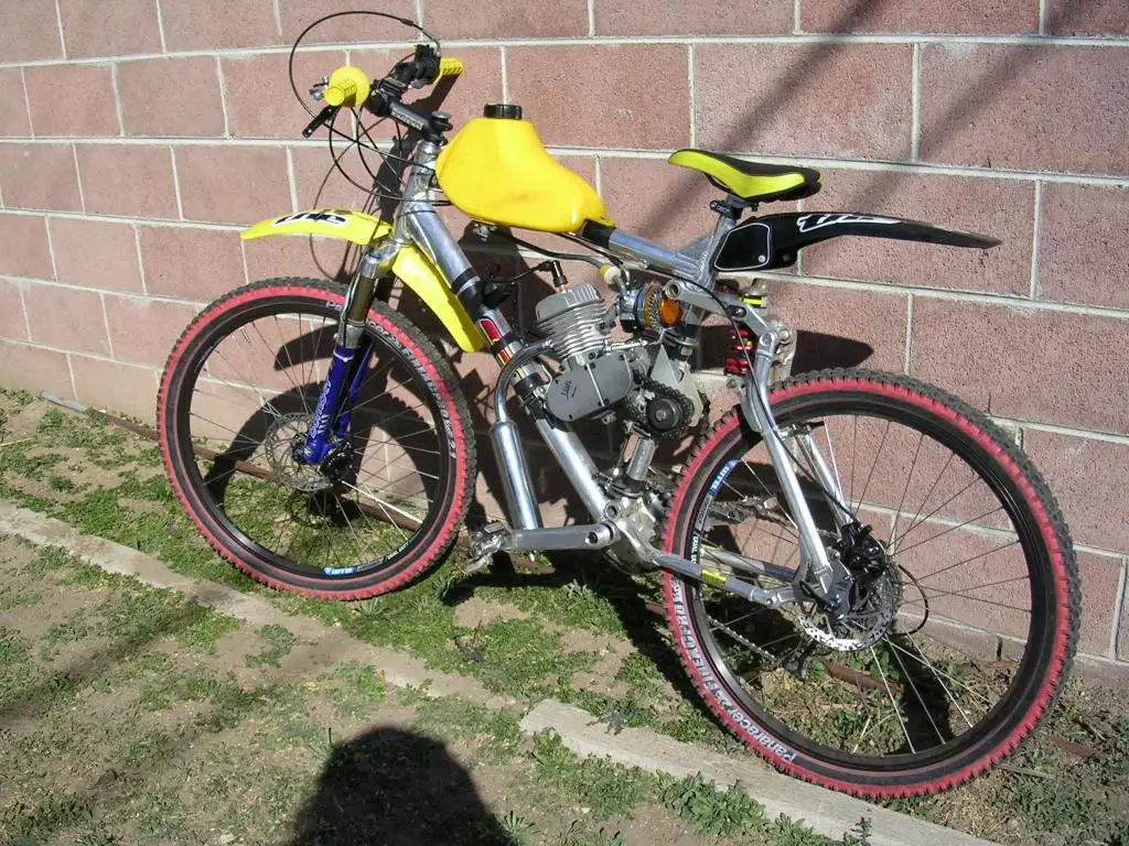

Bill this thing is awesome! Perfect all around build! The dual suspension must be a dream aha.
But i was wondering, the down tube diameter is 1.5" right?
And the U-Bolt is more than strong enough, correct??
I might have to do a 1.5" downtube build myself...
Isn't this mount somewhat overkill?
