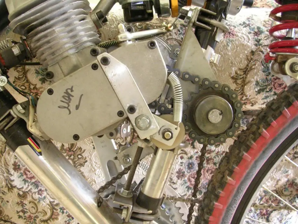

My idler sprockets came today so I made a quickie chain tensioner. I had been having a problem of the right side chain coming loose even after a short ride and it caused the chain to jump off twice in bouncy terrain, one of those times it wiped out the main bike drive chain. I test rode it on the street a couple times around the hood and it seems to work great but I still need to test ride in the rough stuff to see if the chain still jumps off. I doubt it will. I still am gonna make one for the left side chain. I dont like the way you have to adjust that one, its a pain in the a$$!
EDIT:A day later and the idler seems to have done the trick, the chain hasnt jumped off yet. I have ridden over some rough terrain and left the clutch out and a little throttle on without a problem but I havent really stayed hard on the power thru the rough stuff yet, prolly next ride.
2nd EDIT: Several days later and still the chain hasnt come off and I have been hitting rough terrain everyday with the throttle on,but still not full throttle thru bigger bumps but that will be soon and Im sure it will be fine. This tensioner seems to work great!
Heres a pic of the new tensioner....

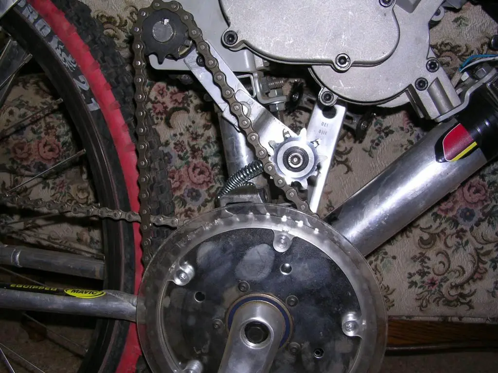

I made the chain tensioner for the left side today, sure beats removing the engine to get to the shims between the engine & jack shaft bracket then have the chain loosen up after the first ride.....arrrrrg!
Then another test ride-WOOT! I think I make changes just so theres an excuse for a test ride. I used the stock kit tension wheel for now but I need to find a better one thats not hard plastic.

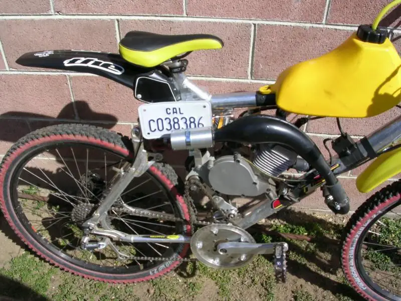

The California License plate came today, the things are huge! I couldnt find anywhere to mount it that didnt look bad so I mounted it here. I hope Johnny law doesnt mind it being there.

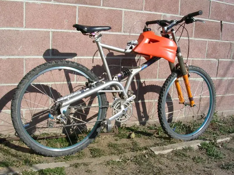

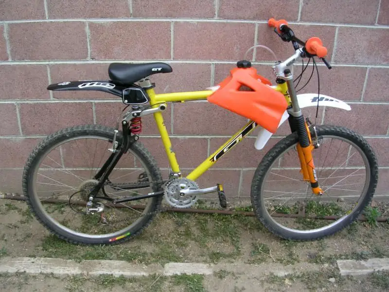

I just got a fuel tank for a KTM 50 (kids dirts bike) and I may build a second bike using it. The bike in the pic isnt the bike I would use for the next build for obvious reasons but thats the tank and maybe even the fork...

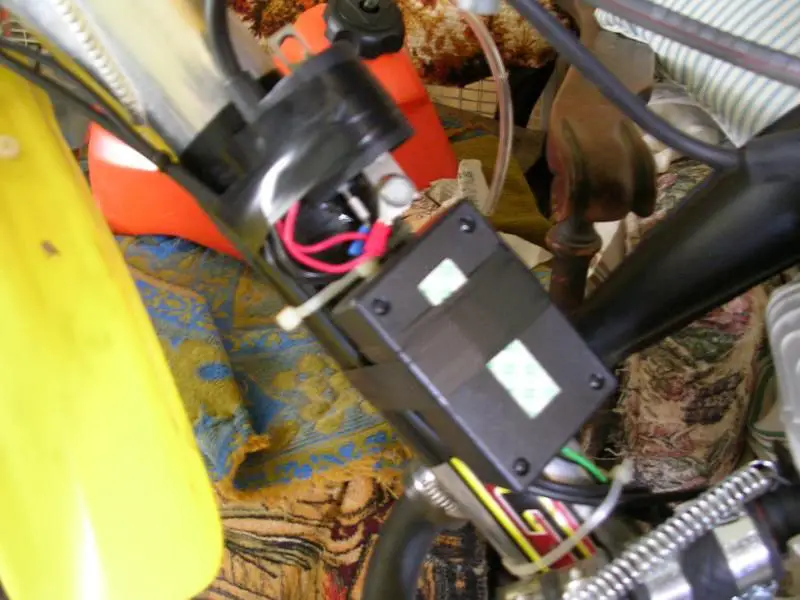

The Jag CDI comes with a coil and a seperate box where you take the rear cover off and change the 2 little jumpers to change the ignition curve. I mounted it upside down for now to make it easy to tune it.

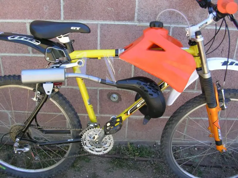

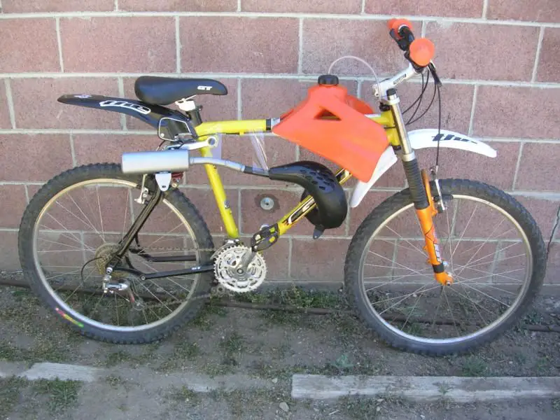

I ordered a KTM clone engine and a KTM 50 pipe yesterday,for my second build, a chromoly GT LTS . The pipe was from ebay and its here already. I have hung it on the bike and I can see it can easily be made to fit.
Bummer is that the engine wont be here for a couple of weeks, when it shows Ill start a build thread for it. Heres the second build with the pipe hanging and the tank mounts finished.....
