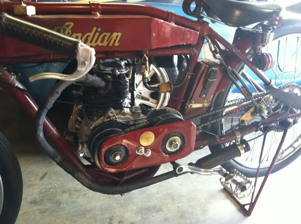

Do you have an Indian name badge on your bike?
The brass badge? Yes, it was a brass biker pin that I took the pin off the back and glued it on. It says "Indian Motorcycles" with an arrow and an Indian Head in full headdress on it. Just a little thing that makes it look neat.

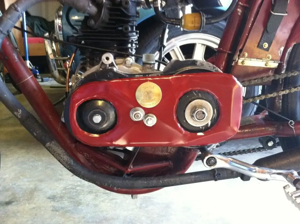

I had a thought today about my Comet series 30 Torque Verter Transmission. To date I have roughly 1800 miles on it and it works fine, but I have been through 3 belts with the 4th one on the unit now. The belts don't really wear out, they just stretch until they flop around and don't work well anymore. Then I put a new belt on and I'm back in business. I have held onto all my used belts and they are all in great shape except the stretch. And it's only about an inch. I was doing some research today and found the specs for the Comet Series 30. It says the distance between the center of the drive (front) pulley and the driven (rear) pulley is supposed to be between 6" 15/16ths and 7" in length. I measured mine and came up with 6.5" . It hit me, "No frakin wonder my belts are sloppy when broken in, the pulleys are too close together!" So I wake up at 6:30 a.m. on Saturday and in my robe and slippers (when I get an idea I have to utilize it NOW), I take the Comet off and re-do the holes that mount it to the engine case so I now have 7 1/8" from pulley to pulley. All my old belts work great. I put a brand new belt on and it works great. I think I will get full life of my belts now. The shifting is even smoother now too as a bonus. I don't know why I had lost a whole half an inch but it makes a world of difference. So bottom line, if you use the Comet make sure you have 7" inches center to center or it won't work the way it should.

I know they have the rear driven sprocket in 6" and 7" sizes. They probably use the same belt size for both, and it works ok until it stretches slightly after break-in. The 1/2" lengthening of unit on the engine fixed it very nice. I got to take a half link out of the drive chain also. So what size difference do you think there is between both belts? 1"?

It says my belt (which is the shortest by the way) works for systems 6 15/16" to 7" long center to center. For a new belt that is great, but when it stretches after break in it doesn't work any more. The 1/2" farther distance I put the Comet rearward fixed it all. I put a brand new belt on and the rear driven adjusts to fit the normal belt. There are several different lengths of belts and I'm just guessing that this one fell between the cracks and doesn't work perfect when the belt stretches. I will be able to get full belt life now out of my belts.

It is supposed to be pre-drilled but just measure to make sure you have seven whole inches from center bolt to center bolt or you will need to do what I did. It's not a big deal because the Comet plate is Swiss Cheesed any how, lots of room for other holes. You are going to need to make four holes anyway if you were planning on mounting the Comet at the same angle as me anyhow. Now that I think about it, my Clone engine is not a "true" clone because there are little tiny differences such as it takes it's own proprietary head gasket that is not interchangeable with any other clone engine. It is entirely possible that my four mounting holes for the comet were 1/2" off from what other motors have. So don't assume it will be spot on as is.
