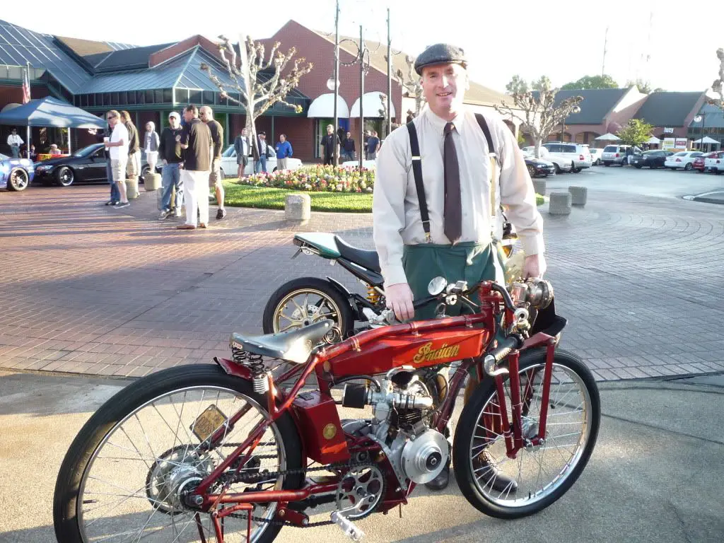

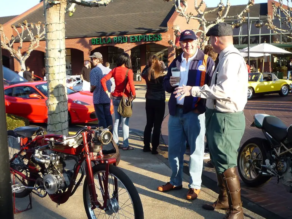

I took the Indian to the Sacramento Euro Sunday which is a big European Sports car show and shine. Lots of exotic makes of cars and motorcycles. I had a good time showing the bike and explaining about motorbikes in general.
What I really like about your bike is that it looks 'well worn' & not all new. I dunno how you achieved that but it's way cool.
Man the old/new girl looks good. I like the suspenders too ! Might as well look the part....riding in wearing modern looking clothes just wouldn't seem right. Do you have it registered as a motorcycle ?
I don't have a lot of shiny things on my bike. If it was a new part I took a wire brush to it and buffed it up. That or sand paper or emery paper to it. If it had paint on it I would put gas on a rag and wipe the paint to where it's flat in spots and thinning in others so you start to see the black primer. I over filled my fuel tank once and as the temperature rode in my garage the gas expanded and leaked out the fuel cap vent. The dribble stains look very authentic, because they are! :) Chips are real, I don't fix chips or scratches. Over the course of the build I have add/welded and removed/grinded off various parts and mounts. When this happens the sparks and grinding media will begin to sand blast and erode the paint where they hit. This was an accident but it is a good effect. All my welds are purposely welded rough/semi ground down. All the body work has intentional flaws. There is not one single part on the whole bike that doesn't have some sort if imperfetion, all done on purpose or allowed to happen. I wanted it to look like it has been in service for 100 years, and it does now.
