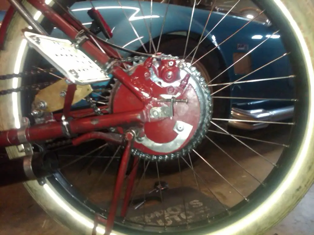

I made a cover for the disk to make it appear as if it were a rear drum brake. It's convincing at first glance. I'm going to make a faux torque arm to cover the caliper in the future.
hey that is pretty nifty...

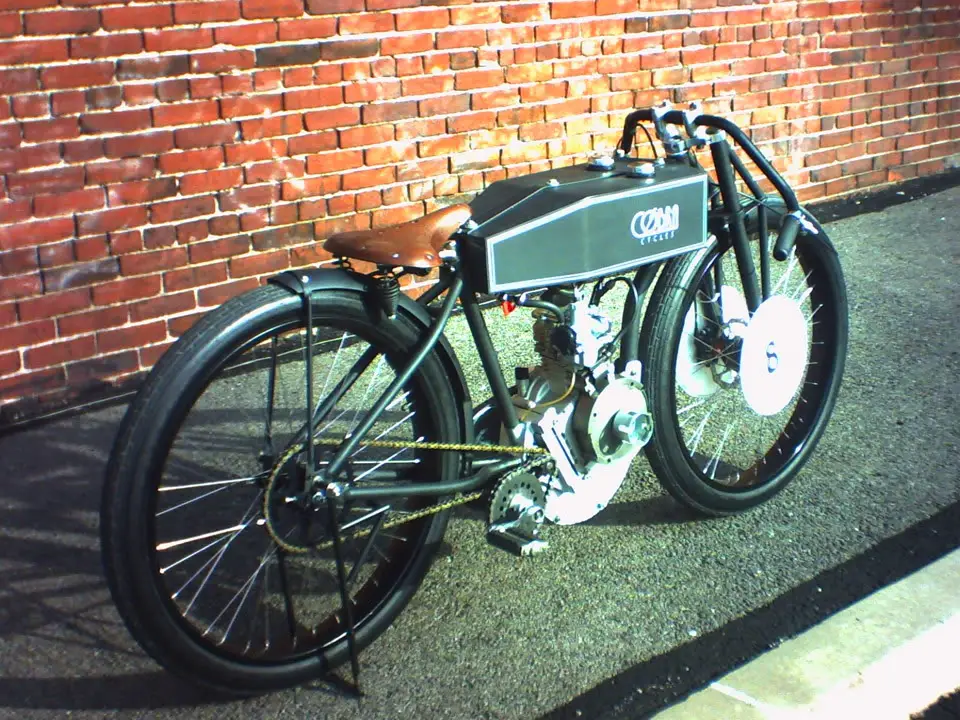

Good stuff everyone, thanks for all the replies. I bought a set of Husky wheels out of desperation last month. When they arrived I immediately regretted it. They look really good. Too good. They look way too modern for my taste. The sturmey Archer hub and brake arm look like they were made for Star Wars.
Needless to say, I'm not using them.
If it were up to me, I would use the wheels and tires that were on this build! WHERE DID THESE COME FROM!!!? WOW!3-20-11right34.jpg
