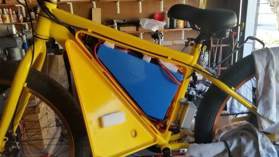

This is a 48v 30ah made with Samsung cells. It's rated for 30 amp continuous, 60 amp burst. That's good for up to about a 1500w motor. It was $625 shipped. You can't even build one for less if you have to buy all the equipment necessary to build it, like a spot welder. This one came with 1 year warranty too.

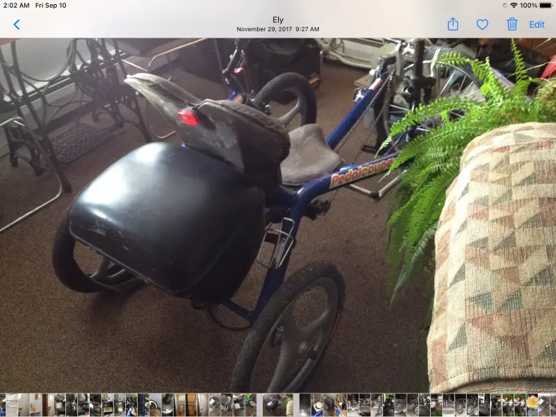

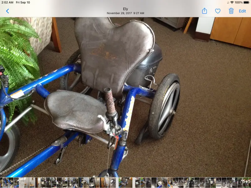

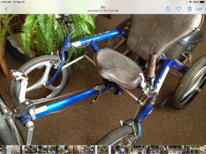

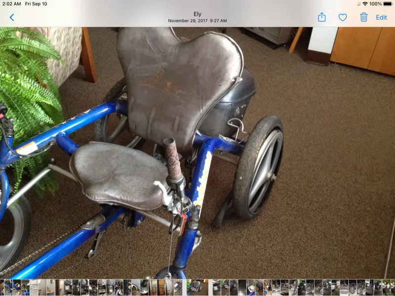

I realize this is an old thread, but am hoping some of you with knowledge of electrics and lithium batteries can offer advice on a new build of mine. The thread is called Pedal Coupe and it is in the electric recumbent/trike section. It originally had a 24V assist through lead acid batteries and I want to switch over to 52V 18650 cells. New territory for me so I’m looking for advice. Thanks,
SB
SBView attachment 108682 View attachment 108683View attachment 108684
The type if battery doesn't make much difference, but the voltage does. If you up it to 52v you'll need to change the controller, and computer to match.
No computer. Just the controller to the battery voltage. The motors will accept the voltage given them unless they are really weak one
