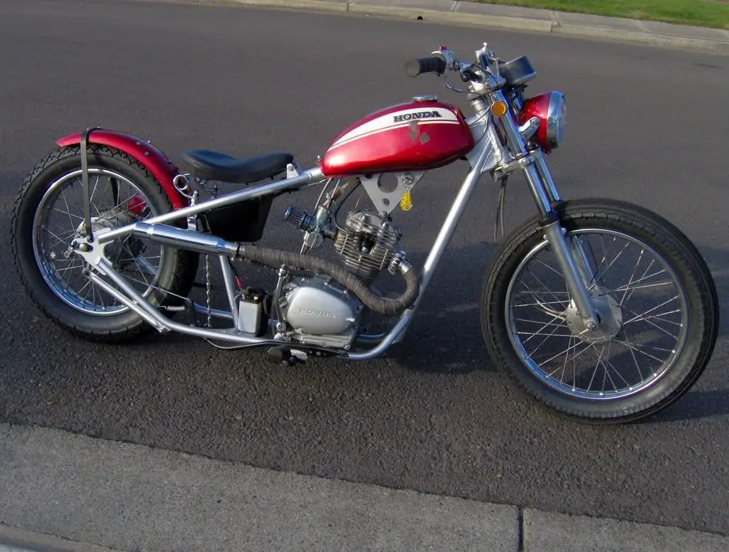

Awesome build! I would suggest using the wheels off of the motorcycle you got the engine from. You might be cheating death riding that with no brakes. Here's on I made with a HONDA 100CC engine...
