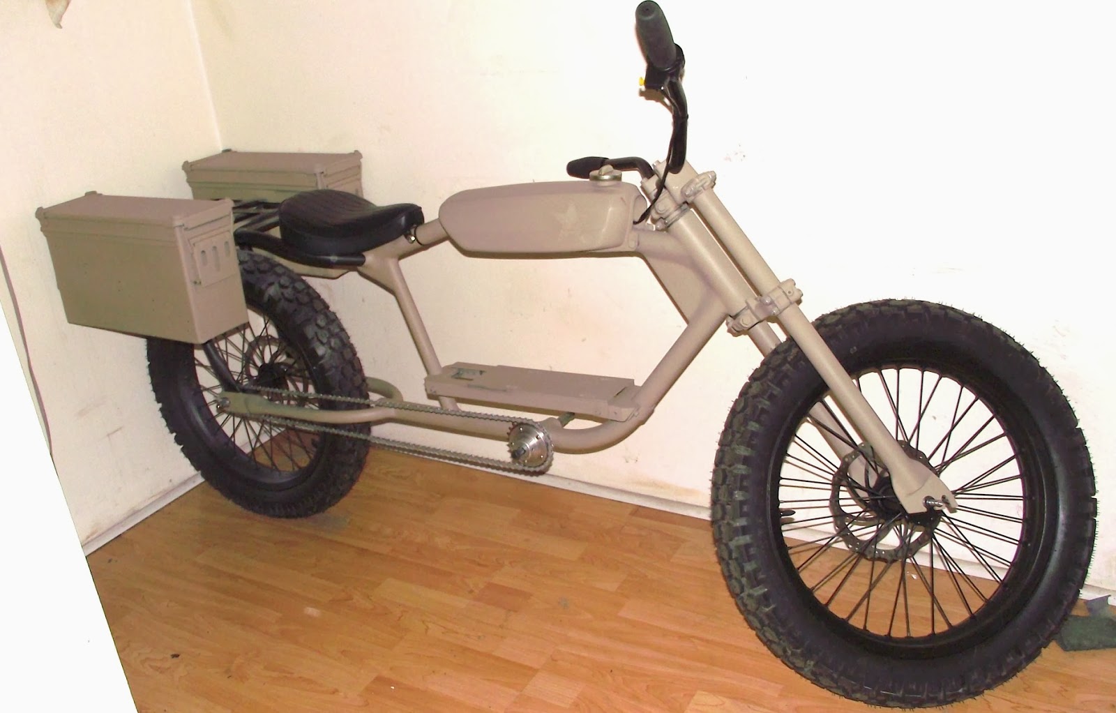

I'm building a 2 wheeled Urban Assault Vehicle with dual 40mm grenade ammo cans in the back to hold 70 lbs. of LiPo's (72V 60Ah). When it's done, I'm gonna go crush stuff with it. LMAO

Each ammo can will be holding a 72V 30Ah 25lb battery bank. Together both banks will be capable of dumping 300A into the motor shown above for up to 1 minute. Going from 9.5HP to 19HP at the twist of a wrist. That will be my passing gear. LMAO
For those who don't know, in the picture you will see a 5A battery with a "25-50C Discharge" rating. The "C" stands for Capacity. This single battery can discharge 25 to 50 times its 5A "Capacity" at once. I will eventually, one day, have 24 of these Lithium bricks filling those two 17" x 5.5" x 10" ammo cans. zptzptzptzpt

From my experiences from my beach cruiser, try to mount the motor as far front as possible. I carry two batteries on my rear rack which weighs around 40 lbs and sometimes it feels like I'm riding a unicycle because all the weight is in the back. Your bike is going to be one bad ash ride when it's done.
The good thing I like about your batteries is you won't have to get a Kevlar bag when charging them since they'll be in metal ammo boxes.

My batteries will weigh 50 lbs for 48Ah or 75 lbs for 60Ah. Each box holds 72V 30Ah maximum. I'll push that motor as far forward as I possibly can as long as I don't have any long chain issues cause that bike is long long.

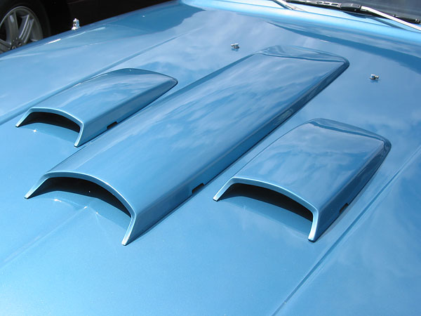

might want to drill some vent holes in the bottom of the boxes so they're not sealed up in case things get hot.
Just like I did on my last bike. Maybe this time to also include hood scoops? LOL
