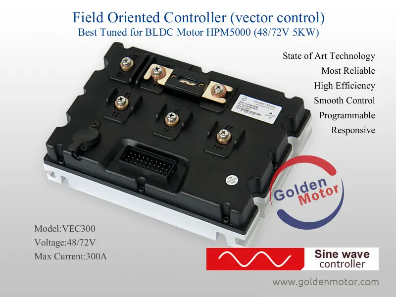

9s2p 108A x 65V = 7,020W (continual)
300A x 65V = 19,050W (30 seconds) Warp Factor 9 Mr. Scott! Aye Captain!

For 30 seconds I'm going to shatter the Amax reading shown on this CA. I'm not sure what the Smax reading will be, but It'll be posted on here as well. Shock and Awe. :)
Holly cow batman, I'm going to send you a pair of asbestos underwear. It's possible you might be the first eBike rider to orbit the moon.
I'm just not sure how much asphalt I'm gonna need to do that. I might have to sneak onto the 405 freeway for just a quick bit, early early on a Saturday or Sunday. LMAO
