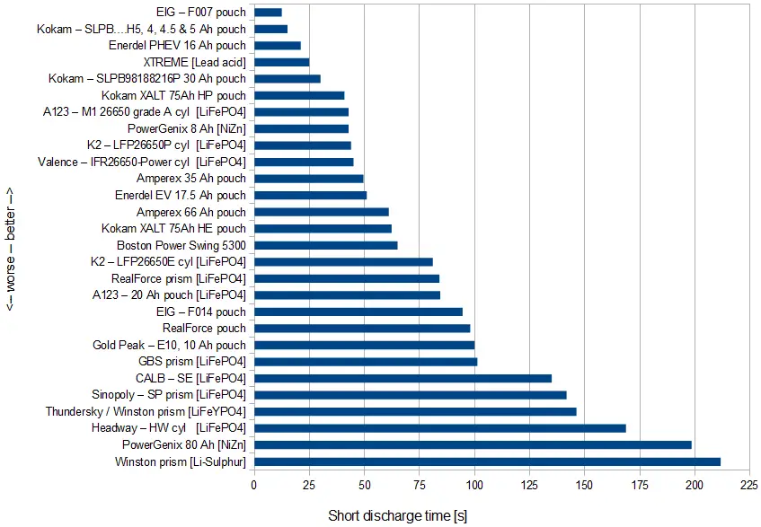

You are again confusing "Ah Capacity" with Discharge Rate. Like I already said before. That rule only applies to "Ah Capacity" as clearly shown in this pic that I will put up again.
And you are still ignoring this reality. Not sure why that is. LOL

Chart below clocks the time it takes for a battery to completely discharge itself from a short circuit.
