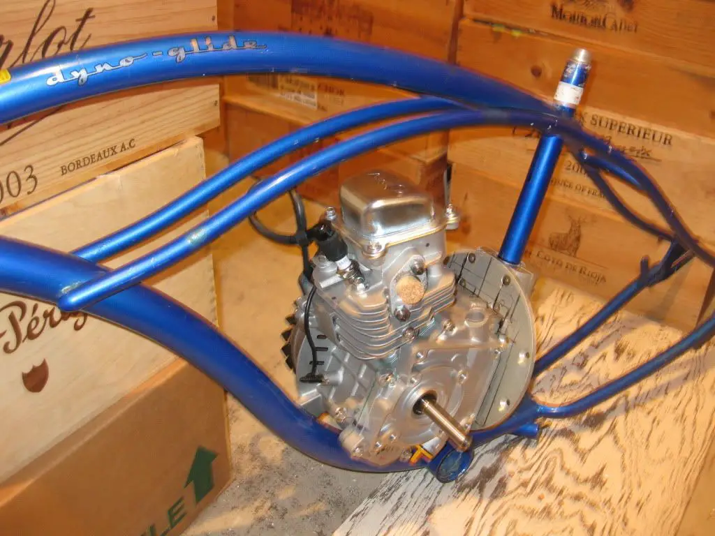

Well I guess I can start my new build thread finally........been waiting over 2 years to build this bike but it is for daily street use rather than for racing as originally intended. I have to thank the following members of this forum for making this build finally possible: agk (Shane) for several high performance parts for the engine, dmb (Dennis) for the cool Dyno frame, Thud (Todd) for getting this 99cc Pred engine to California for me, steveco55 (Steve) for the motor mounts, maurtis (Mike) for the 90mm Sturmey Archer front hub, and all my racing buddies and friends for their inspiration and support. Thank you!
Day one of many.......ya gotta start somewhere.

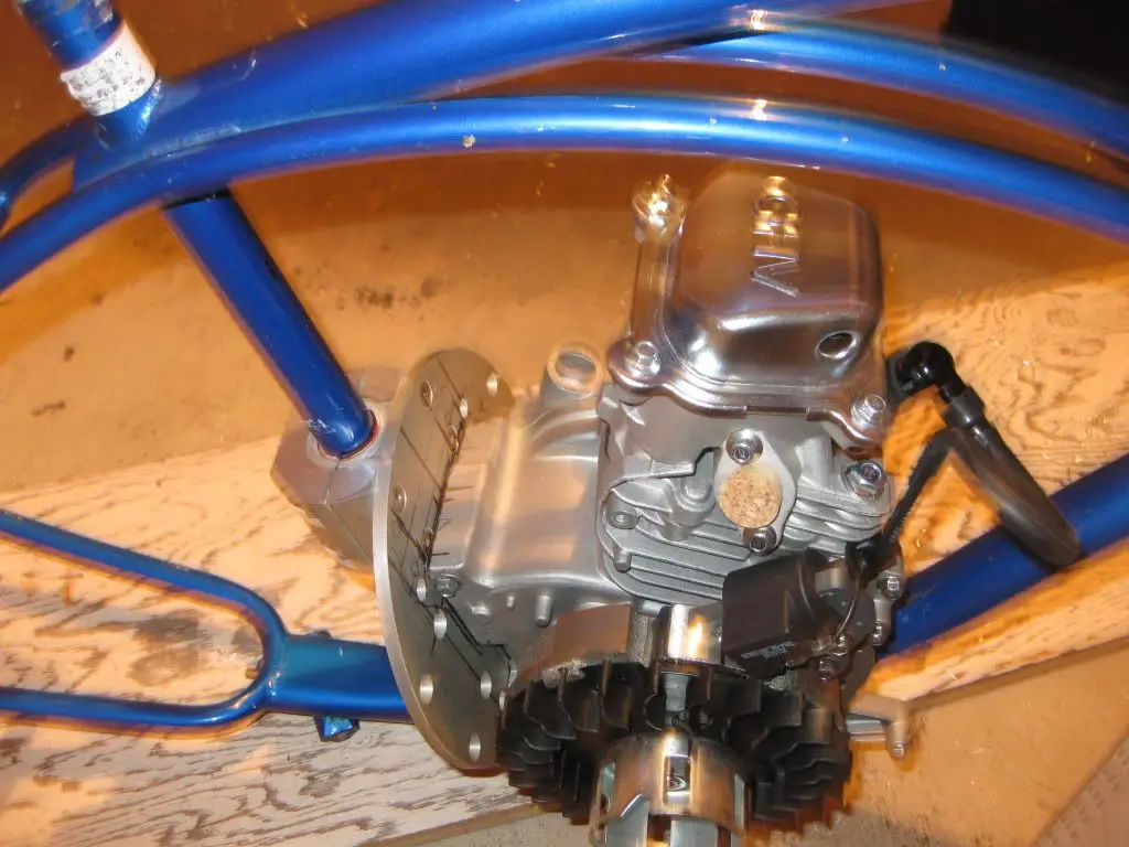

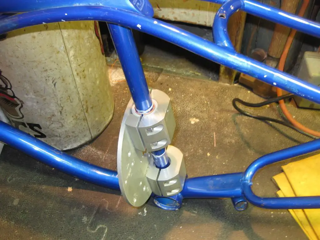

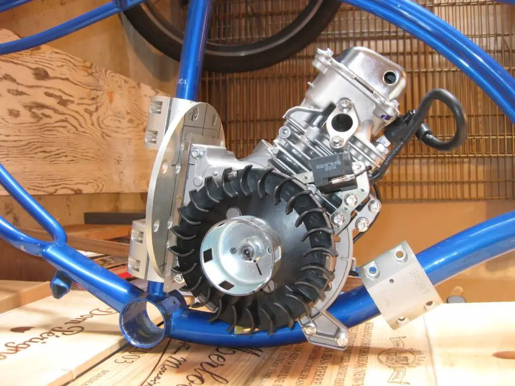

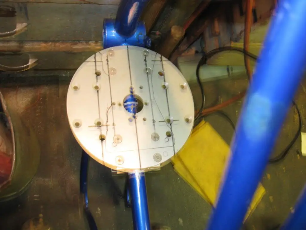

So I got the motor mounts fitted, figured the engine placement on the soon to be finished mounting plate and am working on the front mount and other aluminum beef-ups.
This is going to be an awesome build!

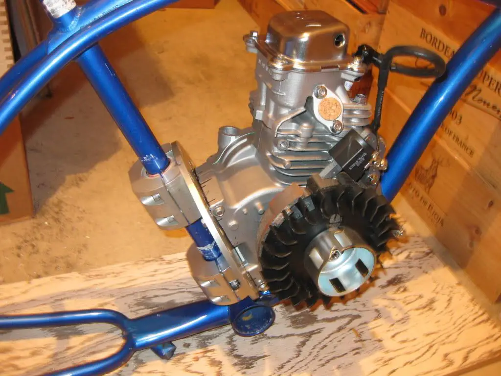

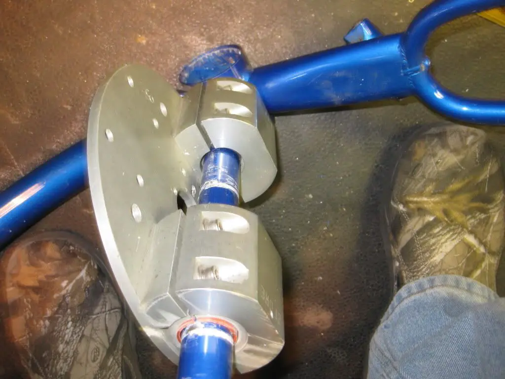

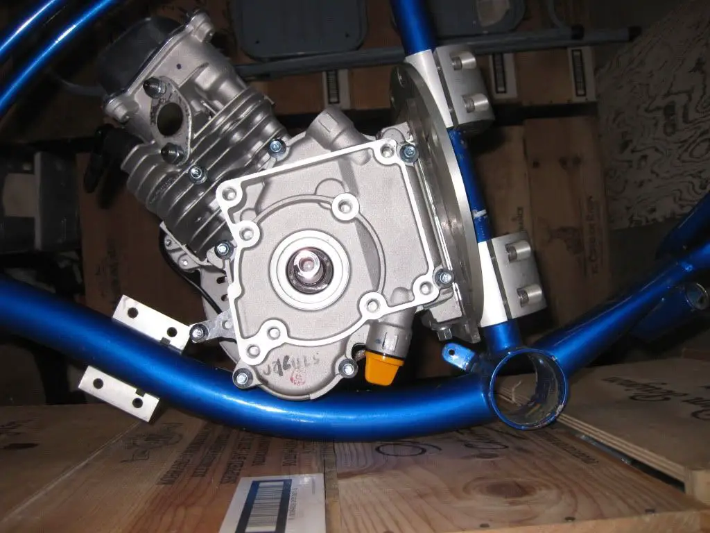

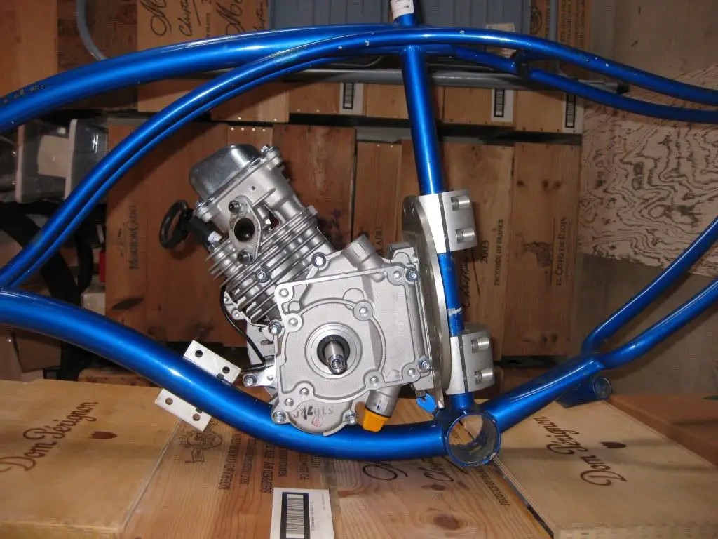

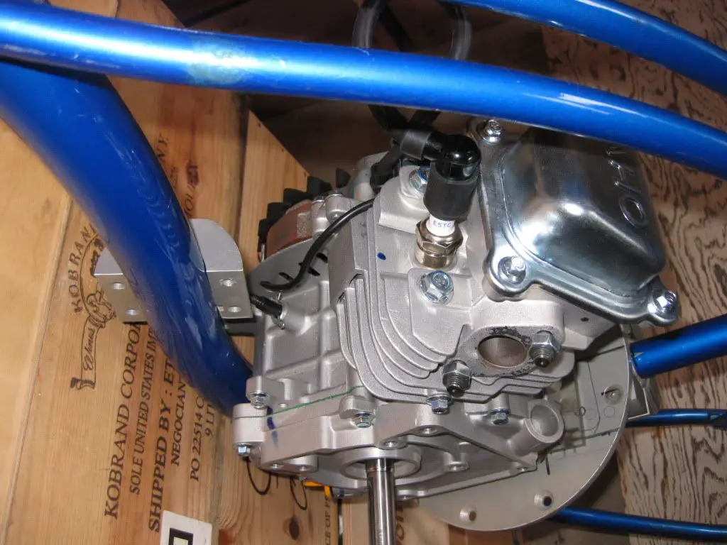

Here are a few spy pics of the engine being mounted.......
Now try to imagine the frame being the same color as the engine and mounts....
I did say imagine.

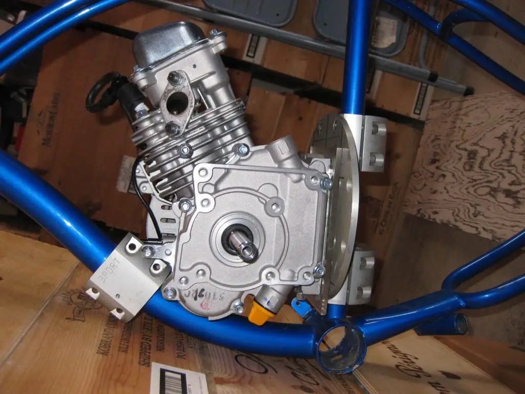

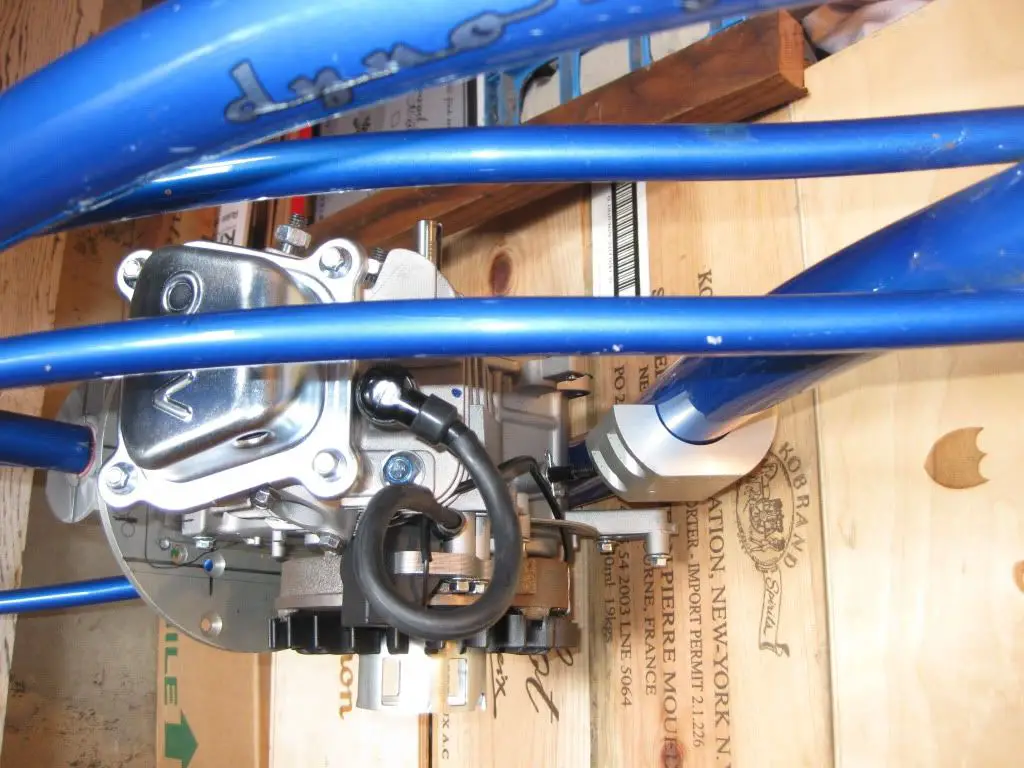

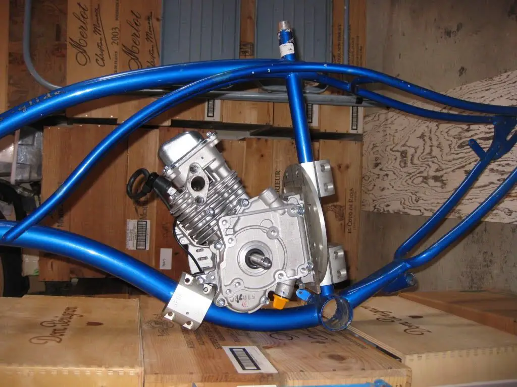

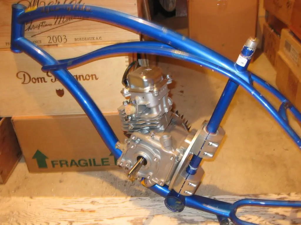

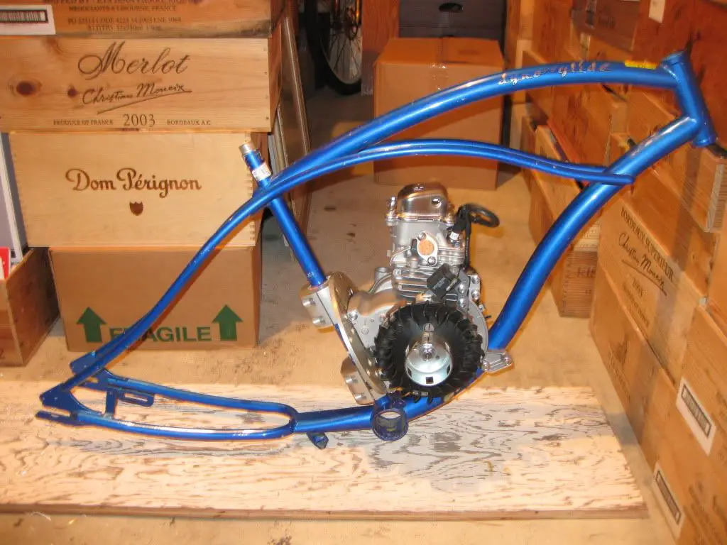

A couple more for good measure......
Long way to go.......on the mounting plate alone. I want everything precise on this build, it is gonna take some time ;)

Thanks guys, this mount for the engine is really making things easy so far, it's kind of a fluke really. The mounts will also make the set-up of the scott-o-matic transmission a breeze laff
