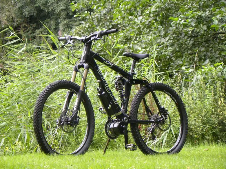

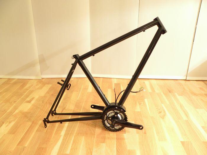

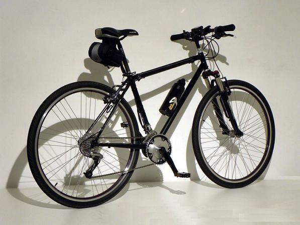

I have been looking at electric bikes as a possible pedal assist. I like the hub motors, but have found a couple companies that use mid-drive systems, namely a replacement bottom bracket. I was inspired on Endless-sphere.com by a gentleman named Nader who has built some of the cleanest looking bikes. He uses a water bottle to hold the batteries and usually a tool bag for the controller. The bike that inspired me the most was his Bofeili build where he had to have the frame modified to take a Bofeili motor drive. I've found a kit from a Australian Bofeili seller and I am going to contact the US bofeili seller.
http://motorbicycling.com/attachment.php?attachmentid=54799&stc=1&d=1356584426
http://motorbicycling.com/attachment.php?attachmentid=54800&stc=1&d=1356584509
http://motorbicycling.com/attachment.php?attachmentid=54801&stc=1&d=1356584665
http://bofeilinz.com/motor-kit.html
http://www.e-bikesusa.com/Index.html
Here's a link to Nader's builds on endless-sphere.com:
http://www.endless-sphere.com/forums/viewtopic.php?f=6&t=19872
