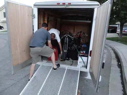

Here is Rich and Skip loading up the trailer.

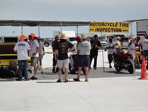

Here we are lining up for tech inspection. It is a two part inspection. First you go to the first station where they intimidate the heck out of you and then you go to the second station where they intimidate the heck out of you again. This is make or break for many teams. Months of preparation and cash on the line to see if you did your homework. My approach was that failure was not acceptable.
Bonneville Adventure by Sportsman Flyer, on Flickr

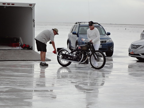

Part two, tire inspection and ALL the mechanical stuff. They looked at the welds, they wrenched on the handlebars, looked for steering stops and a stabilizer, checked for DOT approved and SPEED RATED tires, then you have to fire it up and prove the safety systems actually work. Of course after all this scrutiny WE FAILED TECH! I couldn't believe it. They got us on a fork issue and had us add leather friction washers to the linkage arms. We scrounged up some leather, made and installed the washers and got our sign off.

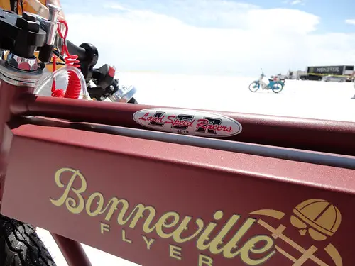

Alright, so here it is, the all important tech inspection sticker to show you passed. The sticker also comes with a real racing log book! The inspector told me the sticker has to go on the frame, can never be removed, and is next to impossible to get replaced. This is without doubt the most important sticker I have ever owned! Ain't it sweet? LSR 4019 is now forever owned by Bonneville Flyer chassis #1. Two other big blue stickers were also applied to the other side of the gas tank and one of those is signed in tech. Each time you make a run these stickers are verified to be in place.

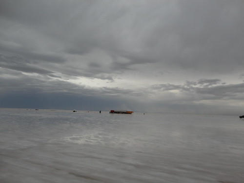

That was the end of Friday afternoon. We passed tech and went back to enjoy a few cold beers. Best beer(s) I ever drank. Suddenly the winds came up, lighting started hitting the ground in the distance and the lightning and thunder were very close together. We scrambled around the pits, stuffed the bikes back into the trailer and got the **** out of there. It looked as though we might get rained out. All that hard work only to get rained out. Turns out the thunder storms, which happened the first three evenings we were there, came and went quickly. It did affect the salt conditions, though, making morning runs slower than afternoon runs in the heat of the day. We ran faster at 90 degrees plus air temp in the afternoon then we did at 75 degrees in the cooler mornings. This played with race strategy in a huge way.

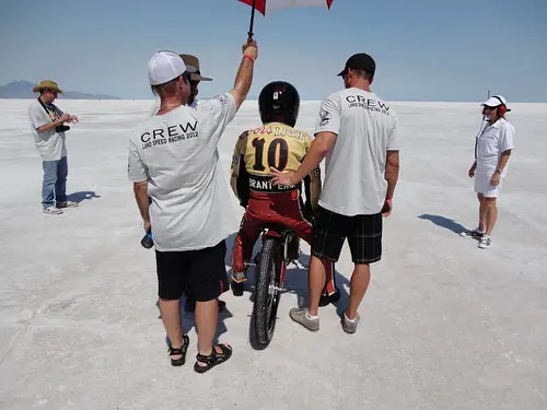

Here we are getting ready for the rookie pass. Plan was for me to fire up the bike with the remote electric starter and run back to the chase truck, then Rich and Shane would push Gunther as fast as they possibly could into the course because of the tall gearing, then jump into the truck and we would chase after Gunther to recover the bike. This worked well. We would accelerate into the course, hit the mile marker timed section at maximum speed, then hold it wide open through the two mile timing light.

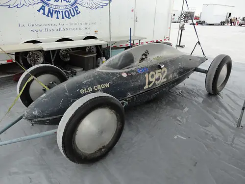

Bonneville is an awesome experience. I saw the "Old Crow" racer there 2 years ago. Got to talk to the driver and get pictures with my son at the start line. Crazy thing is that it's a fuel tank from a P51 Mustang. The variety of cars/bikes is amazing. Seeing a streamliner go 300+ and then in the pits spot the duct tape all over the inside of it is pretty great.

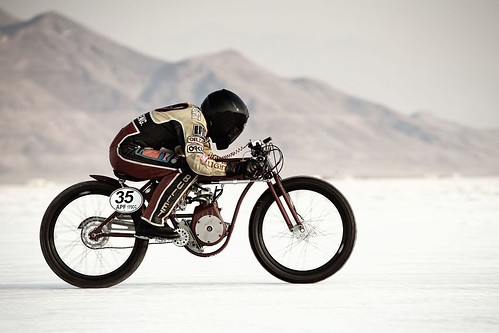

I will update this thread with the rest of the story soon. I am sure there is some video floating around and will add it once I get my hands on it. In the mean time here is a cool action shot at speed on the salt. Just add engine sounds.....

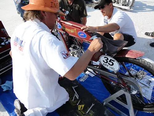

So, here is the story on the forks. I had read in the rules that any sprung suspension must have a dampening device. We had sent the tech guys pictures of our forks before hand and had tenative approval on our design. Well, during the actual inspection one of the two inspectors said we needed additional dampening. He suggested a simple leather washer placed between the fork swing arm brackets and bronze bushings. It seemed easy enough to add so we found some leather, cut the washers and added them in. This allowed us to pass. There were plenty of old Harleys with friction dampening and they passed tech, too.

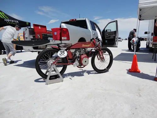

Back to the important stuff, racing! Here we are taking off for our first timed run. Rich and Shane pushing and Gunther under power. Tall gears make for slow launches for everybody. In this respect we were no different than anyone else.

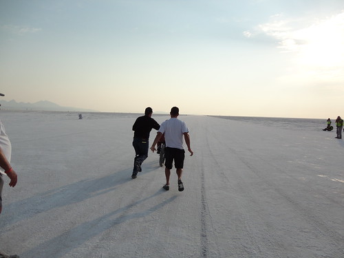

Up early the next morning and back to impound to collect the bike. All record runs require a back-up pass and that happens at 7am the next morning before the courses are opened to everyone else. We went back out and lined up for our run. Same routine, I start the bike, Rich and Shane push Gunther into the course, and we follow in the chase truck. After this run Gunther was not smiling. He said everything was going great and he ran up to like 72 mph, but at the 3/4 mile marker in the timed section the engine just quit. All he could do was coast through the last of the timed section and roll off the course. We were pretty bummed as our back-up run was toast. Anyway we went and collected our time slip and were in luck. Gunther was running at 72 mph when the engine quit, coasted through the end of the run at 64 mph and that gave us an average of 69 mph! Our two run average was still 69.361 mph and good enough to take the record! Back to impound to tear the engine down for the displacement measurement. Once that is passed the record stands. Here we are getting the engine measured.
