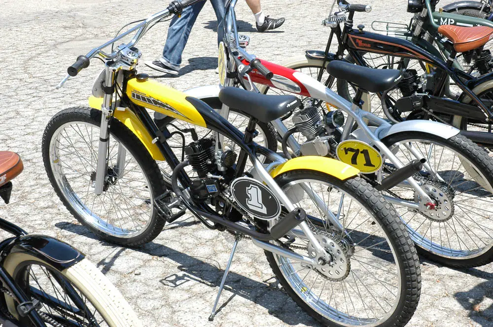

Here are a flock of Felts at a ride at El Dorado Park that HBLOCAL and
BigBoy aka Raully made.
