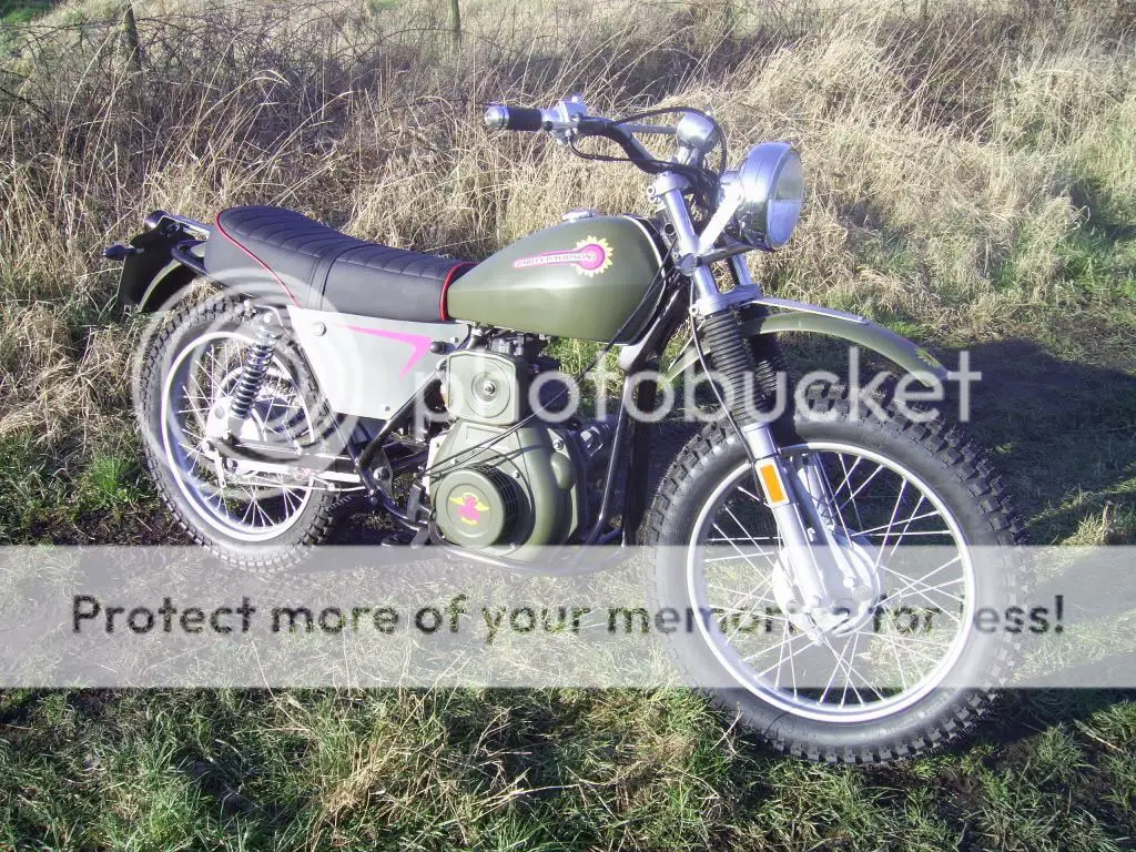

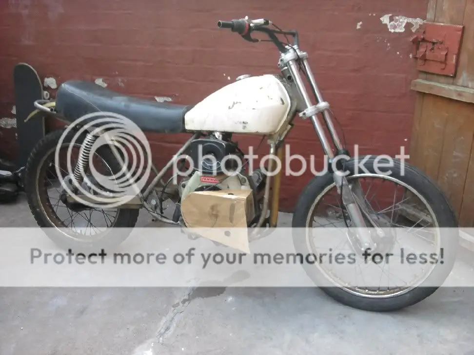

Is that Diesel engine a single cylinder or a twin? I ask because it bears a close resemblance to a twin cylinder Diesel engine that is in a small Kubota tractor that belongs to another student that was in the Diesel engine technology class I that recently took.
That engine was definitely small enough to put into a Harley 125 chassis with a little bit of modification.
HAHA Dan thats brilliant, my mrs recons you must be physic cos that songs just me she recons, hand down me bills an mostly doing nothing, I really like that song too, I might buy it LOL.

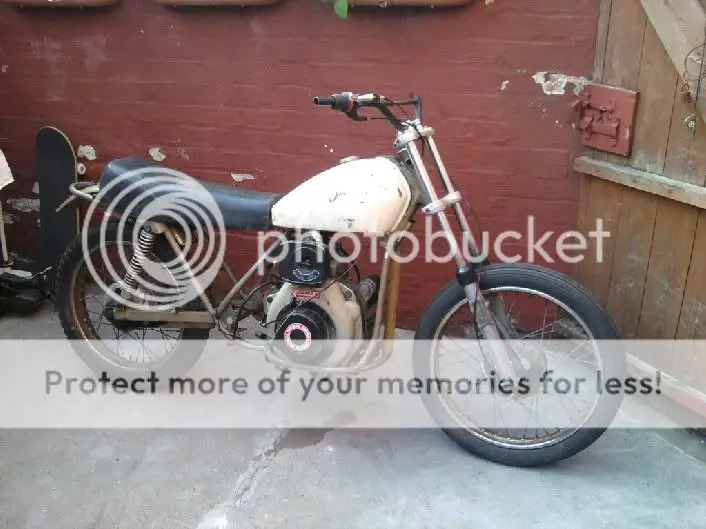

Gearnut its a 300cc single cylinder yanmar, its fitted in ok but because I'm using a torque converter as transmision I've had to chop out and replace the front of the frame to fit it properly, It looks like what it is, a generator engine so in a vain attempt to change it a bit, I think I'll fabricate a ram air scoop to draw you eye away from the uglyness of it, look see....

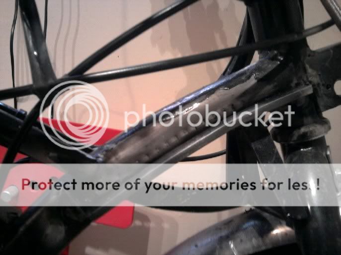

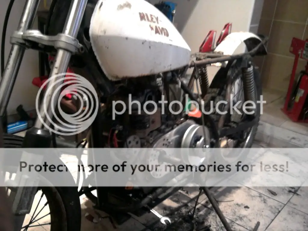

I today done a couple of little jobs I've been meaning to do for a while, all legal stuff I'm afraid, I rivited on the VIN number and also stamped it onto the frame, I had to weld on a straight edge first so the stamps went on nice and straight.

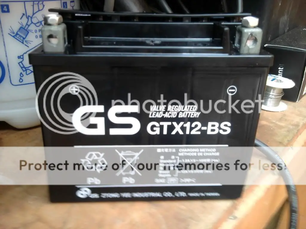

Bought a nice big 10ah sealed battery which should help him drive through the night, this buisness of not being able to charge it up is starting to grate though, I'll have to give it some thought but my initial idea is to combine the chain tentioner with a small altinator/dynamo, as soon as I remember where I left my thinking cap I'll get on with that

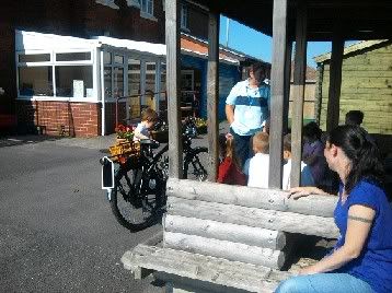

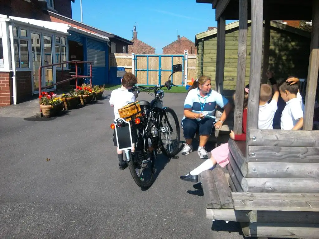

My boy Archie had a real good day today presenting his bike at the schools show and tell, he rememberd where all the controls where, horn, indicators, horn, headlights, taillight, horn, brakes, horn ect it infact brought the whole school to a standstill at one point, and at least for 15 minutes he was the coolest kid in school, (but I did feel sorry for the kid who brought sea shells in lol, it just wasnt the same.shft.
Oh how cool is that!?
He is gonna be telling that story when he is an old man.
Bummer about the kid with the sea shells.
(Ya could'a kept that part to your self! snork)

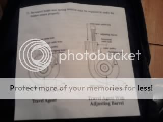

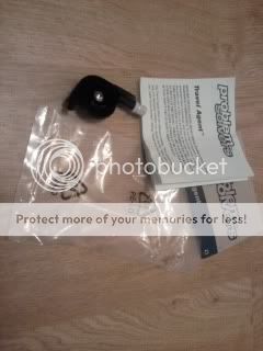

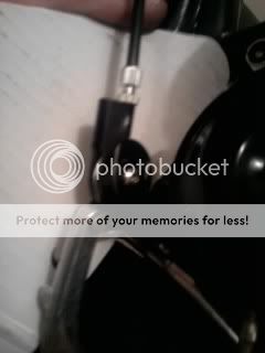

I had a bit of a problem with the back brake earlier in the build which I sidelined till I could think about it more, the problem was the original V brake works in conjunction with dedicated levers and just changing them for bigger levers makes them worse, the brake did sort of work but was very spongy and could be pulled all the way back to the bar, the answer was a gadget called a 'Travel agent' from a company called Problem Solvers which works by altering the leverage and to be totally frank I dont really understand how ! But I can report the fact it works really well :-) and the brake is now solid and works extreamly welldance1

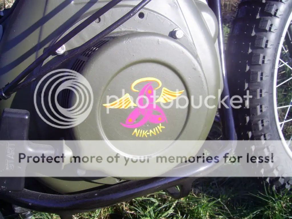

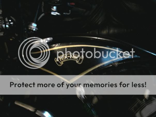

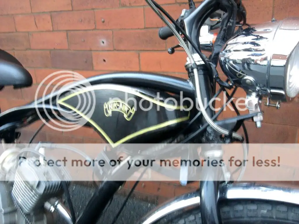

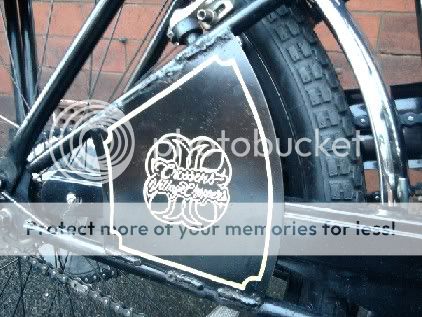

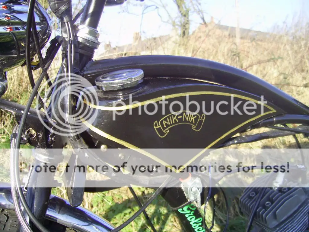

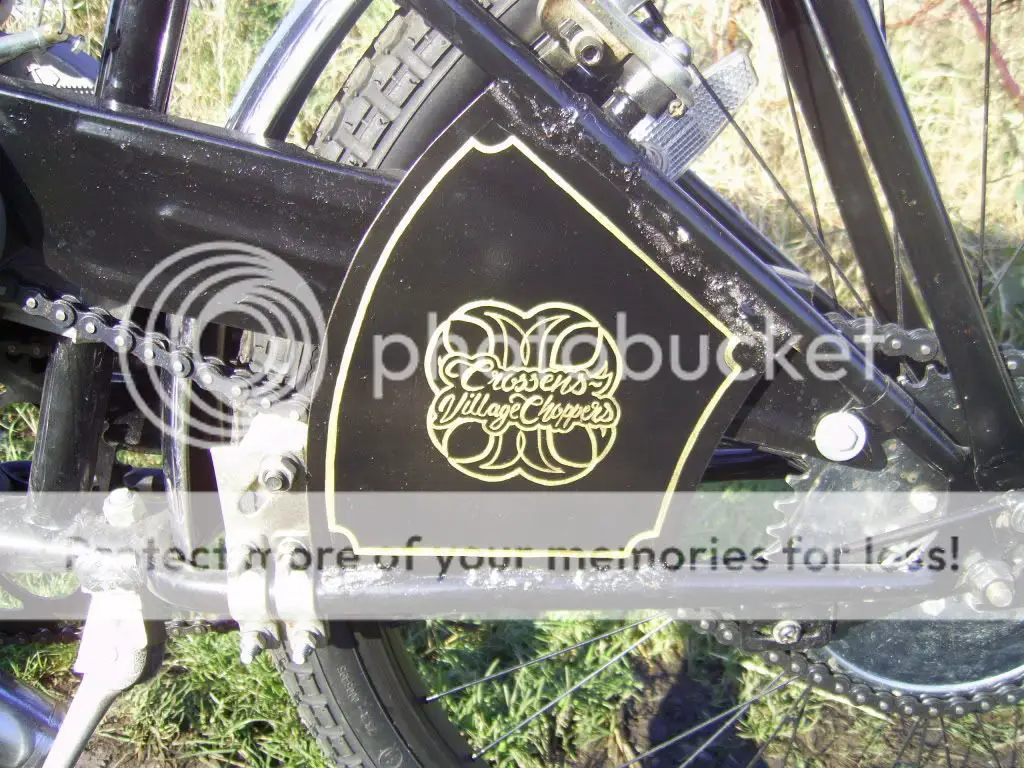

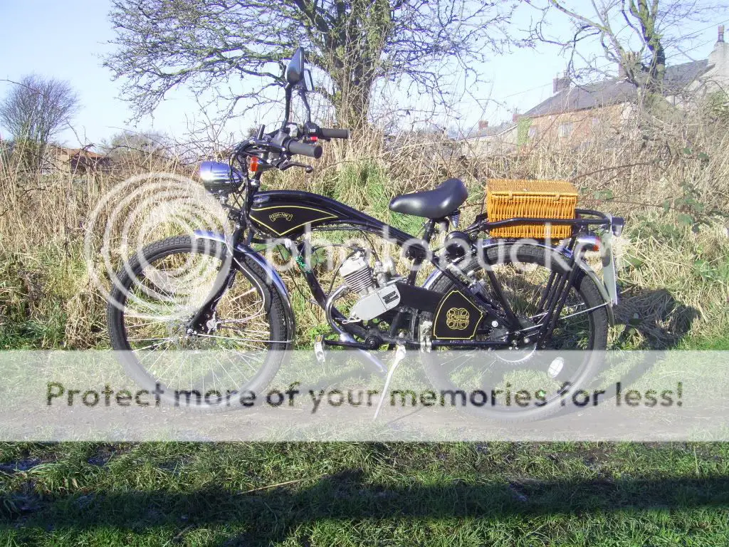

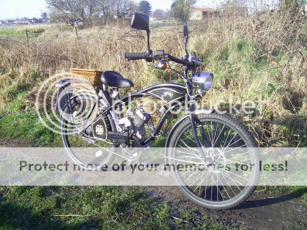

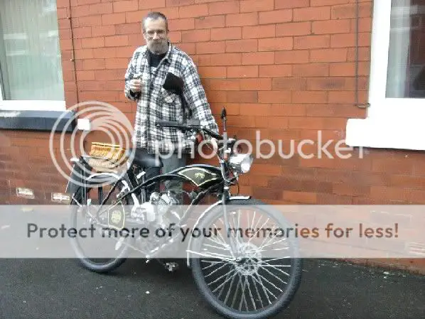

I'm still busy building the diesel bike but with the forks off to the chromers I gave Archies ped a some attention, I've had a signwrighter and painter around called [email protected] he's really very good at what he does so have no trouble recomending him here to you guys' its a bit hard to pick up but on the side panel it says 'Crossens Village Chopper' because thats where we live, and NIK-NIK was the best mate a kid could have, RIP mate we love you allways.
Johny Rat, painer / Pinstriper Probley the best artist in the world !

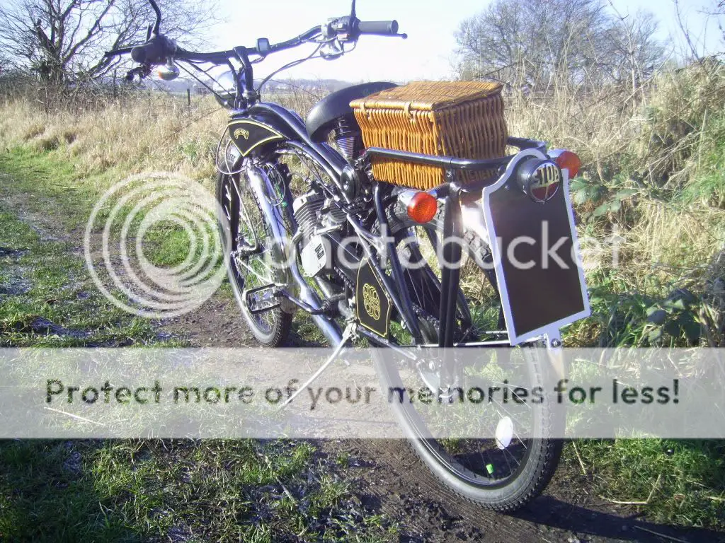

Nothing new, just took some better pics...And sure do Dan, thats also just been finished this week, I'll put a pic up, just got to get them legal now !

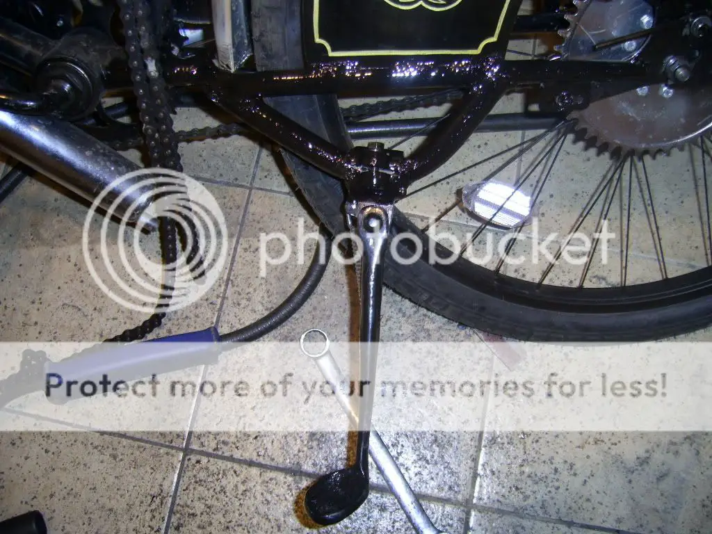

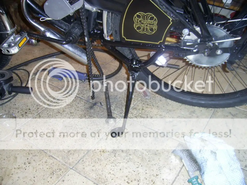

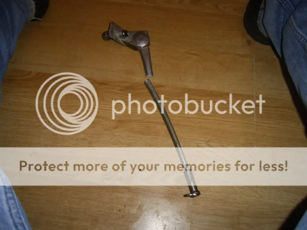

I dont know what you guys have there over the pond but I've now been through 3 side stands during the build and they have snapped or bent when the little fella was playing on it, NOW after its finished ANOTHER ones gone an snapped, there generally not so much poor quality but just not up to the extra wieght, well me bottle well an truely went after that so I've just got back from the bike shop an welded on a great big honking motorbike jobby, SOLID ! bend now ya bugger !:-||

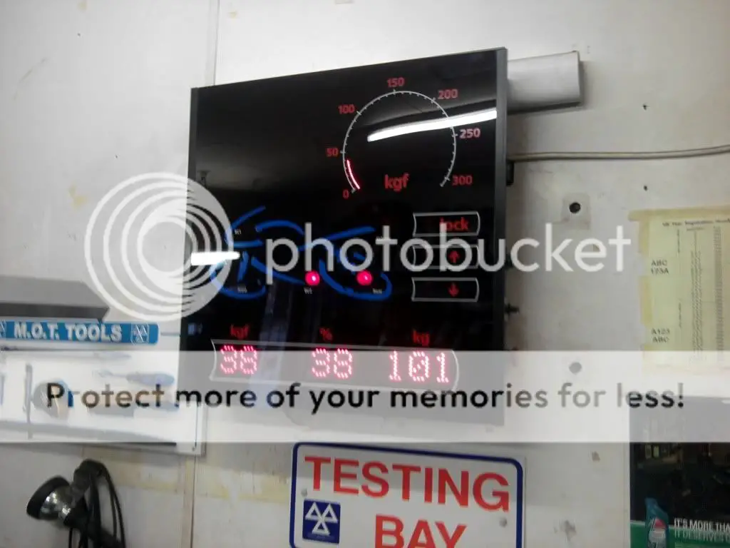

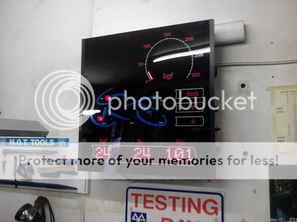

I've not had it tested officialy yet but had it down to a MOT station to see if the brakes would stand up to a proper test, the testers own words where there not just good brakes....THERE FANTASTIC !
