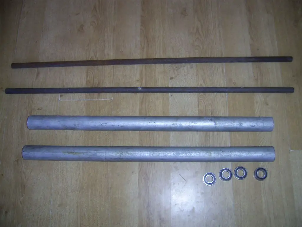

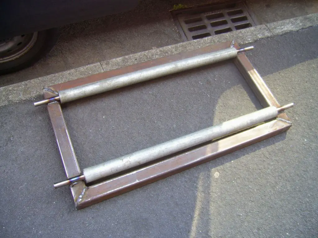

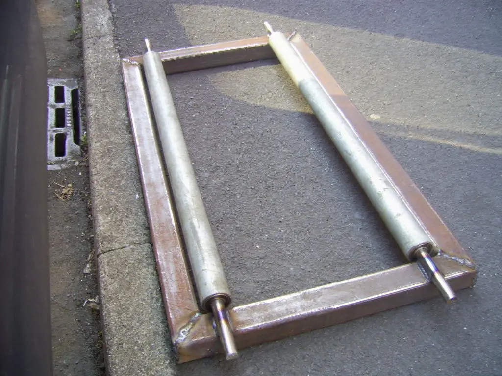

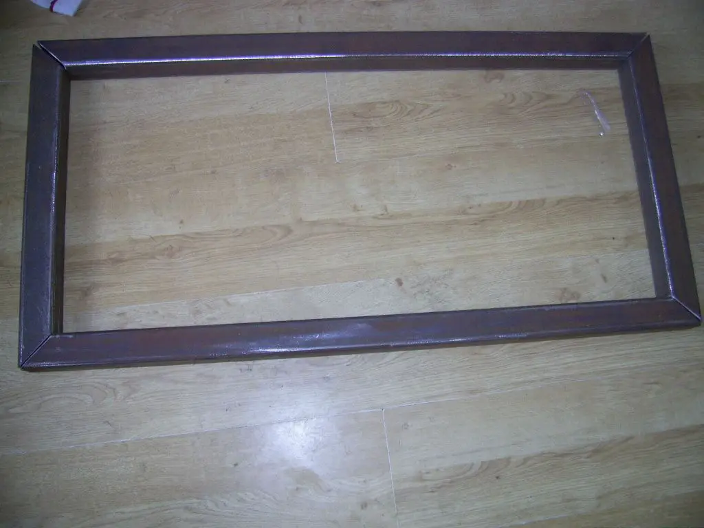

When I was at Aintree classic bike sprint last year I spied the racers using a gadget like this to get all kinds of bikes going from big twin Vincents right down to race tuned Bantams.
I did look to buy something of Ebay to do the job but the electric starters on there go for over £700. With this gadget I've made You just jack up your car and lower it on the rollers, then start the car which turns the rollers, an put your bikes back wheel on them to mechanicaly bump start it, I'd proper love it to work cos me ticker cant stand any more pedeling !
When my bad backs a little better I cant wait to try it, whats the worst that can happen ?
Scaffold bar-free
4 X wheel bearings- £28
3 metres of 50mm box section £24
2 metres of 19 mm solid bar £7.
saving my legs from pedeling all over Crossens...... £ priceless
Cheers Dan I'm sure I'll get there one day........like your sign off says, I've a warm smile, a clenched fist......me backs not to good though after fighting with this bike though lol, two out of three aint bad though...
Are there no hills where you live? No starter fluid? For all that, I'd buy another carb first, and get the upgrade.
If you finish welding that up with a 3rd roller and adjustment provisions, you'd have a might fine bicycle trainer. Maybe you can sell them as a side business.
YYYYYYEEEEEEESSSSSSSS !!!!!!!!!!!!
I've had a devil of a time getting this thing to run so I built some starting rollers ( my mechanical legs ) they worked perfectly, my mate Belinda came around on his Triumph and ran it at 7000 rpm on the rollers which is equal to about 70 MPH at one point :lol: and after half a days messing about I think I've got the carb, clutch and ignition settings just about right, I let it cool right down and it started up really easily off the pedals....I'm so bloody chuffed I cant tell ya!!!!
