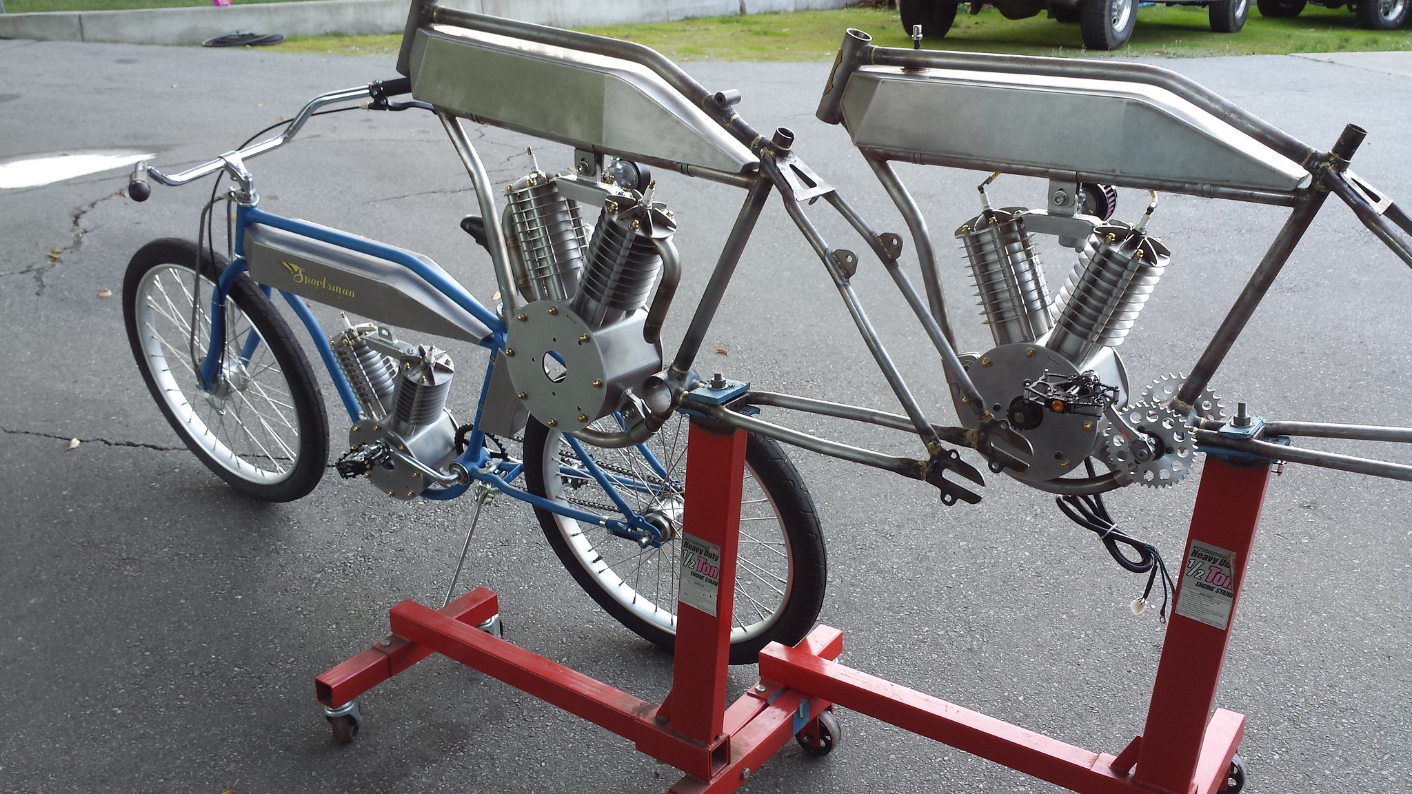

I just looked at the Harbor Freight site and a 750 pound engine stand like Sportscar Pat uses is $48. You can't get a solid bike stand any cheaper than that and it rolls around. If you have a Harbor Freight store near you this would be perfect.

Here is what I have been using for years. Modified engine build stands. Very heavy duty and portable.
Electra Flyer by Pat Dolan, on Flickr
