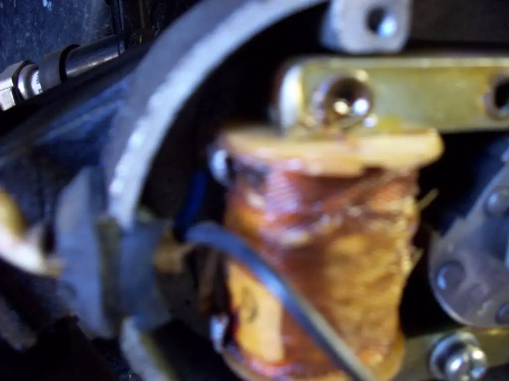

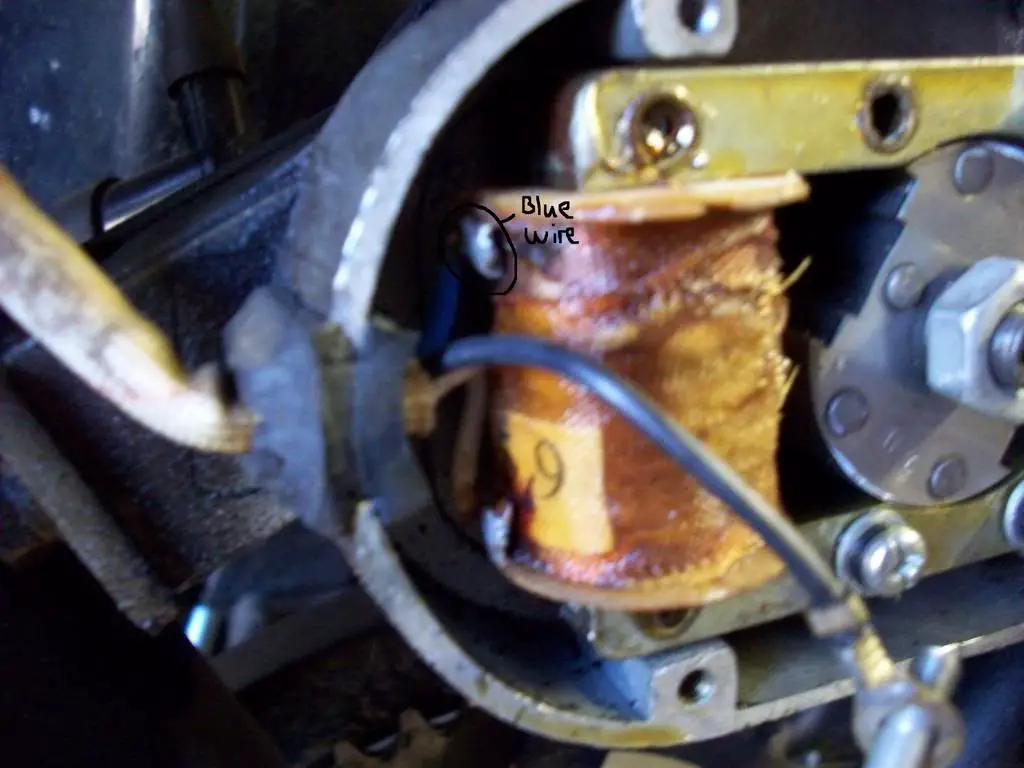

With the kill switch disconnected, I checked for spark: No spark at the plug, the CDI, or even the blue wire. I did get power from the white wire though. I opened the casing to check out the magneto and check connections, and found out the blue wire was no longer soldered onto the magneto. I figured that was the problem, so I soldered it back onto where I thought it went, but the engine still wouldn't start afterwards. Does anyone have a picture of EXACTLY where the blue wire goes to on or around the magneto?

I think the magneto is fine - I found out that the blue wire lost connection and was kinda just hanging around near the magneto. I tried to solder it back to where I thought it went, but I am not getting spark still.
Can someone post up pictures of where the blue wire is soldered to the side of the magneto? I want to make sure I put it back in the right spot.
I hope you can see it well, I do have one out of the motor but it is at work. Hopefully I can remember to bring it home tomorrow so you can see it better.
The Blue wire goes on the top of the winding, white wire to the bottom, and black is ground

AH THANK YOU!!!!!! i soldered it onto the outside of the magneto on the steel part rather than the copper part. Hopefully this will solve my issue! I'm so excited now!
