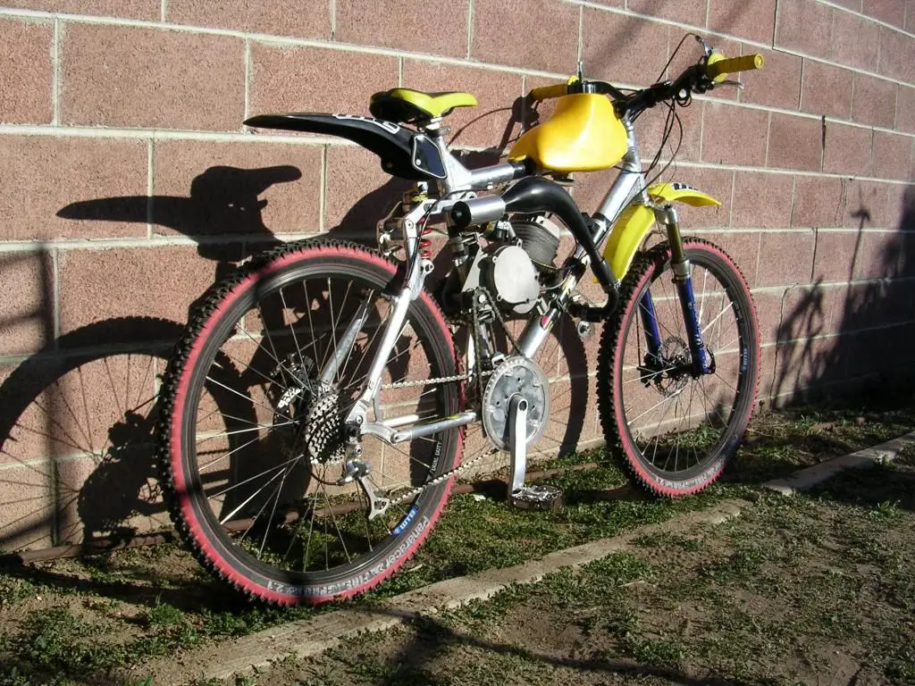

Will this full suspension bike hold a motor?
MopedLover
Hey guys, sorry about that last post without any pics, I guess a moderator got to it first and had it deleted.
Anyways here's a picture included.
I saw this mountain bike on craigslist and I'm wondering if it's possible to mount a Chinagirl without too much fabrication involved.
Thanks in advance for the advice.
Looks a bit tight,
You'd need to work out a different inlet manifold and rear engine mount then you might get a china girl to squeeze in there, but then you'd likely have chain tension issues, nice bike.

This is a thought and only a thought but could you design and manufacture a high tensile or spring loaded tensioner ,be a lot of clearances you would have to consider ,but a jack shifter kit would do the job well IMHO can you ask the seller for internal frame dimensions before you pull the trigger ,she looks a tad pricey is all
EDIT having another look at it be aware of the top swing arm on the frame ( top suspension arm ) it looks fairly tight and there's no clearance whatsoever for a chain to run through so the only option you would have is to fit a shifter kit to it ,and be aware of frame flex , I heard a tale of a mate who tried to fit a motor on an atx990 giant ,managed to fit it but destroyed the frame after a few months due to rear end flex because the pull was directed on one side and the spring just couldn't take it , they aren't designed to have any side flex whatsoever and shatter like glass when put under this stress ,this was a bike built for downhill Salem as well ,so if you fit aa kit you need to adjust the suspension spring accordingly

It looks sketchy on the seat tube being s-shaped like that. I built 2 bikes using a GT LTS frame and both use a shift kit. One of them is a KTM clone and the other is a China Girl. The GT LTS may be the best choice for a motorized full suspension bike. If you keep an eye on Ebay and Craigs List you can find them at a fair price, I found one for $175. They also made one version with an s-shaped seat post that wont work, look for the ones with a straight seat post. They were also available in aluminum or cromoly, my KTM is Cromo and I like it more but the alum is fine. You will need the 19" frame size at least for enuff room to fit the engine, both mine are the large 21".

Thanks for all your input everyone. I guess I won't buy it.
