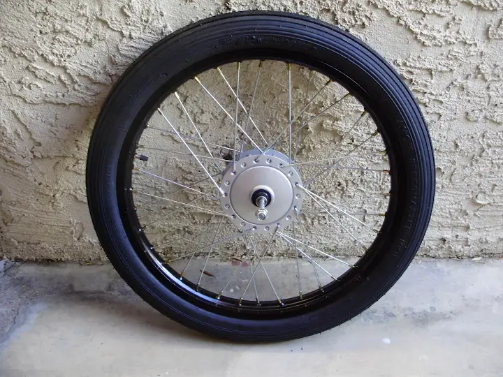

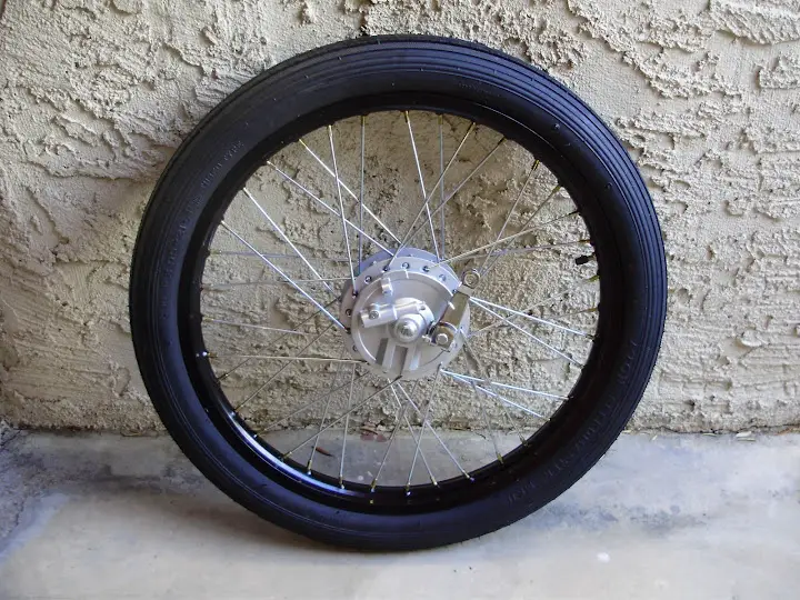

Scott @ Silver State has some nice 21" DOT wheels with brakes in stock, I picked up a pair for a project:
Mounted a set of Avon Speedmaster 3.00 x 21 tires. Should have a nice ride.
Would make a good wheel on a velocar with an 80/90-21 tire mounted. Good sized brake, 9 gauge spokes, aluminum rim.

Yes Zoran i think the second rim like that would add strength.The first 2 pictures ..........Curt

FFV8 Yes they are nice and would make a good wheel for volocar.
Also was looking at west coast chopper wheels today and they have a really wide hub that would make a good hub for the taller wheels...............Curt
Those look like really nice wheels... and 9 gauge spokes... wow!
