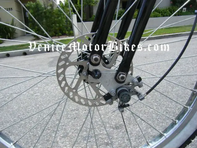

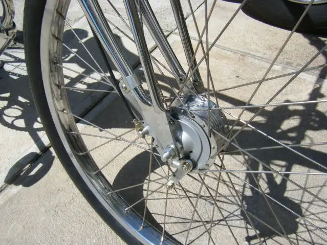

    Nice!! Here's the drum I just did...
    I also laced all the disc brakes on my website.
    [​IMG]
    [​IMG]
