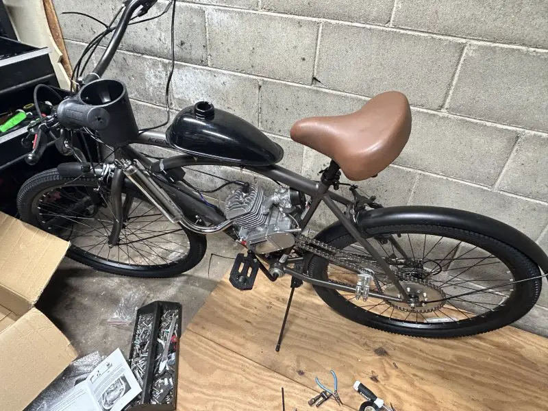

So I have a Kent Bayside cruiser bike, the kit sprocket is crap do I am wanting to get a hub adapter, I used a string to measure round it and it gave me 3 1/2 inches, how do you convert this to diameter of the hub snd which adapter would mine use. Thanks for any help
Post a picture of it
I meant, post a picture of the hub!! *face palm*
luckily, I can see that you have a multi-speed bike.... so that means you're gonna have to buy a cheap caliper & measure the hub to figure out what sprocket adapter will fit.
If my memory is correct; those wheels have 40 spokes (& you need a wheel with 36 spokes for that sprocket to bolt onto nicely.
Also... that exhaust pipe aimed upward is a real bad idea!!!
