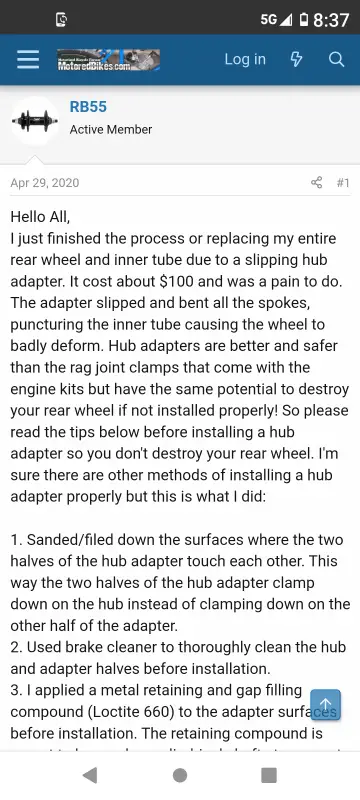

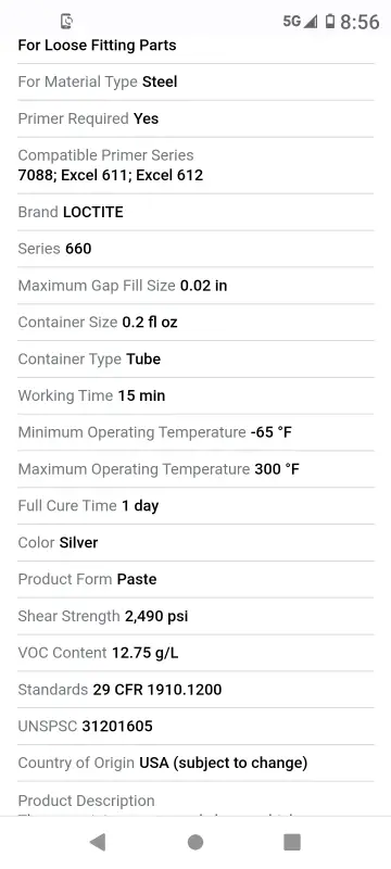

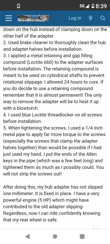

Whatever size adapter fits lock it down with 660... You can also put set screws (3) to bind it down also... But you only have 10 minutes to get everything together and give it 24-48 hours to completely cure... Blue lock tight on the threads and a torch takes it off

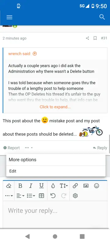

This post about the :) mistake post and my post about these posts should be deleted... laff
