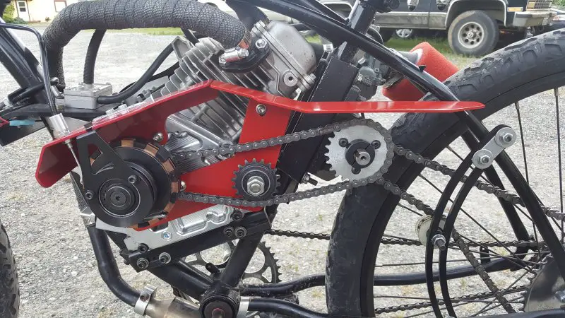

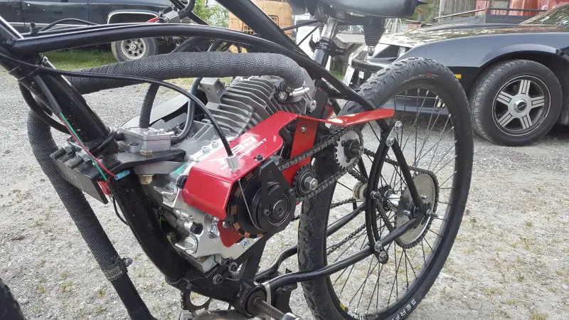

I installed my new 3d motorsport clutch and chain tensioner guard i made. Had to re gear it back to 11.11.1 where I originally had it. Its still hard to get going without stalling so I don't know if I'm going to keep this on. It really opens up the power on this engine though. Its a very nice product. I'll give it a week and see if it grows on me otherwise I'll put it up for sale

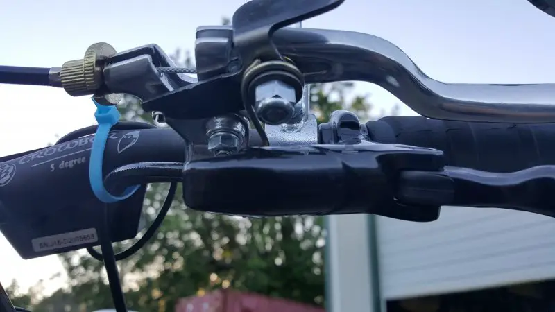

I modified the clutch handle to be spring actuated. Much more user friendly than how it cameView attachment 94957
