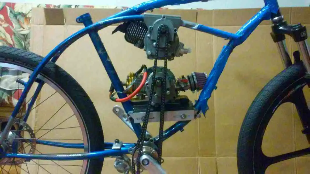

I've been working on my new project MB for the past couple of months.
I'll post pics and share more.
I was installing a Tanaka 47R, ala mid-frame and shift kit.
This morning, the Tanaka is out, making room for TWO pocket bike engines!!
Mid-frame twins with shift kit!.weld

Necromancer, to each his own.
These are new old stock 47-49cc pocket bike engines I had laying around for 10 years.
I bought the prettier one on Ebay. It was a custom engine someone built, but never ran. It has an adjustable carb I like. I ran it for a few miles, then it quit. I think it's the spark.
I could chain each engine a straight shot to the bottom bracket(BB).
The first engine sprocket, one chain to the BB sprocket. Done!
The second engine sprocket, another chain to its own BB sprocket. Done!
The freewheel on the pedal arm links both BB sprockets. One chain ring sprocket links to the 8-speed cassette. Done!
If I'm lucky, the chains and sprockets will be spaced 20mm from each other, and line up behind a single chain guard.
Right now, I'm using a 203mm(8") sealed bottom bracket. I hope I don't need a wider one. The next step up is a 330mm(13"!) unsealed unit.
I guess I could trim it down to 10" or so.
One extra hand grip throttle on the handlebar.
Orrr, I could run a jackshaft. Both engine chains converge there. Then a single chain runs to the BB.
The problem is that pocket bike engine sprockets are T8F chain-style. They have 6-spline pinion shafts. T8F sprockets are small, especially the tiny 11t drive sprocket. The #25 sprockets are teeny-weeny. However, they get the job done. If not, the pocket bike industry would've swapped out to bigger chains and gears.
I could not find T8F sprockets that slip onto any conventional 1/2" or 3/4" shafts.
And I don't feel like having a 6-spline 13mm shaft fabricated.
I think I need to create a new thread in DIY section on this.

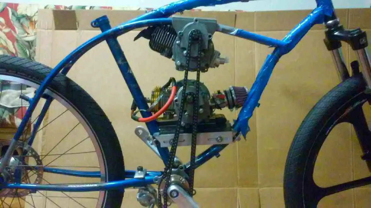

https://motoredbikes.com/attachments/04-22-bicycles2-png.76418/
Purty cool, 5-7! Got that funky Frankenstein, Rube Goldberg sort of look.
Trying to imagine what the sound is gonna be like? Ya gotta post a vid.
