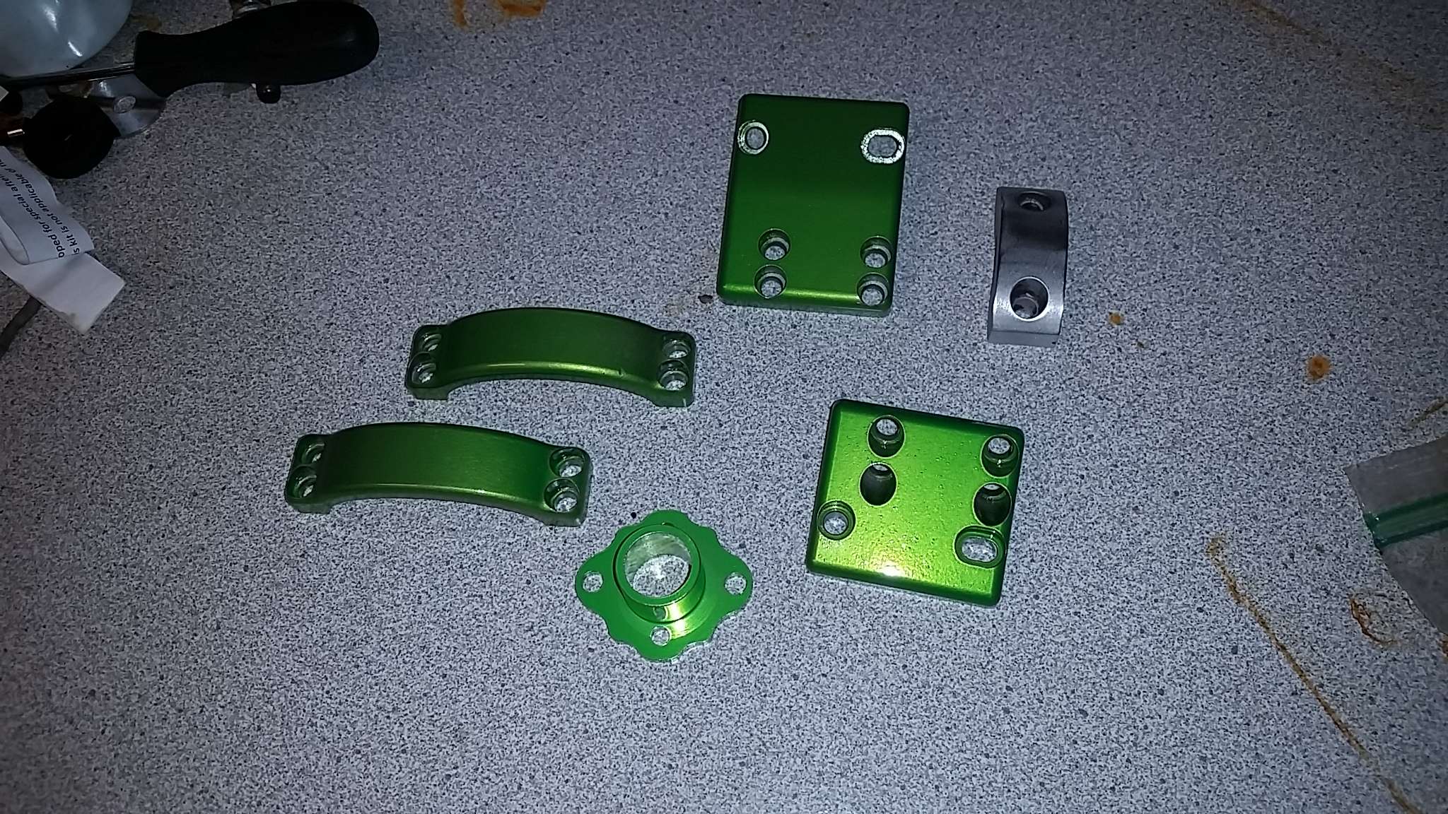

More powder coating done today... I wasn't happy with the first batch so I contacted the guy I got the powder from and he replied quickly and told me what went wrong and how to fix it...
After this I went back and re cured the parts for about 15 minutes longer.. this worked and saved me from having to redo all but one of the parts cured in that batch...
Afterwards I had some time today to experiment so I practiced the methods the seller told me and here you can see how much control of the color you have by adding more or less coats of candy pretty much the same as painting except the parts are heated up to about 150 to 200 degrees so the powder sticks better but don't melt on the part during application... then back into the oven for more baking...

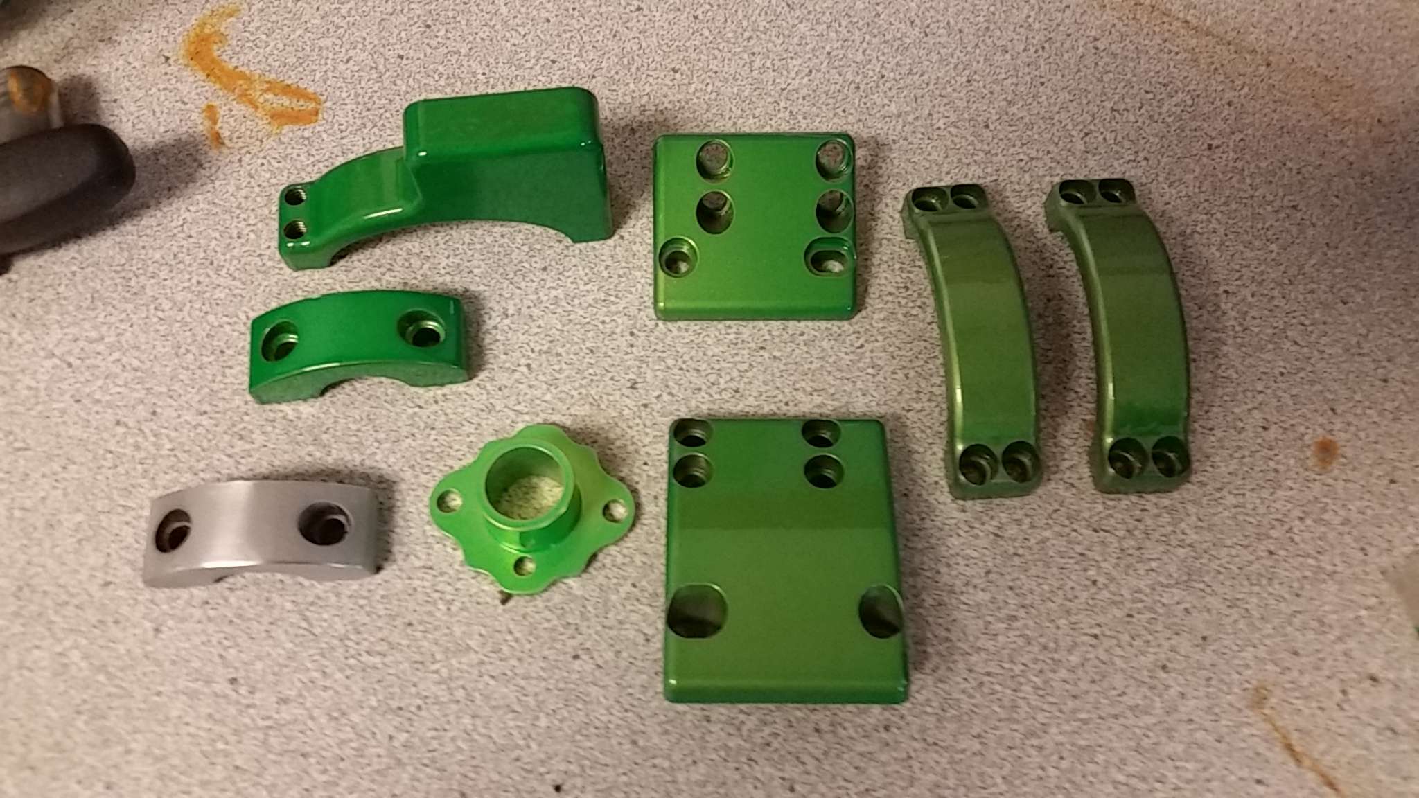

Here are the parts in candy lime green on top of the krome base coat... I really like the color but may add some lime yellow or gold pearl into the clear coat for just a bit more pop...
This one is with the flash off to show the true color best...
And flash on to show how it will look out in sunlight...
The different colors are all done with the same batch of green powder and is controlled by how the base is applied and the number of color coats... the lightest green is just a single coat and the darkest is 2 coats with the second coat applied while the part is still hot...
