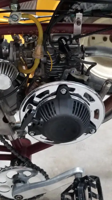

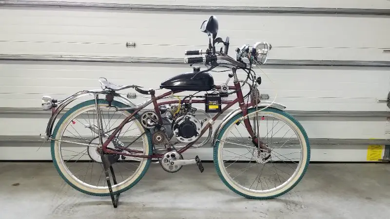

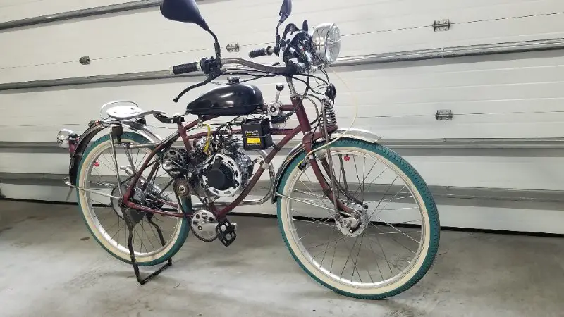

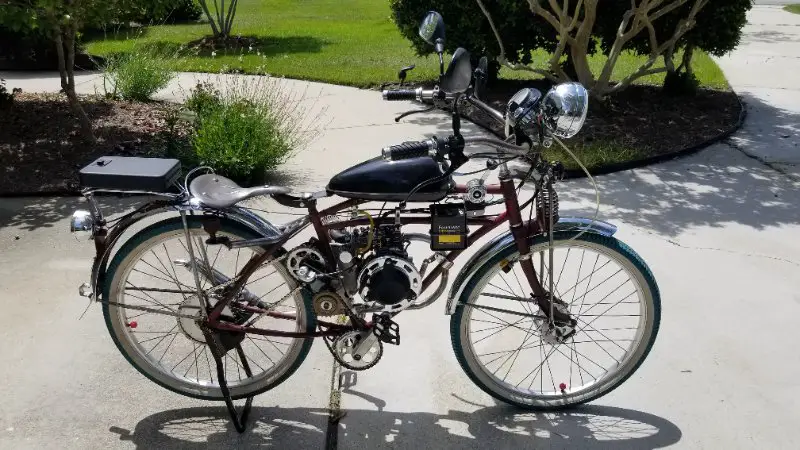

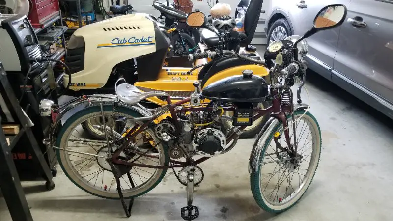

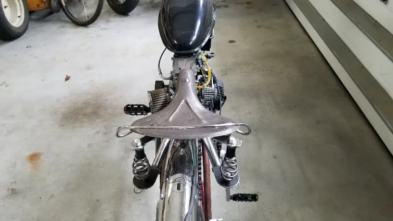

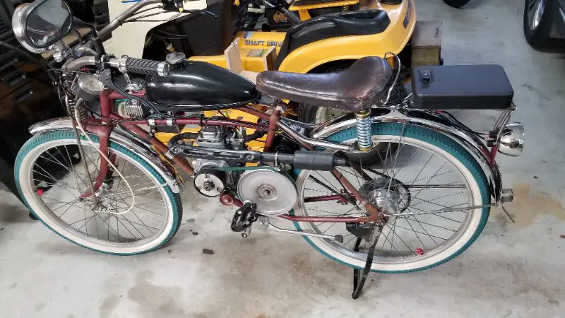

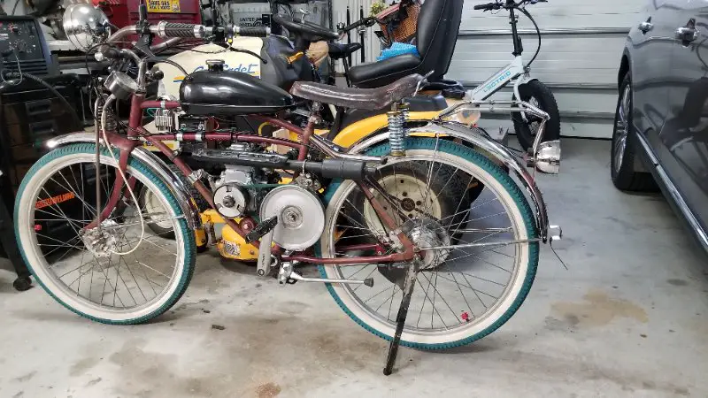

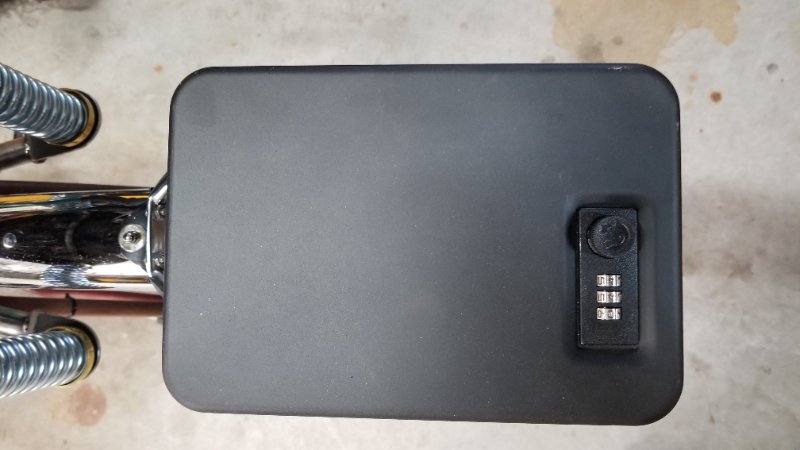

Meaning to delete this, was seeing what you wrote on page 3 "Decided to fabricate a complete springer seat carriage instead of going with a rearward seat post."What do you do with two useless spring book racks? You cut them in half to make a Tool Box rack. Picked up a heavy duty security box, probably made for storing documents or firearms, thinking it would make a great lockable tool box. It's made of heavy steel with a combination lock and heavy foam padding-perfect for storing tools and other essentials in case of a breakdown. The front of the tubular rack is bolted to the fender and the rear supports are bolted to the tail light mount. If I can find a small luggage rack just big enough for a six pack, I'll bolt it to the lid for added convenience. I think my practicality is beginning to clash with the appearance of the bike, but at this stage it's not gonna win points for appearance no matter what I do! The box is upside down in photos 2 and 3. It actually opens from the rear and swings toward the seat.

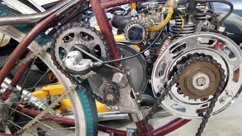

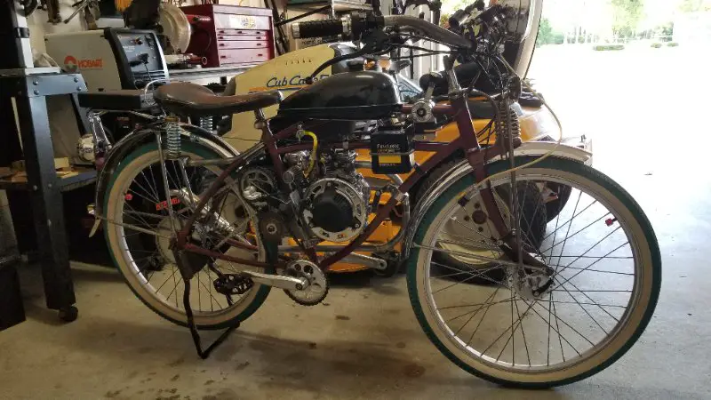

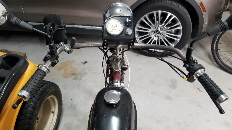

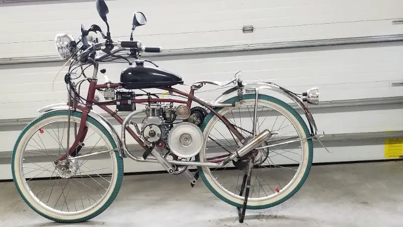

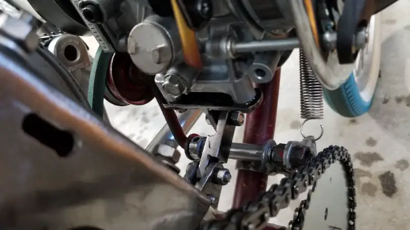

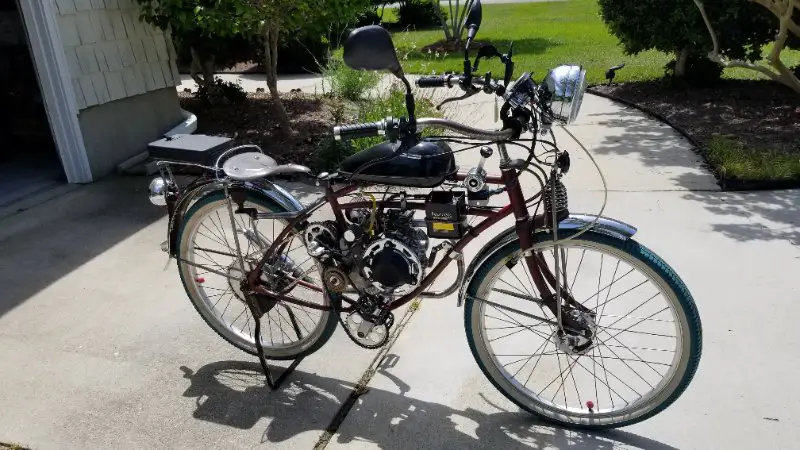

View attachment 117235Got my foot caught on my tool box while dismounting this morning. Decided to yank it off and was shocked by its weight. Wasn't too keen on its looks, gave the bike a scooter vibe! Now I need to replace the modern mirrors with some vintage ones. Donated some old Harley mirrors, wish I had them back. Oh yeh, the 415 drive chain was crowding the one coming from the jackshaft, so I swapped it out for a KMC bicycle chain. Had to add a half link to make it fit even with the axle slots, but it runs straight and smooth. Still not sure about the looks of the Higgins set pan. Might go back to ole softy.

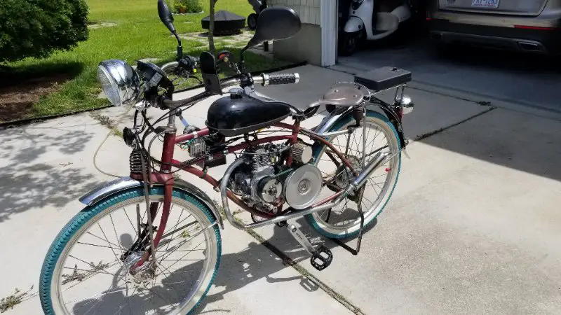

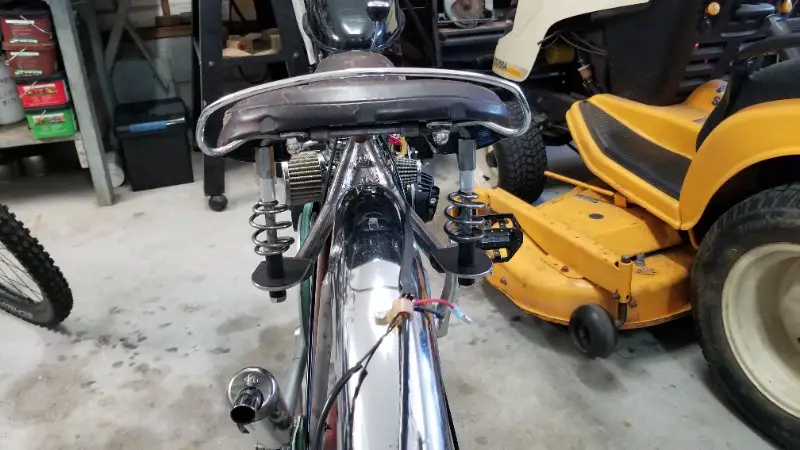

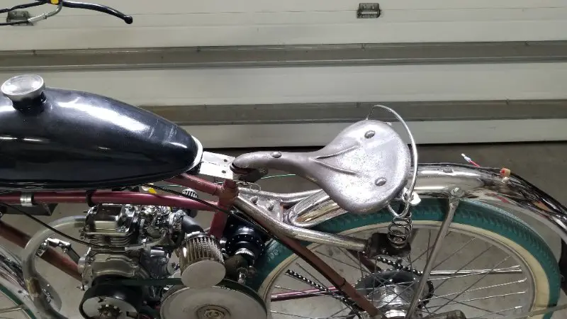

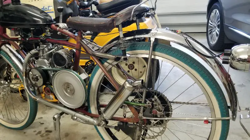

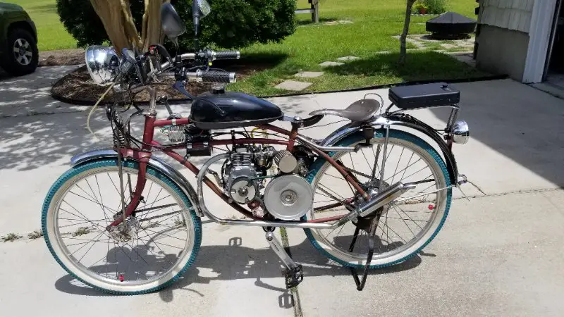

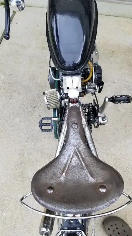

Hi MT. Yes, a t-shaped stud with a pivot hole is bolted to the seat pan. The stud sits in a slot in the original seat post where a corresponding hole holds a 1/4 pin that serves as a pivot. The rear springs are what we call porch swing springs in the south. They are sold in hardware stores and box stores like Lowes and Home depot. They are the correct tension for springer front ends as well as springer seats. The keepers are Dorman brass freeze plugs with a hole drilled in the center for a 5/16 bolt that holds everything in place. The support for the springs was made from heavy pipe handlebars off an old Sears rototiller. I cut them in half up front so they cradle the frame, then welded a plate between them. I did the same to the other half of the pipes and drilled holes in both plates to clamp onto the frame. The original angle of the pipe was perfect, sometimes things turn out that way. Other times require some concerted heating and bending. Fabricating parts like this takes a lot of trial and error, bunches of patience, and tons of cutting and grinding. I wouldn't try it without a welder, an angle grinder, and bench grinder. A set of good files helps with finishing.

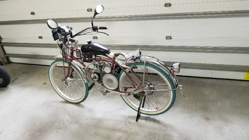

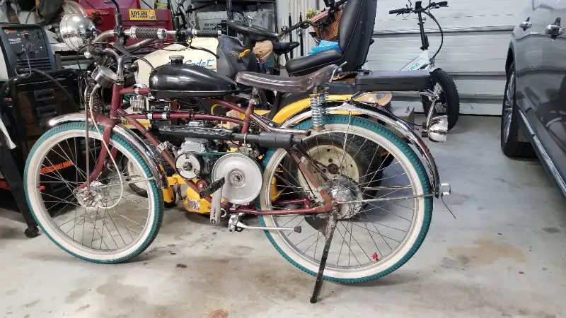

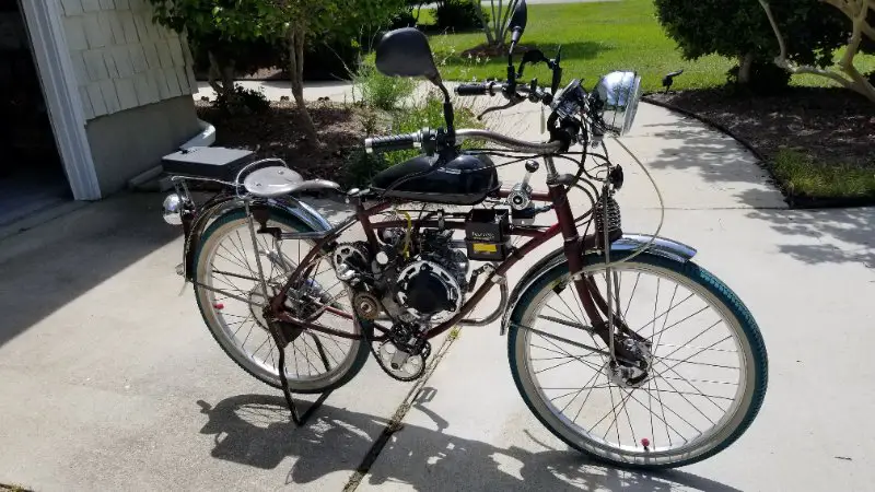

I appreciate your interest and hope this answers your questions. All of this is pretty much moot because I went for a ride this afternoon and decided I needed a lower center of gravity for better handling. The setup for the seat makes it easy to swap out options, so I reverted to the original J.C. Higgins seat pan and springs which lowered my seating a good 2 or 3 inches. It could go another inch lower by removing he spacers beneath the springs. As you can see from the photos, I kept everything the same except the front mount which I fabricated from another bicycle seat frame. It pivots on the bolt normally used to tighten the seat post. In place of a post, I inserted and oversized aluminum stove bolt to serve as a plug. Wifey said the new seat looks uncomfortable, but it's not. It's actually very cushy despite the funky squeaking sounds it makes when you hit a bump! The beauty is, I can switch back to the other seat in about 15 minutes.

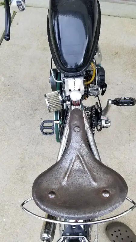

I was looking at the last picture, that shows on the left side near the engine, what looks like an airfilter to the carb intake.Hi MT. Yes, a t-shaped stud with a pivot hole is bolted to the seat pan. The stud sits in a slot in the original seat post where a corresponding hole holds a 1/4 pin that serves as a pivot. The rear springs are what we call porch swing springs in the south. They are sold in hardware stores and box stores like Lowes and Home depot. They are the correct tension for springer front ends as well as springer seats. The keepers are Dorman brass freeze plugs with a hole drilled in the center for a 5/16 bolt that holds everything in place. The support for the springs was made from heavy pipe handlebars off an old Sears rototiller. I cut them in half up front so they cradle the frame, then welded a plate between them. I did the same to the other half of the pipes and drilled holes in both plates to clamp onto the frame. The original angle of the pipe was perfect, sometimes things turn out that way. Other times require some concerted heating and bending. Fabricating parts like this takes a lot of trial and error, bunches of patience, and tons of cutting and grinding. I wouldn't try it without a welder, an angle grinder, and bench grinder. A set of good files helps with finishing.
