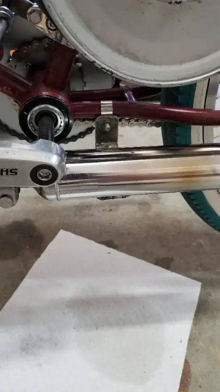

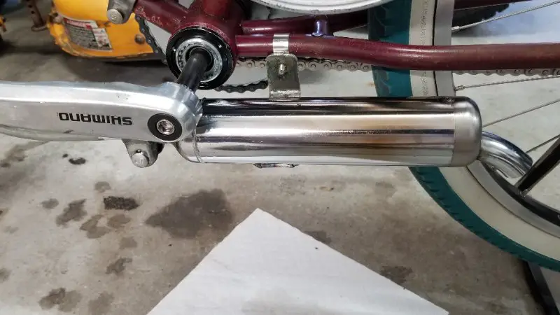

Finally got my muffler bracket fabricated and installed. It's a piece of scrap metal with a 1/4" threaded hole for mounting to a frame clamp. One end wraps under the muffler body and is spot-welded. The slip-on feature of the muffler allows removal by loosening a clamp and removing the bracket bolt.

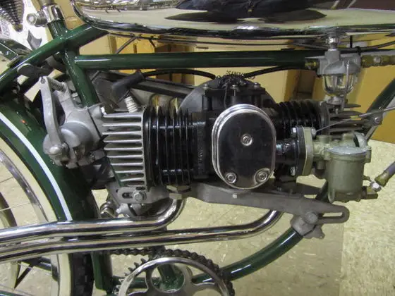

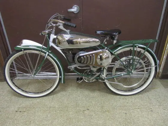

I forgot to mention the rod was solid Bronze, crazy. Mine was a later model because of all the crome. Here is what mine looked like, don't recall the big headlight.
Mine also had the twin spring fork

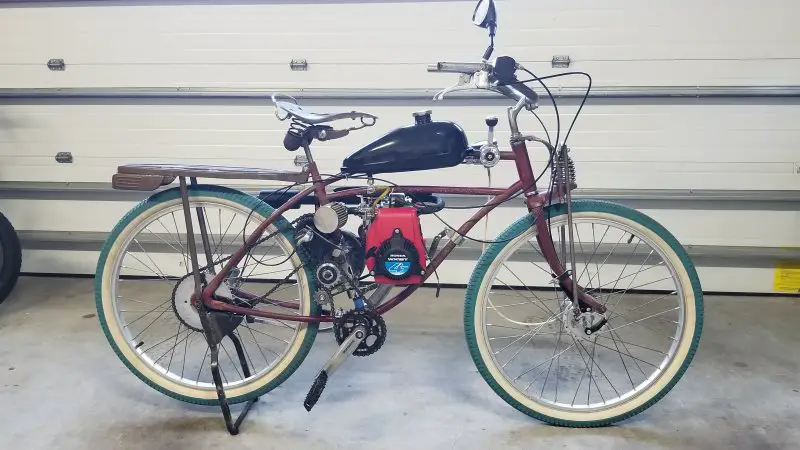

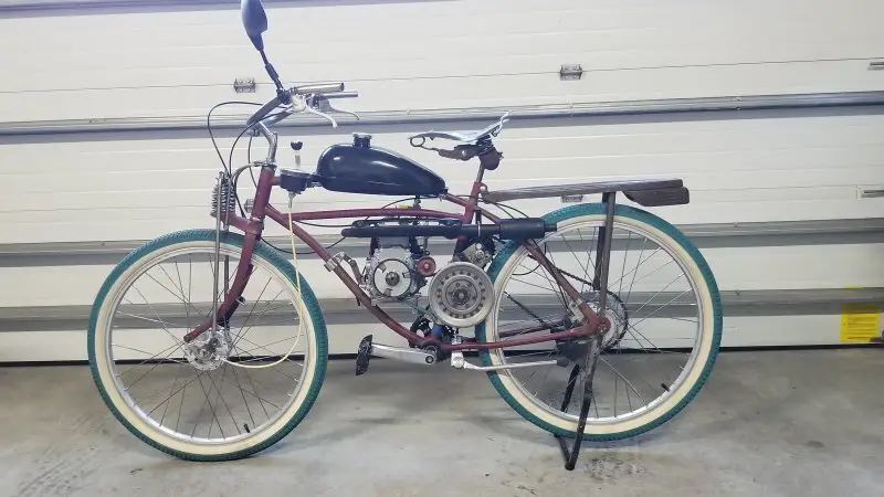

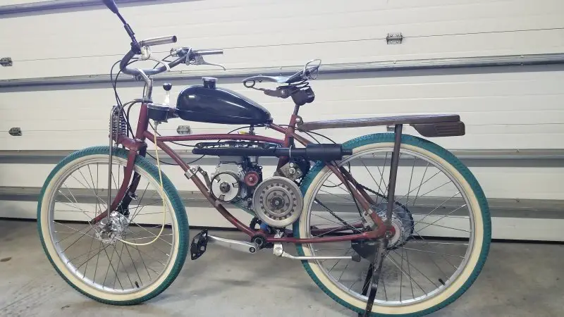

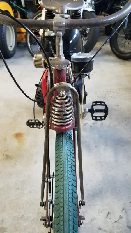

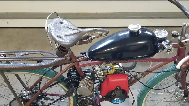

Was tempted to hang it up after my disastrous tandem build. Then a 1950 JC Higgins Beehive Springer caught my eye and the ole flame was rekindled. Was instantly bit by the nostalgia bug and swept back to my first Whizzer which had a springer front end and drum brakes. I loved how fluid the bike behaved on the bumpiest roads. This bike spent most of its life sitting under a tree enduring the elements. There was plenty of rust to be removed, but from the condition of the components suggest she wasn't ridden much. The pivots for the springer front end were still tight and all of the bearings were good, Most important, the bike was complete and unmolested.

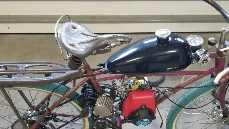

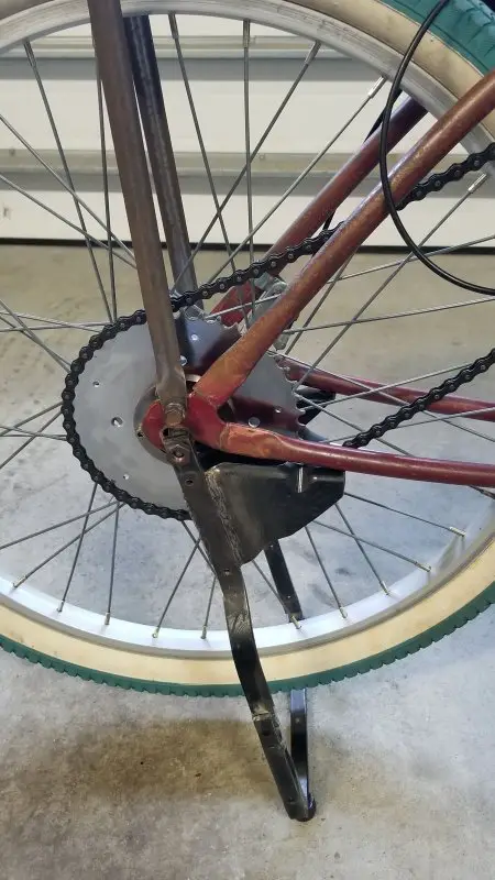

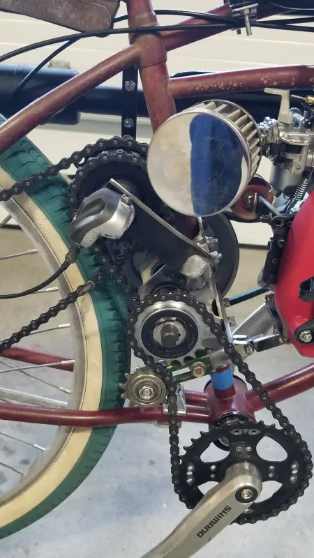

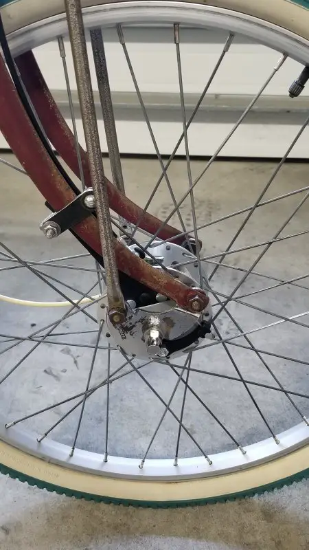

I steel-wooled all of the rust before swapping out the rusted steel wheels for fine Arayas laced to drum brakes with 11 gauge spokes front and aft. A Sturmey Archer X-FD (90mm) front drum drives the speedometer gear. The gear cassette on the vintage Schwinn rear hub was replaced with an adapter that accommodates a 44-tooth sprocket. The SBP jackshaft was modified to house a Shimano silent clutch 3-speed hub to serve as a tranny using a belt primary drive. A Shimano single speed freewheel allows the jackshaft to turn without driving the pedals. A 3-speed suicide shifter is attached to the crossbar in front of the extended fuel tank.

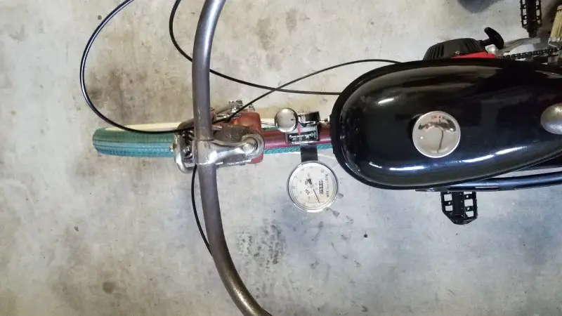

The deteriorated padding was removed from the springer seat leaving a bare pan which looks vintage and works perfectly. Vintage brake levers preserve the vintage look of the original swept back handlebars. A throttle control from an ATV is currently in place, but might be replaced with a vintage moped twist throttle. The vintage speedometer is a good complement to the suicide shifter.
Still have to mount the fenders and lights before testing for proper gearing. Have mixed feelings bout painting the frame and seat since I like the rusty patina.

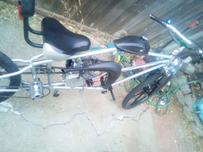

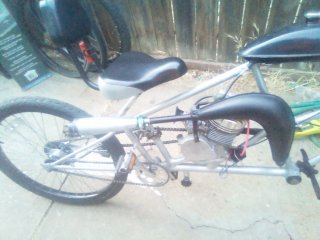

What was so disaster about your tandem build because I just did one here recently I didn't have any problems other than cut a little here weld a little there you know but what was the problem? Maybe I can shine a little light on your situation. Sweet bike by the way.

Good job, Weevil. Was excited about my tandem build in the beginning, but as it progressed it became way too heavy and the turn radius made it a bear to handle. My custom springer fork was part of the problem as it was so heavy. Plus, I wasn't in the best frame of mind at the time. Maybe with a little more patience and persistence I could have made it work. When the Higgins bike came along it captured my attention and the tandem ended up in a corner waiting for some inspiration! Wish I could pass it on to you to see what you could do with it.
