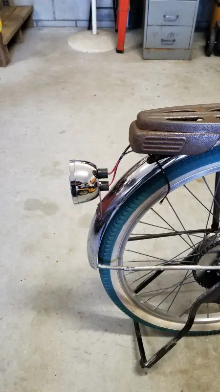

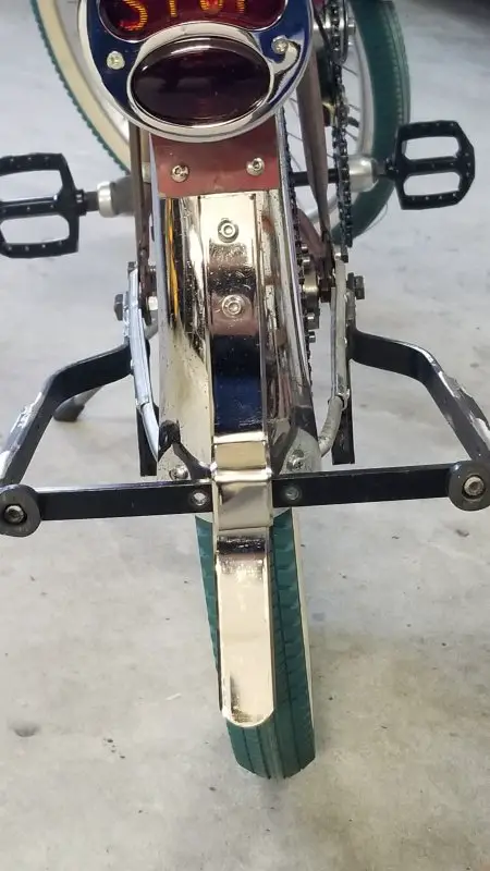

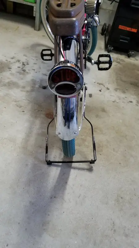

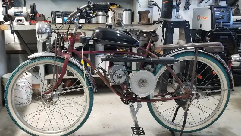

Tail/Brake light mounted, controls added to handlebar, and rear fender beefed up with an aluminum rib down center and bolted to frame. Coming along, but still a ways to go before first ride. Need to devise springs on drop down rear stand, then finish electrics. Seems my summer project has turned into a winter one!

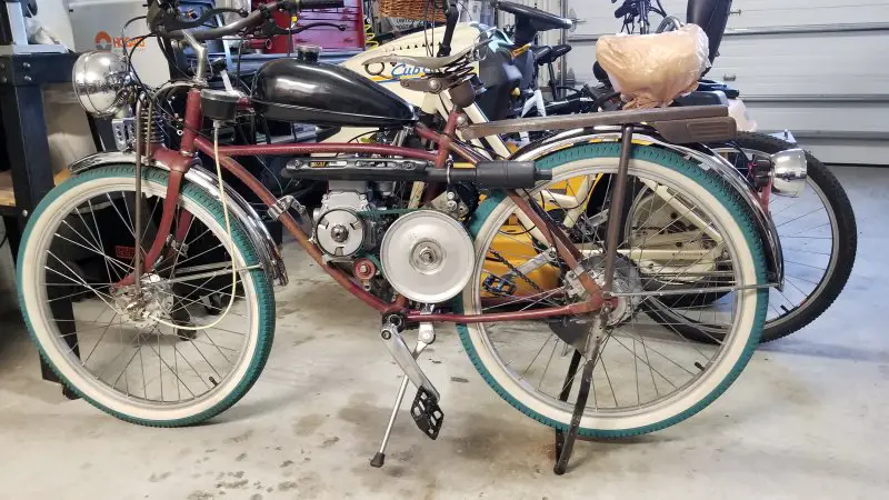

Thanks, Carbine. If you are rocking a Chinagirl with built in gear reduction it's not such an issue. But if you use a jackshaft, knowing something about ratios is a must. I threw a geared hub tranny in the mix to help the little Honda. I saw a video once of a 50cc two stroke with an 11 speed transmission that reached tremendous speeds at Bonneville Salt Flats. And back in the

Yeah I used a jackshaft on my Safti Cycle..I had a member give me some advice on ratios based on my setup..And he was pretty well spot on what worked out for me..Though I may go up to a 14T from 12T on the jackshaft drive sprocket with the 60T rear I am using..That is the nice thing about the jackshaft is you can swap stuff out real easy.

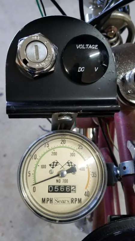

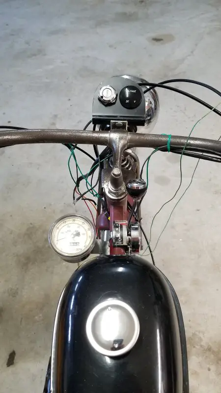

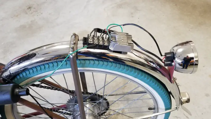

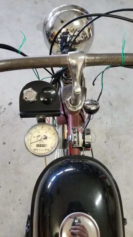

Breakthroughs today. Found the perfect mounting point for the rectifier and connecter plate for wiring under the rear luggage rack. Will make for a long wiring harness, but everything will be protected and easily accessible by removing three bolts. Was able to fabricate a dash panel for the ignition switch and voltmeter just above the speedometer using common mounting points. The panel is flat plate salvaged from a burned out battery charger. Took a bit of grinding and shaping with my Dremel tool, but it fits in a tight spot and clears everything.

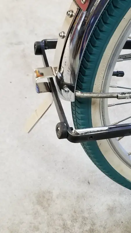

Finally, fabricated a retainer for the drop down kickstand from an over-the-door wreath hanger my wife wasn't using (with her approval, of course). With a few bends and two holes, it works like a vintage Harley or Indian spring retainer and since it was chromed for appearance, it looks good against the chromed fender. An aluminum plate behind the fender adds extra support. She's coming together, slowly but surely.

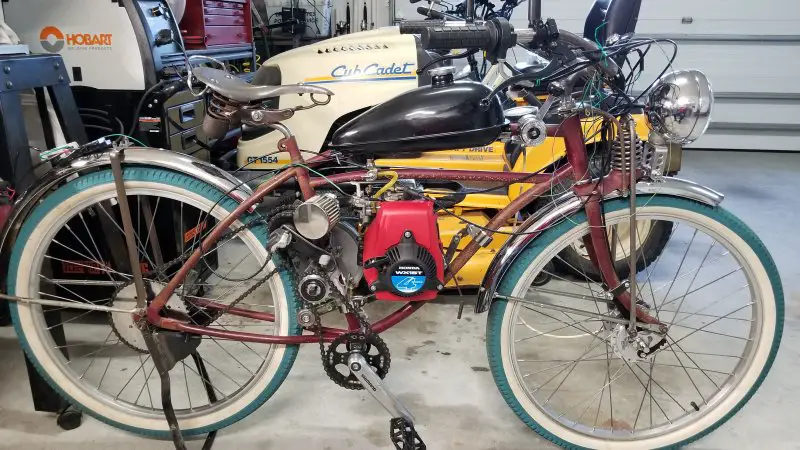

It warmed up a bit today so I ventured into the shop to work on the Wayback Machine. Since the GHX Honda sits low in the frame and is a little broad in the beam, the pedals wouldn't clear the flywheel shroud. My solution was to extend the pedal shaft. Note from the photos that the key slots were held in alignment by a long piece of keystock during welding while an angle iron jig held them perfectly straight. I welded a bead from one side of the slot to the other so I didn't have to re-cut the slot. The splice probably isn't as strong as the rest of the shaft but I don't expect that to be a problem since I won't be standing on the pedals or pedaling a lot. They are basically to keep the build legal and serve as footrests. This modification allows me to use a 5/8" keyed adapter to swap out chainring gears.

I'm with you on scrounging, Curt. I like to turn useless items into something useful. It's amazing how junk can be converted if you have an angle grinder, a welder, some files, and imagination (desperation)! Did some diddling on the wiring today. Connected the horn to the shutoff button on the throttle housing. Only thing left is wiring the brake light to the built-in brake lever switches, then wrapping everything in a split wiring sleeve. The hardest part for me is optimizing the routing and figuring the proper length before soldering the connectors in place. In the past I used crimp on connectors, but the failure rate was pretty high so now I only solder. Once you acquire a good soldering gun ( I used a cheap pencil for a long time until I found a good Weller with two step trigger on sale) and master the technique, it's nearly as easy and crimping but a whole lot more reliable. Photos of the final product soon.
