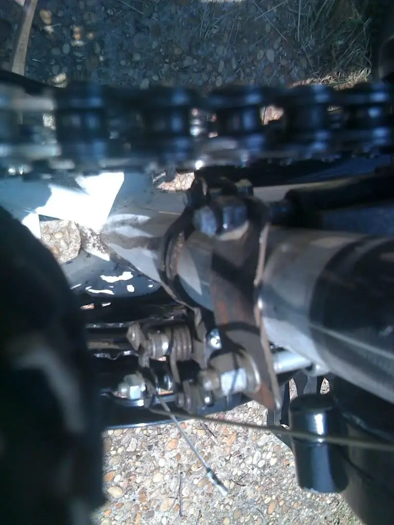

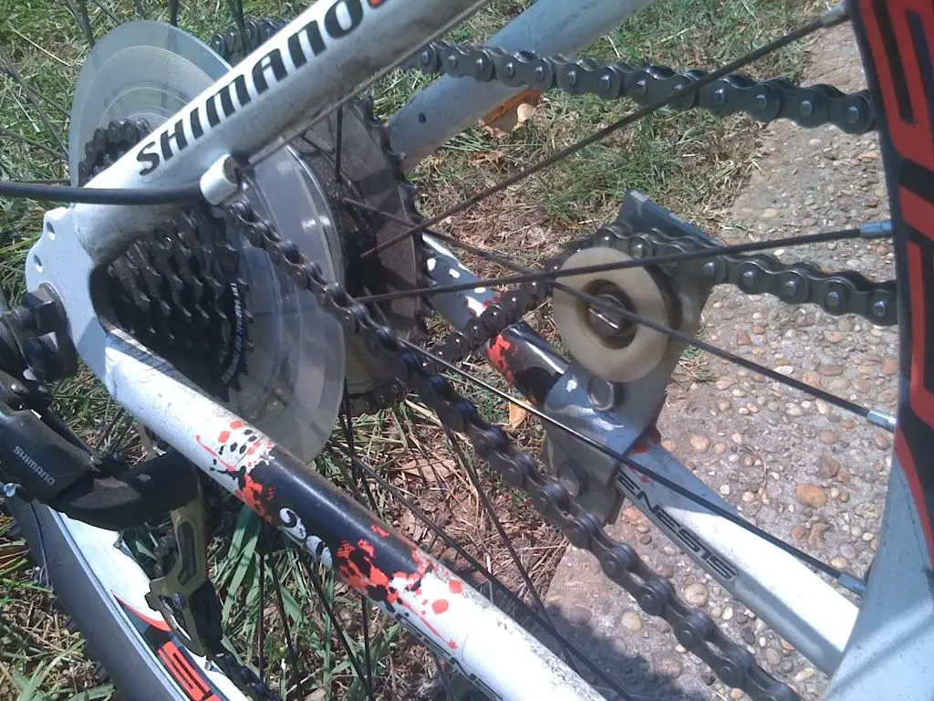

ok well i reversed the plate
chrome side facing in
seems like it got worse
the chain is now hitting the seat stay really badly
i put 5 washers in to try and fix it and it's thrown my whole bike off now ( and still hitting the frame.)
i think i am going to swap it back to how it was
i dont know what else to do
i dont think i will be able to leave the dish facing how it is
I'm curious to see what "really badly" is. You have MUCH more to worry about if your chain skips and snaps your drive sprocket, or sucks in between the driven sprocket and the spokes and kills your wheel than if you lose some paint off your seat stay.
Another thing you can do is shave down the rubber bracket 1/4- 2/3rds of the way to bring the sprocket in a bit to align it better and dodge the seat stay. Weren't you saying it hit both anyways no matter what side the tensioner is on? Just get a new tensioner and put one on top.

chain jumped off the engine again today and snapped another link
this time it tore a nice chunk of the engine away.
locked up the back tire because the jam between the front sprocket and case was so bad.

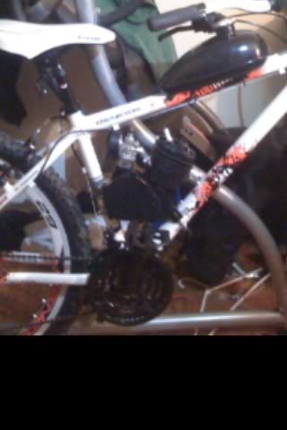

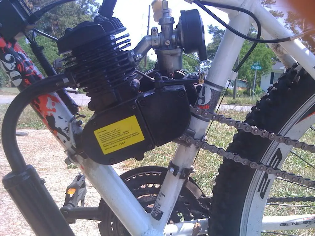

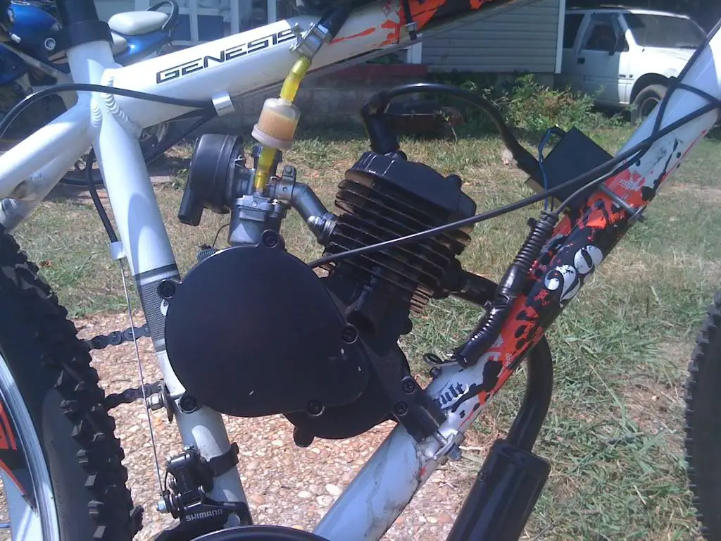

Here are some pictures of mine. I see my motor is lower than yours expecially the rear mount. I don't know if different engine kits has something to do with it. Sorry if comp crash :)
Ya my engine is the 66cc skyhawk i think?
Me & the original guy on this thread both had to make carb adapters because the carb wouldn't fit into the frame
I notice yours is bolted on properly
That tells me you have alot more clearance
and the engine is ALOT LOWER.
anyways would that be the smaller engine?
I dont know but i see your setup is looking a lot easier / less problems then mine
The smaller displacement of some engines does not make the whole engine physically smaller, only the swept volume of the cylinder. They all share the same crankcase. Some do have a larger front mount, though it still is in the same place as the small mount engines. The Super Rat does have a larger magneto housing due to the whole magneto and CDI unit being inside the cases, but the mounts are still in the same place as the other engine models.
That said, the Z80BK should be the same size as the engine you currently have.
If you have access to a rough piece of sidewalk or concrete and patience, you can grind away on the engine end of the mounting block to shorten it. This will allow the engine to sit lower in the frame. Just be sure to grind it true and square so it will not attach crookedly to the engine and stress the mounting studs.
If you have access to a belt sander, you can do it faster and more accurately too.
i might have fixed the problem although my chain is still rubbing the frame
a patch of paint is gone. dont know what im going to do if it eats the metal also
anyways i put the rear sprocket backwars again and took off alot of the washers
went on a big ride today and didnt have any chain problems so i might have fixed it
That's good you can ride it now but if you haven't I'd suggest making that rear motor mount lower or bend that chain roller some.

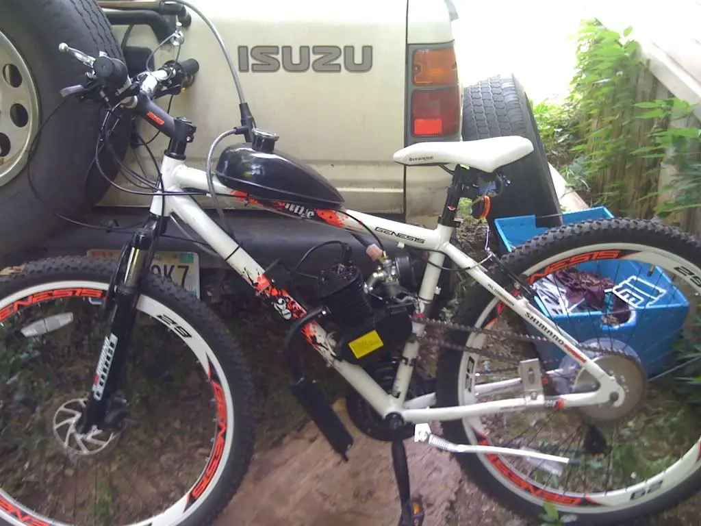

Hey there, Im happy to know that im not the first and only guy trying to put a Grubee 66cc on a Genesis two nine bike.
I will be reading through your blog constantly and am open for any tips you may have for me concerning the engine installation or any other parts of the process of motorizing this bike.

wow looking nice and i see you are in Miami FL
i wish i lived there dang nice,

I didn't have to lower the motor like other people said to do
I'll post new pictures of the finished thing today
Just wait for me to get my camera and take them.

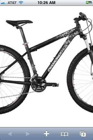

Alright, i just got into motor bicycling and i just go myself a 29'er diamondback overdrive. Now, i am concerned a 66/80cc engine and a SBP jack shaft kit will not fit because of clearance issues. I really wish that it would fit because this bike would be a blast with all of its bells and whistles. From the back of the seat tube and the closest part it comes into contact with the knubbies would be roughly no more than 1 3/8''. And the frame of the bike is an XL (22'') but becauase of the bend in the down tube, it makes the frame a lot smaller. please let me know if you think that it would fit a slant head 66cc? and an SBP jackshaft. heres some pictures and videos and also is the specs of the bike on diamondback's website. thanks and i will appreciate all the help as i extremely need it.
YouTube - ‪project bike? will it fit a motor and jackshaft kit?? i sure hope it does‬‏
stuff pictures by alienboy366 - Photobucket
Diamondback Bicycles Overdrive ’11
thanks,
nick
You bike does look like it might be hard to
Stuff a engine in there. But I really don't know though. Here are side by side pics of other 29ers and yours maybe you can
See the clearance issues.
