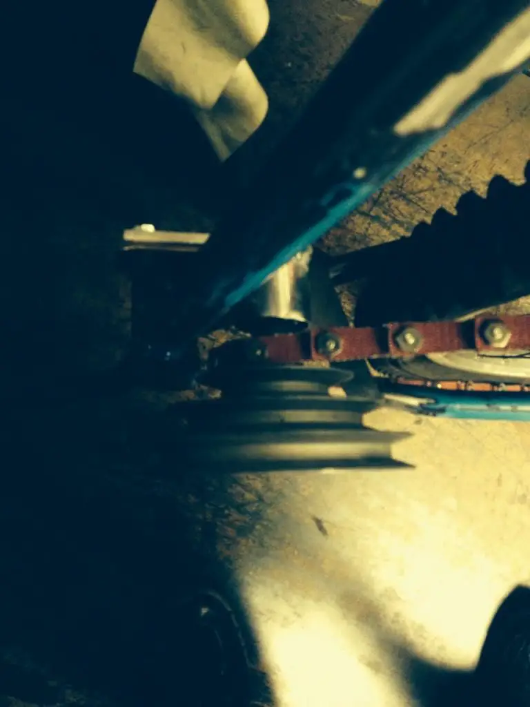

What's holding that pulley on is it just a bolt and washer or you using the bearing and nut from the old crank?
Villiers
Sep 2, 2014
42
UK
here's another angle of the pulley. The tube has a couple of bearings and spacer in, bolt thru pulling it all together. Bracket on the frame to make it removable and adjustable
I like the link belts, nice n easy

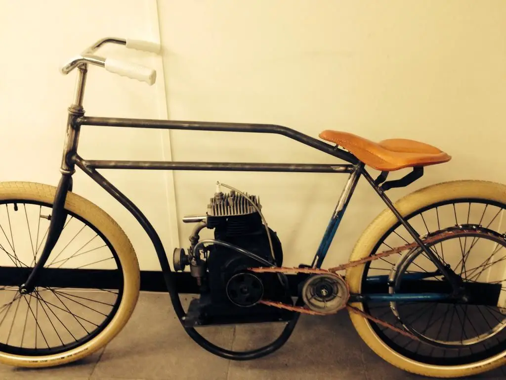

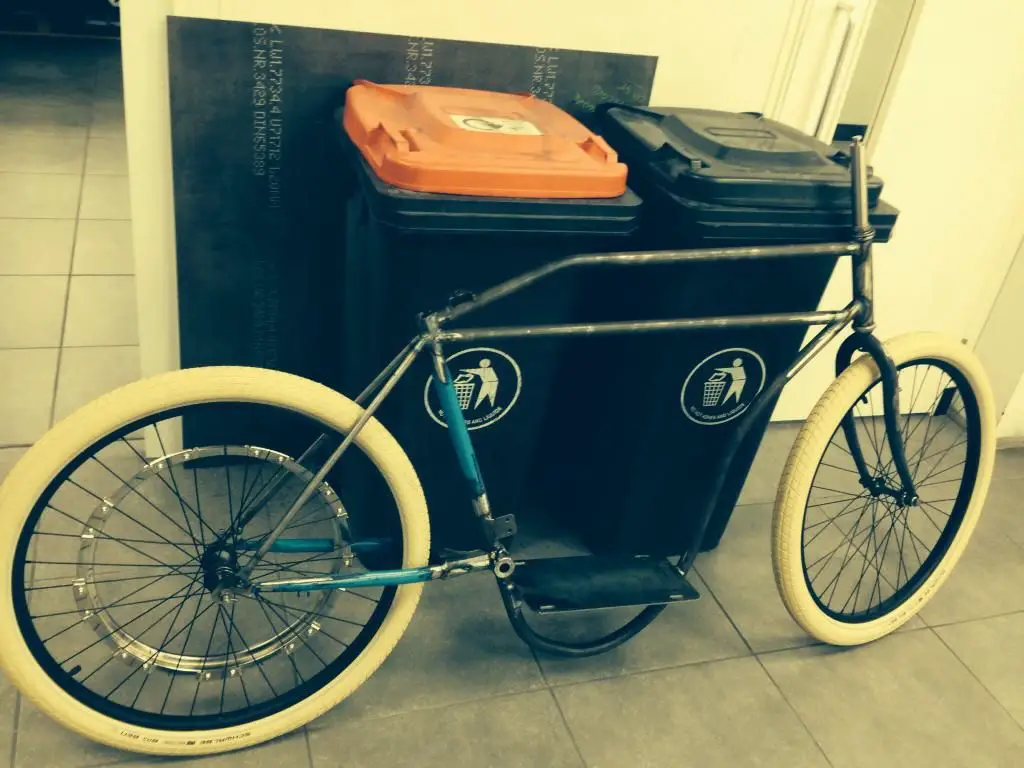

Happy New year to you all, had a great break, now need to get back on track. Frame all welded up and making seat brackets
Villiers
Sep 2, 2014
42
UK
I'll get the inclinometer on the headstock again, she won't be built for speed that's for sure brnot
Villiers
Sep 2, 2014
42
UK
Had a short fire up last week, problem no1 the engine speed won't overcome the clutch springs
