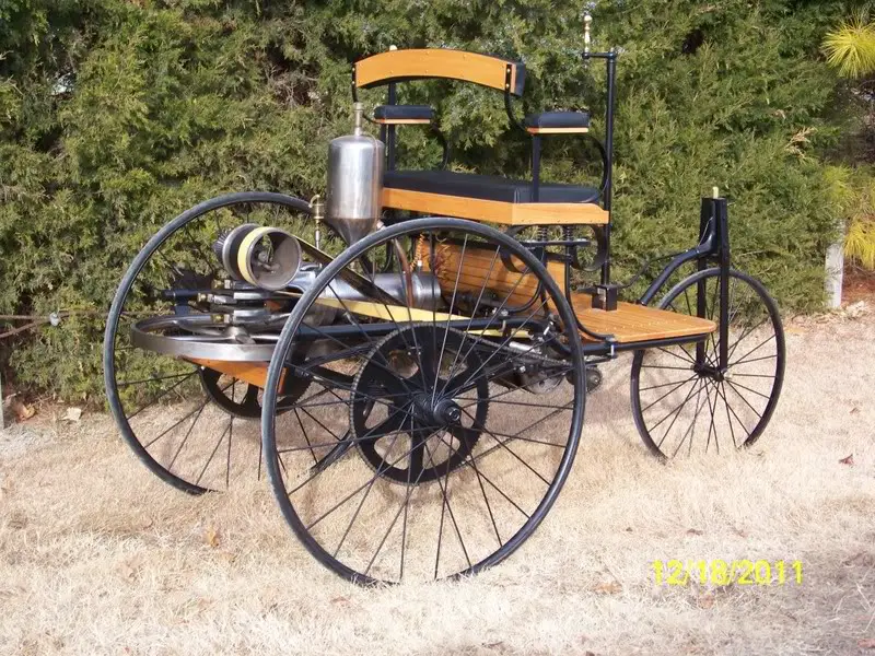

Steve the flywheels in the first and third pictures are cast iron wheels that I found and repurposed and are the only castings used.all the other parts are weldments that were welded then machined.
Here's a little about the engines
The first picture is a 1883 Economic motor works engine it was is a non compression engine built in the US.
The second picture is a 1888 Atkinson cycle engine it makes all 4 strokes in one turn of the flywheel and all 4 strokes are a different length.
The third picture is a 1887 Welch and Lawson - coke bottle engine
The forth one is a 1886 Benz

Wow, just wow. How did you make the tower for the 1887 Welsh and Lawson? I was looking at the flywheel for the Mercedes Benz and kept going back and forth with myself as to whether you had made it or not. I could sort of visualize how it was done but then it looked like an original. Then I looked closely at everything else and it all looked original but I'd seen you motorcycle so I was thinking it was all your work.
