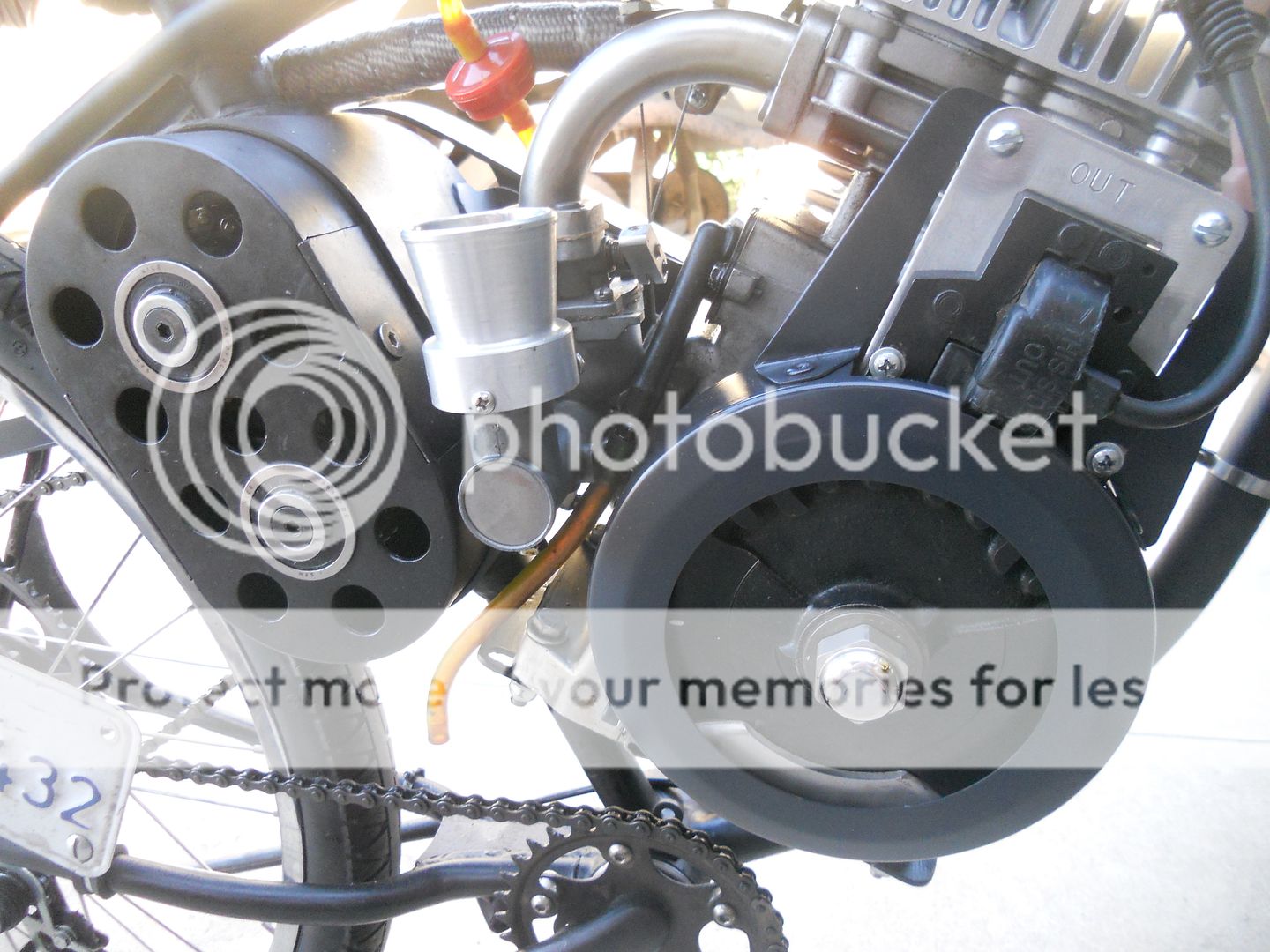

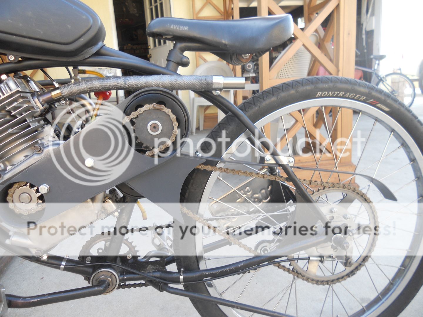

Finally fabbed up some guards for my race bike. Flywheel on the left and chains on the right. Now I can lube the chains without getting sprayed while I ride.
