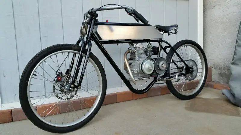

Thanks for your post Rick, you are spot on.
The GC series does not have a removable head so no up-grades but a carb and pipe, it will rev to the moon with the governor removed causing valve float and self destruction. The CVT limits out around 5k depending on spring setup, with a 52 tooth rear sprocket the bike was quick off the line with a top speed of 45mph at 4k rpm. Beautiful thing for a street bike....
The bike was rebuilt with some frame adjustments on the rear triangle, powder coated and sold. Miss it a little...lol
