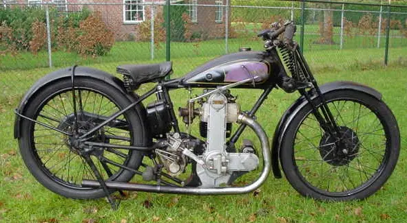

guys what do you think about the engine looking like this?
For some reason, your pics won't open out on my screen. Is it the R7 AJS we're looking at, as in this pic?
yes Ludwig its the k7 a.j.s 1920my its the closest look of engine I can make if I want the bike to be ready for cristmass
I like them. There's something understandable, accessible about those old engines.

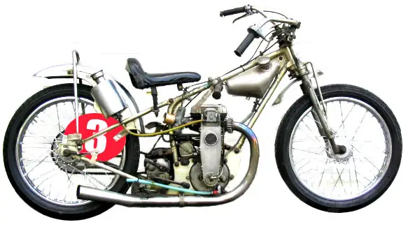

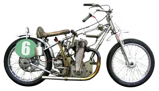

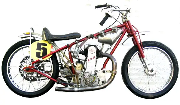

fantastic simple old style looking 4 stroke
