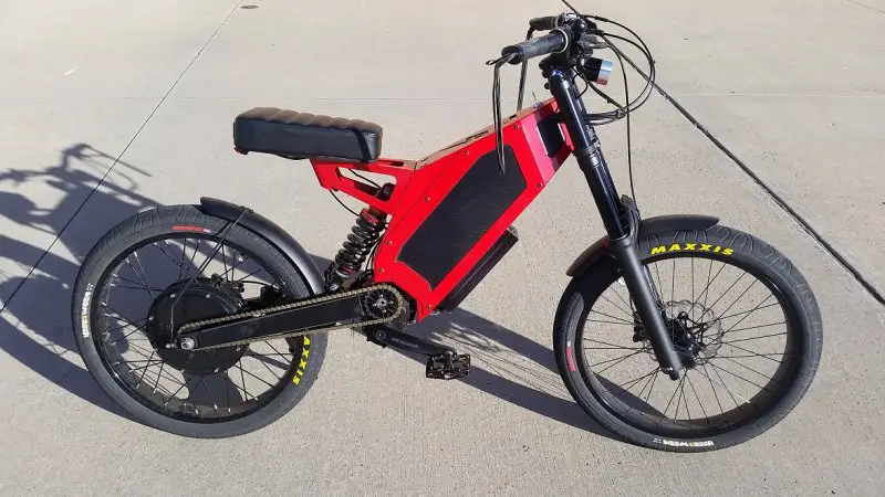

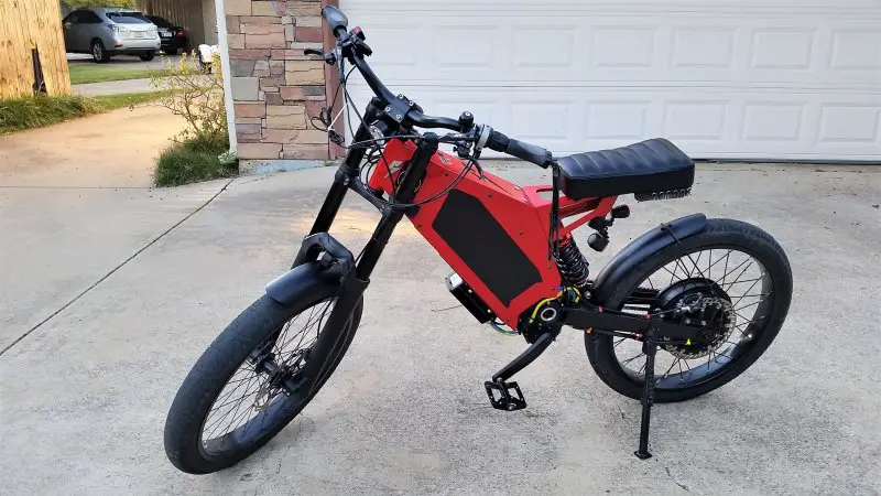

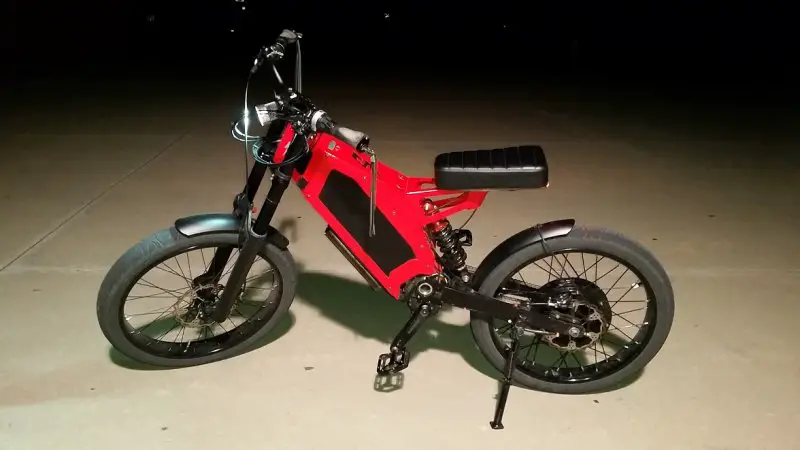

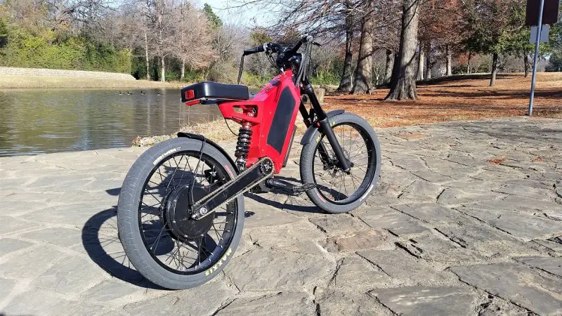

This is my new Stealth Bomber, electric motor bicycle. So new in fact that I've only managed to pedal it up and down my block 2 times. I have plans to customize it to make it mine, but right now nothing is carved in stone. I welcome your suggestions. I ride in the concrete jungle, so that's the direction I'm heading with modifications.

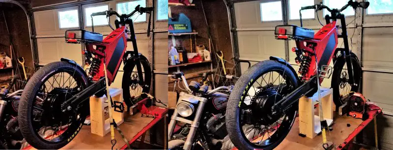

All I've done to it so far is install low profile street tires to replace the knobblies that came on it from the factory. The only other work was to start installing a headlight. It didn't come with any lights or a kickstand.
The bike is officially designed to be a down hill racer, but I'll be using it more along the lines of a super motard that hardly ever sees the dirt.
Power output is electronically governed to the U.S. limit of 750w, and 20 mph top speed. Ungoverned off road power output is 4500w with a 50 mph top speed. The battery is 1500kW, with a 2 hour charge time, and up to 50 mile range.
It has something like 10" of suspension travel front and rear, adjustable for preload, and rebound.
This is the beginning.

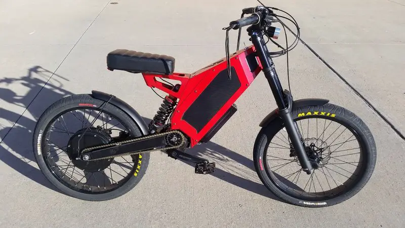

So....not really a bicycle, but still funYes I agree. Stealth's are lousy pedal bikes to start with, because they weigh too much. For riders like myself that ride almost exclusively on the street the main reason for pedaling is to defend the bicycle loophole. At first I thought that might be a thing , but time and experience has shown it's not going to be an issue. That being the case I'm going for comfort, and style. Riding the Stealth like a pedal bike never did feel right to me.View attachment 106204
After playing with 72v and 120 amp setups for almost 18 months. I decided instead to go with 48v and 50 amps and lower gearing. 20 amp battery gets good range and cost is quite low. I realized for my use that 35 mph with good torque was a better setup with clincher tires and a hard tail.
I like the Stealth setup you are now running and fifties are good speed for your bike and safe in that configuration. I can well believe it's quicker now with more torque from higher current. Since you didn't mention increasing battery voltage I wouldn't have expected much change in speed, if any.
Good decision and nice bike!
