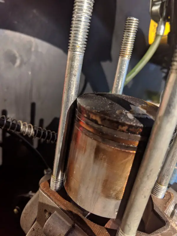

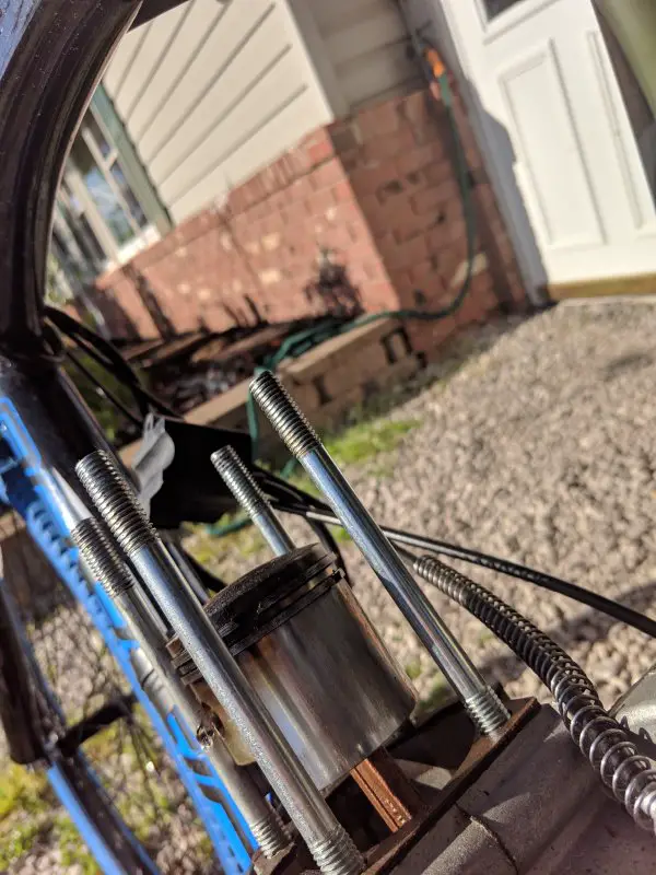

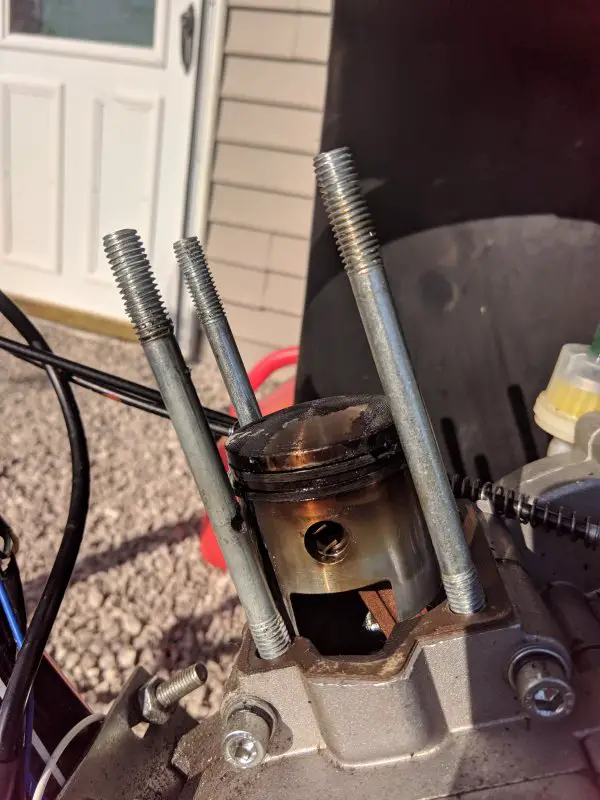

I had the suggestion of checking the piston to see if something was not looking right, and there is evidence of blow-by (once I saw the top of the piston, pulling the cylinder was a must). The engine has maybe 3 hours on it, so this definitely seems excessive. Uploading pictures.

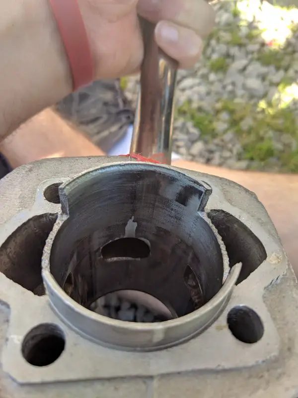

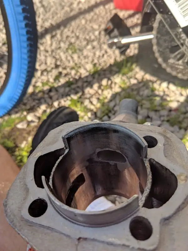

The cylinder doesn't look great, but I honestly have no idea what normal wear looks like. This is all new to me. Including pictures of that as well.

Right now you do not have an intake prob. I hate to be bearer of bad news but what you got right there is bad cylinder plating. There is nothing you did that caused the prob. I've seen this many times. These cheap engines are sent from China to us stupid americans without assurance or insurance concerning Quality Control. The Cylinders in these engines are not sleeved or lined, but coated with a chrome plating. What has happened, and I've seen it before, is the chrome plating has flaked off. Was never properly applied or circumstances were not just right and this is the result. This forum has been peppered with stories similar to yours. "Got it going and it ran great for a couple weeks and now NO POWER". What happened? You got a bad one from the start. This whole darn thing is a crap shoot especially from volume vendors, The only assurance you can have is to buy from somebody who takes them apart and inspects for this very reason. If you cannot talk to the person who receives them, inspects them and stands behind them it's a crap shoot. Yes I am disgusted and you should be too. Happens far too often. None the less you need a new cylinder and rings. You may keep your piston but also remember it's best to buy a complete top end that way you get it all. You will need to identify exactly which engine you have. Some are one type then another type, and then a combination of the two. Yet then again you may be better off to buy an engine only. I hate to see this but - tag you're it today. I'll sit back and see how you do. Maybe somebody else can help you with what you got right there but I highly doubt it.

So it was just bad timing :( perhaps getting the gasket opened up a bit gave it just a little more power which aggravated the issue, but either way, wow... Y
I know they're a crapshoot, but still sucks. She ran so good for that brief moment in time.
I went ahead and ordered a cylinder and rings, and if I need a piston too, I'll get that as well. Probably just should have gotten them all together, but I don't know if mine is a high hole or low hole, so taking another gamble I guess.
