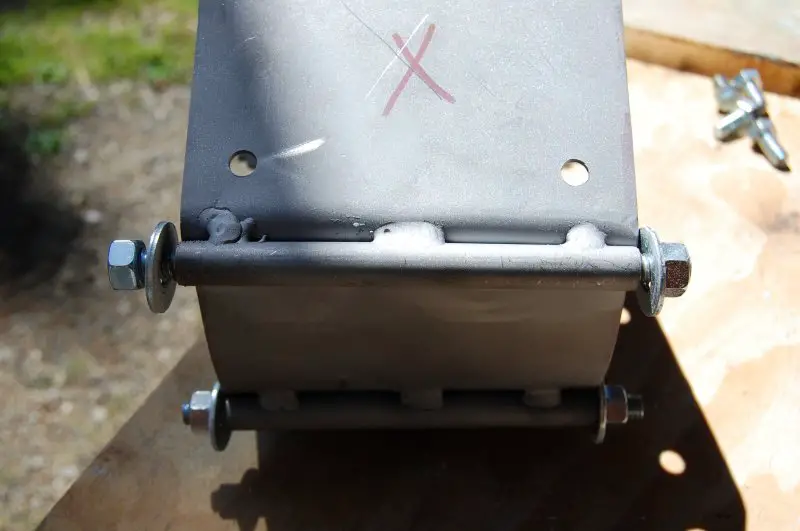

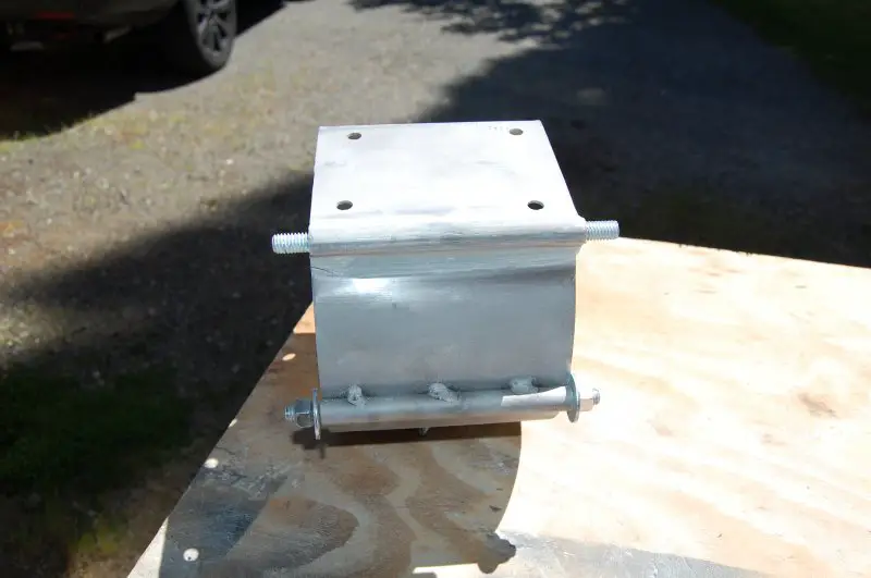

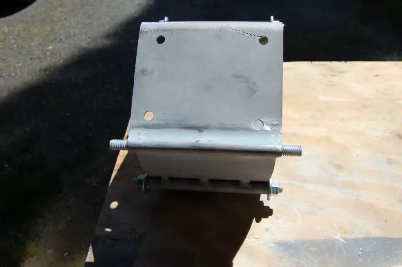

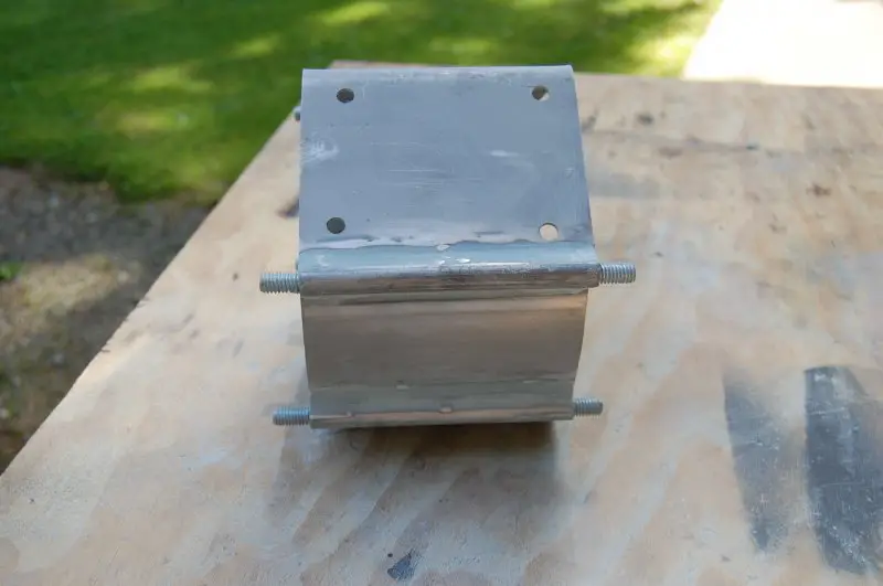

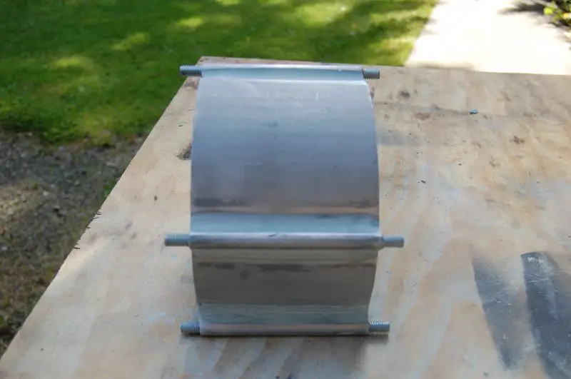

I welded some tubing across the crankcase body and threaded some all thread rod though each one so the side plates can be held on to the crank case.
I moulded the tubing to the crankcase today with short hair body filler that contained Kevlar. Trying to match the cast look the early motors had when they did the same thing to hold the two halves of the crankcase together.
I'll go over this body filler with some regular filler just to smooth it out and fill any voids.
Then I have to center the electric motor shaft in the side plate of the crankcase and cut it out so I can make the motor mount.
Steve.

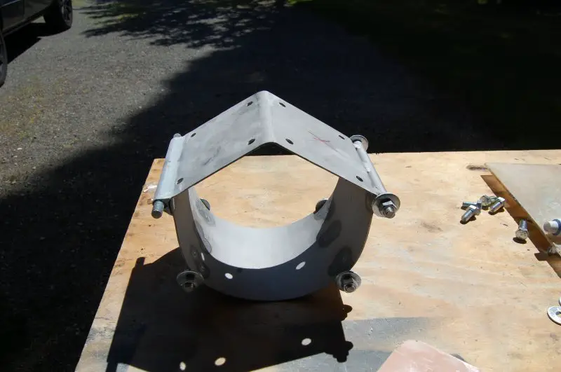

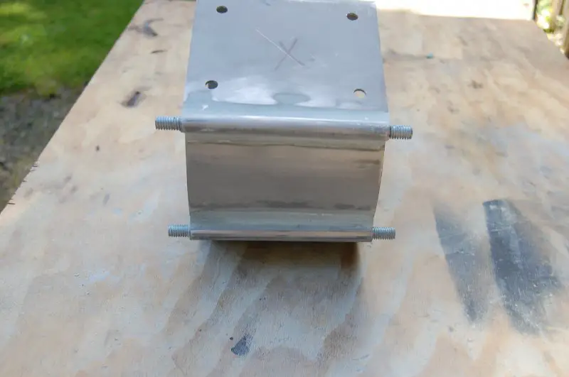

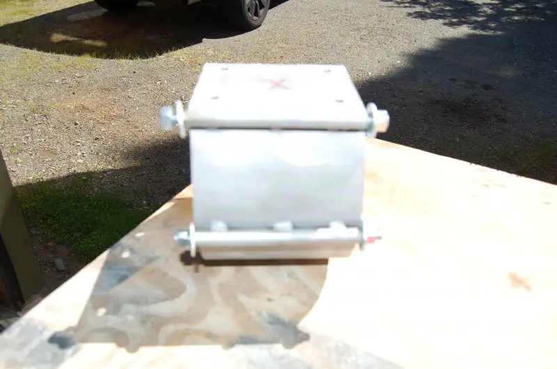

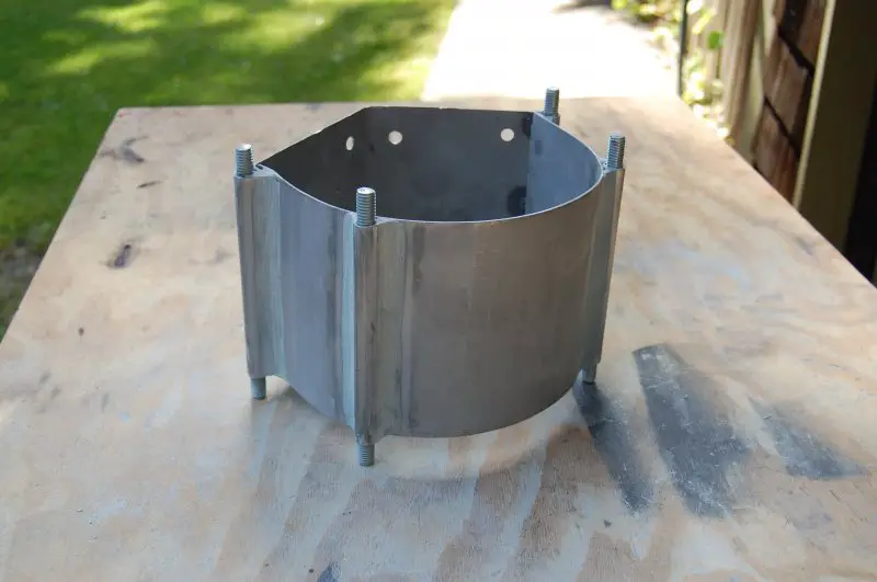

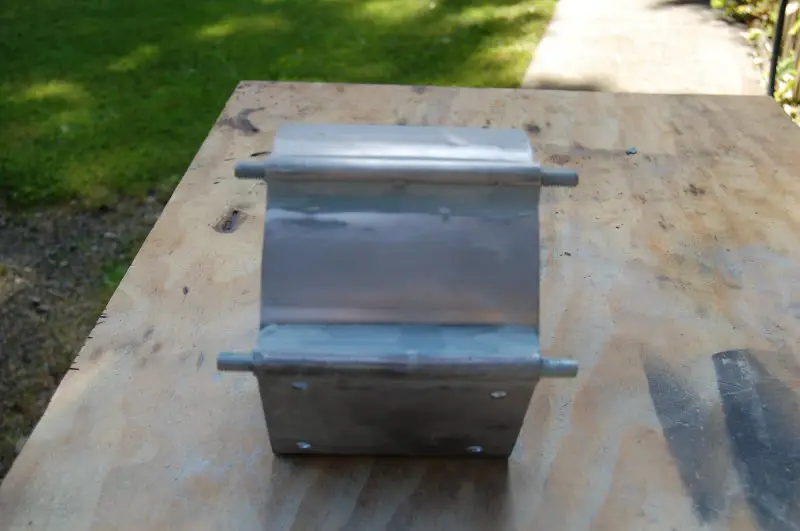

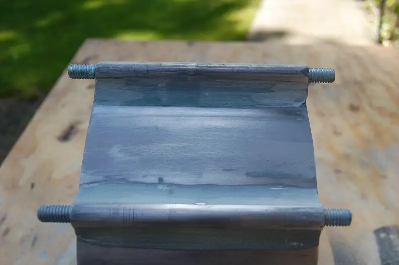

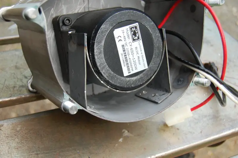

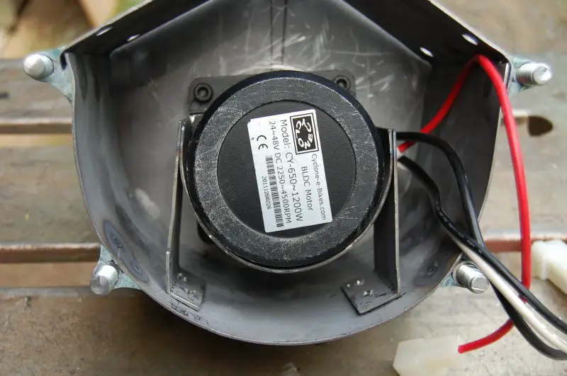

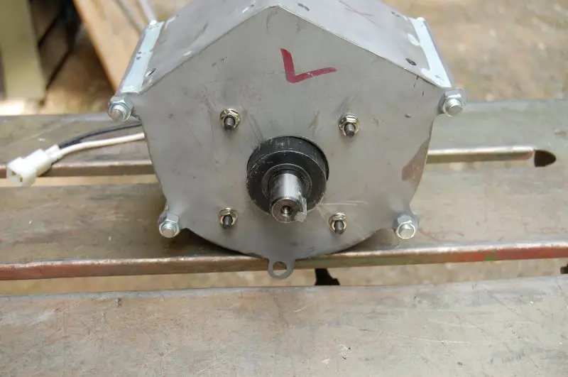

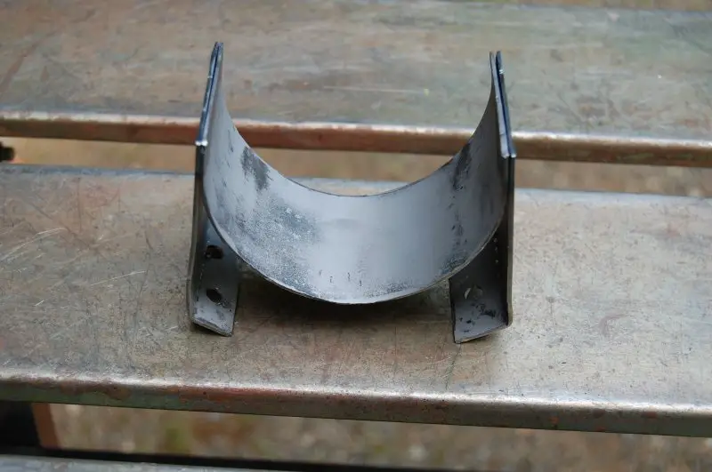

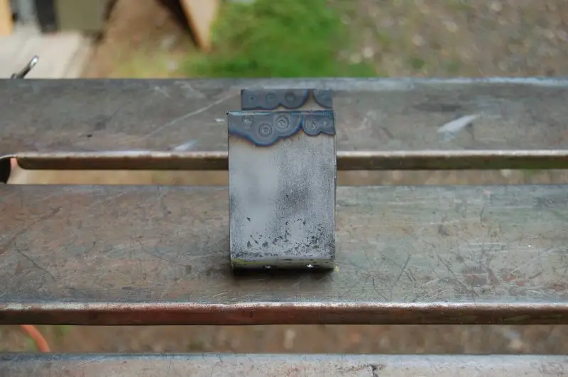

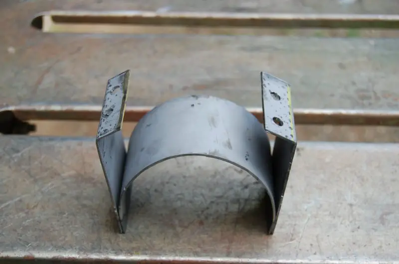

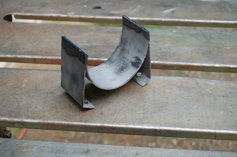

I made a saddle for the rear motor to sit in. The motor mounts to the side plate of the crank case but the motor is heavy for it's size and I thought that it would move as power is applied and released.
This way I hope to minimize any movement. I bent the plate around the motor and cut it to size and then made the legs to mount it to the bottom of the crankcase. The motor mount will be bolted in place in case there is any need to remove it.
Steve.
