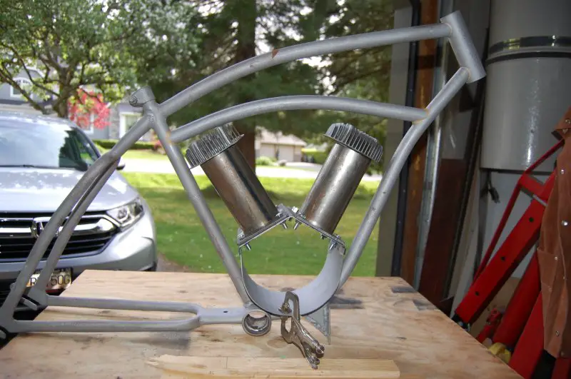

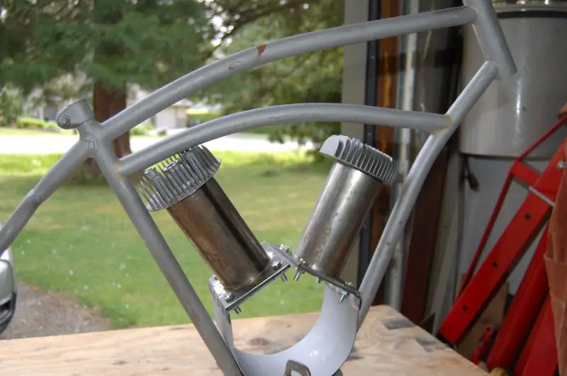

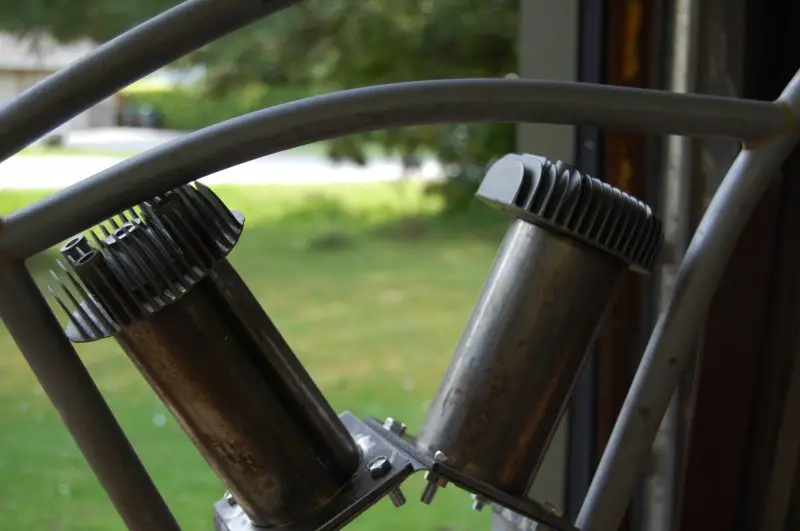

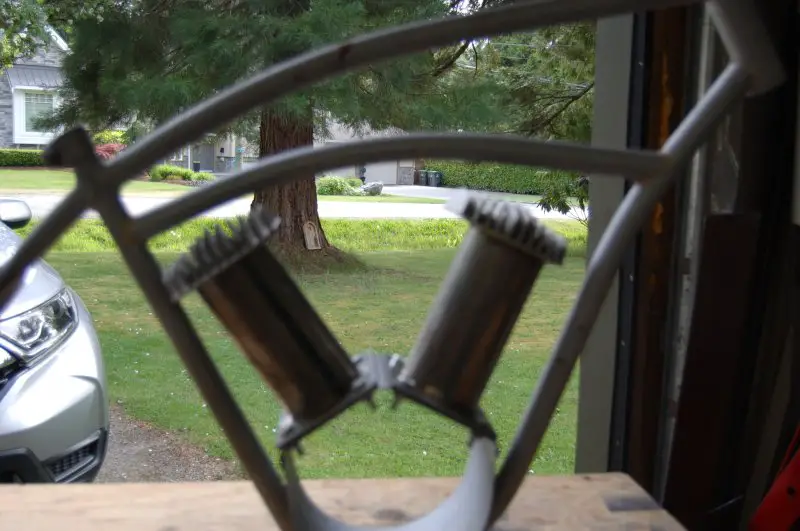

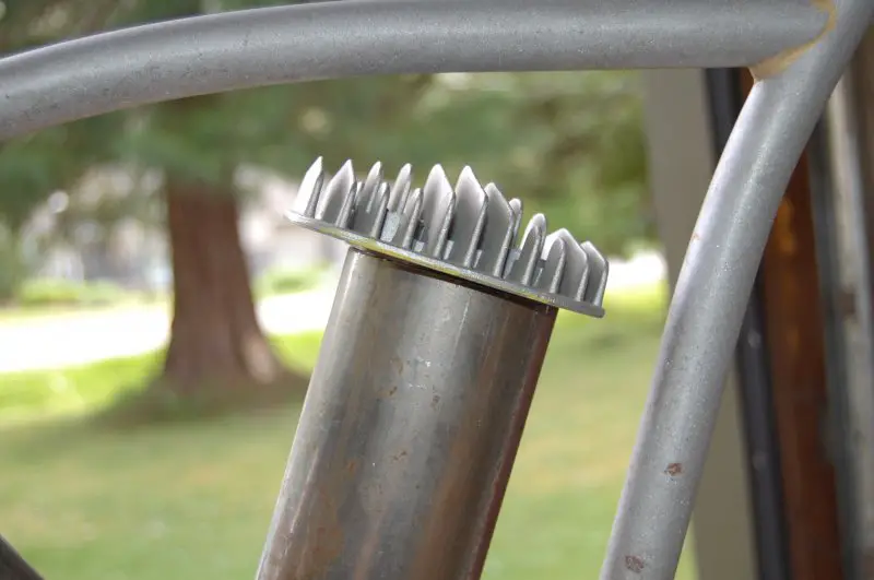

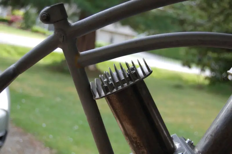

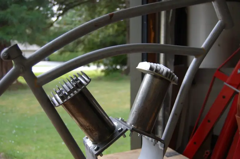

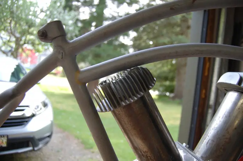

I bolted the cylinder mounting plates to the crankcase and pushed the cylinders into them temporarily and set both the heads from the Jacobsen motor that is in the Indian tri car and the China Girl 66cc slant heads to see what the difference would be.
The China Girl 66cc heads clear better but the Jacobsen heads look nicer. I think I'll have to remove a 1/2" off the cylinders for the rear head to clear. Then I have to see just where the motor will sit in the frame to make sure the spark plug clears the frame with the Jacobsen heads.
The mid motor I'm using for the build is designed to drive a chain ring that sits beside the pedal chain ring and drives the rear wheel. I have a Manic Mechanic rear wheel sprocket mount that I removed to install a Sportsman Flyer 3 piece sprocket mount and the purpose of the build was to use up all the spare parts I have sitting around but I think I'll go with Pat's set up again if I set it up that way. I'll add the other sprocket and adapter to my sons care package of things I'll never use.
I should have the parts for a jack shaft on the shelf. Try and check tomorrow. Probably in one of the mystery boxes I haven't looked in in years. Lots of 5/8" and 3/4" keyed bar stock and bearings.
Steve.

Steve it's looking berry good, delicious! What angle? As you build keep in mind it doesn't require oil. compression spark or routine spark plug removal, but that said being able to unbolt head, jugs and side plates is very desirable. High exhaust ports on the L head make it easier to plumb than the low port design F head. Attaching the intake tubes is entertaining work.
You've made a really good start. I expected to have fins in hand Saturday and I'll check tomorrow for progress as the shop owner will be cutting this batch out due to social /commercial distancing and all.
Rick C.
Hi Rick,
The angle of the cylinders is 40 degrees. The heads and the side plates will be removable. The heads just in case I have to and the side plates so I can get to the motor.
I started on the side plates today but gout or as I prefer to call it "The Hot Foot." drove me back into the easy chair. It's let up so tomorrow looks like a good day to finish it. Then it's time to look into devising a jack shaft that can be hidden as something else.
Steve.

Hi Steve sorry 'bout the gout, but glad the weather is giving you a break.
I'll check on the fins today, really thought I'd have them by now. I'm hoping that the city fathers aren't selectively enforcing the no work ordinances that are in place for many. His shop is half a block from city hall and police department.
The exact angle isn't critical but going much over or under 40 can cause problems in what we would think of as typical bicycle frames.
I first thought I'd go with a bottom bracket location for the jack shaft transmission which is really quite sensible and the most authentic look. I also considered hiding the jack shat in a magneto look housing before locating the jack shaft in the motor case housing, which was a bit more work and created some issues that l had fun with, but I'd say the bottom bracket location will be my choice for the next e-V-twin or single. A battery ignition box or oil tank could also conceal or the most obvious would be a simple transmission housing 2 or 3 speed look for a simple reduction gear jack shaft transmission.
Re-locating the bottom bracket aft of the seat tube is seen on some old V-twins & that yields space for the larger cases. The Harley bikes, and others, really jammed the rear wheel forward and left only an inch or so between tire and seat tube, perhaps looking for rigidity, but I'd think ride/handling issues would have resulted that the rest of the bike's design had to compensate for.
