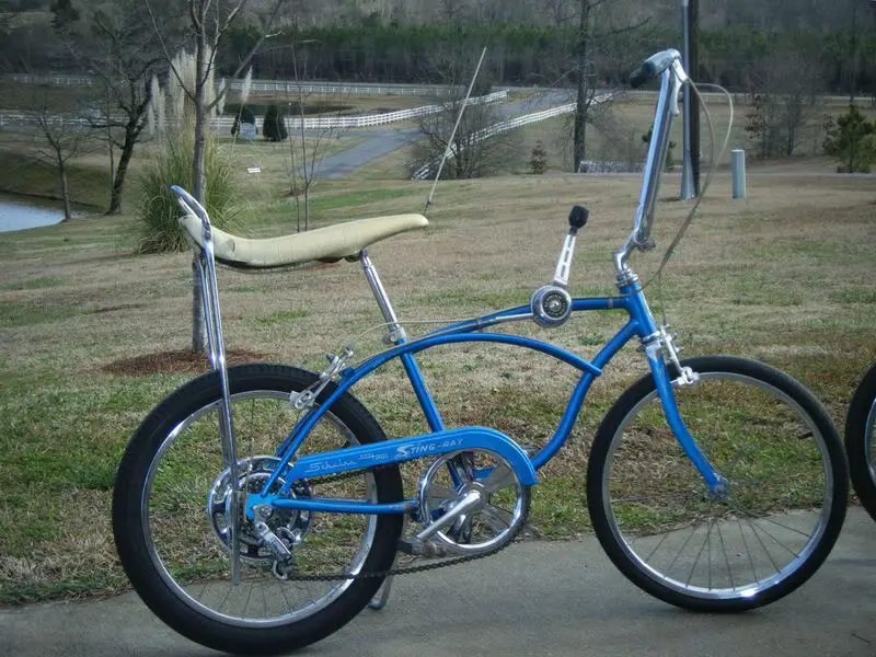

http://hotrodbicycles.gostorego.com/ how about this .....![]()
I'm afraid your confusing two different things. A jockey shifter is simply a shifting arm clamped on to the end of the shifting forks on a transmission. Some of the earlier bikes like Harley's and Indians had foot clutches and a shifter on the gas tank.
It was considered cool to remove the tank and shifter especially when building a chopper and you removed the tank and shifter and replaced it with a different tank and added the short shifting arm to the shifting linkage so you could shift the transmission. You looked like a jockey whipping a horse when you reached down to shifted hence the name. Usually on the right side and placed low on the frame.
If you don't have a transmission to shift you won't need the jockey shift and if you have a multi speed rear hub you could mount the shifter low on the seat tube so it pulls the hub shifter through the gears much like the cross bar mounted shifters.
