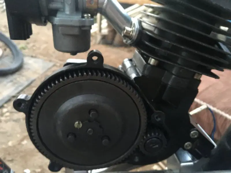

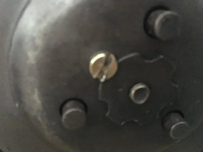

You need to use the biggest screw driver you have, looks like the screw is very tight. You may need a impact bit tool to remove it, harbor freight has a light duty impact tool that works good for bikes. If you have a screw driver with the shaft going all the way through and exposed at the handle you can tap on it while holding it in the screw and turning, that works sometimes.
