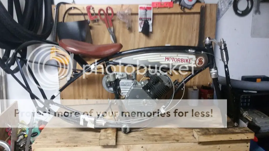

This is where I'm at today. I Brought the belt guard and fender to work today, I had to notch the fender and cut the center out of the belt guard (the auto-clutch won't fit under the cover) I have a seat lined up, and believe it or not a special new engine will be going in this bike and current engine will be going in the old bike. One of the things I wanted on this bike was lights, this has a headlight and a tail light.. Inside the shells are Supernova lights powered by the front Sturmey Dymo hub.

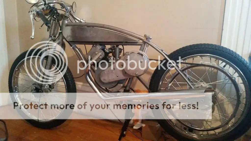

Needed to make up a plate and arm for the rear drum brake, this along with the seat and kickstand plate will be welded on.

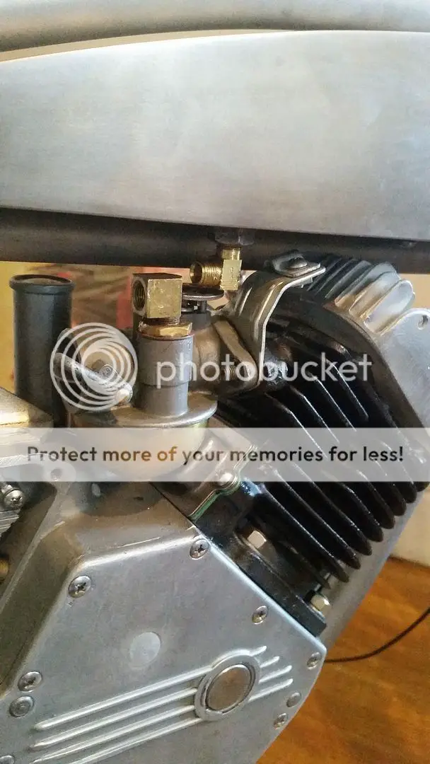

So with the new motor and higher head I had to test fit and everything is OK except the fuel lines will be a problem as you can see in the photo. I ordered a stainless bung and will be having the bung relocated. Details on the new motor...
Vintage Carter carburetor [Whizzer version]. Needle bearing crankshaft, Whizzer "racing" piston, "custom" made wrist pin Hi compression head [re-worked & milled], "H" crankcase with a ported "300" series cylinder [with larger valves], aluminum "300" exhaust manifold, tall oil breather [allows 8 oz. oil in crankcase], .193" lift camshaft, copper head gasket, electronic ignition module, crankshaft seal, left side crankshaft bearing, right side needle bearing [in the side cover], and all new gaskets.
And My other bike made it back home and to the work bench, it is already apart to be blasted and painted I will be replacing the motor with the rebuilt one originally slated for the other bike. This bike will be redone into a cruiser style.

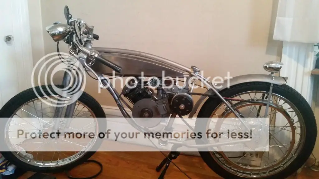

Got My seat from Sportsman, I think it looks just right! I figured to take a photo before I take it all apart. I need to have the seat welded on and the tank bung relocated to the rear. Next photo should be all dressed up in new paint.

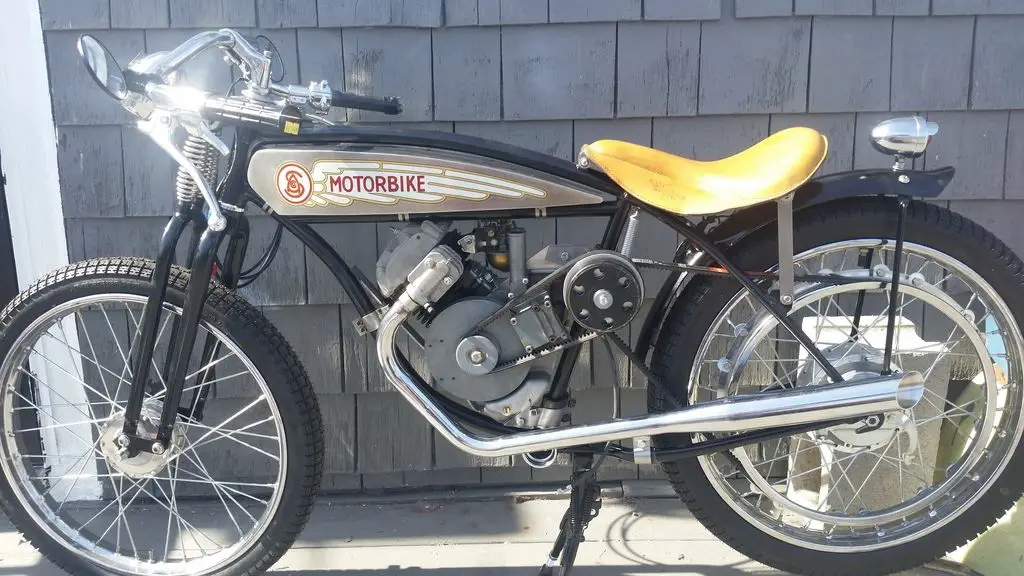

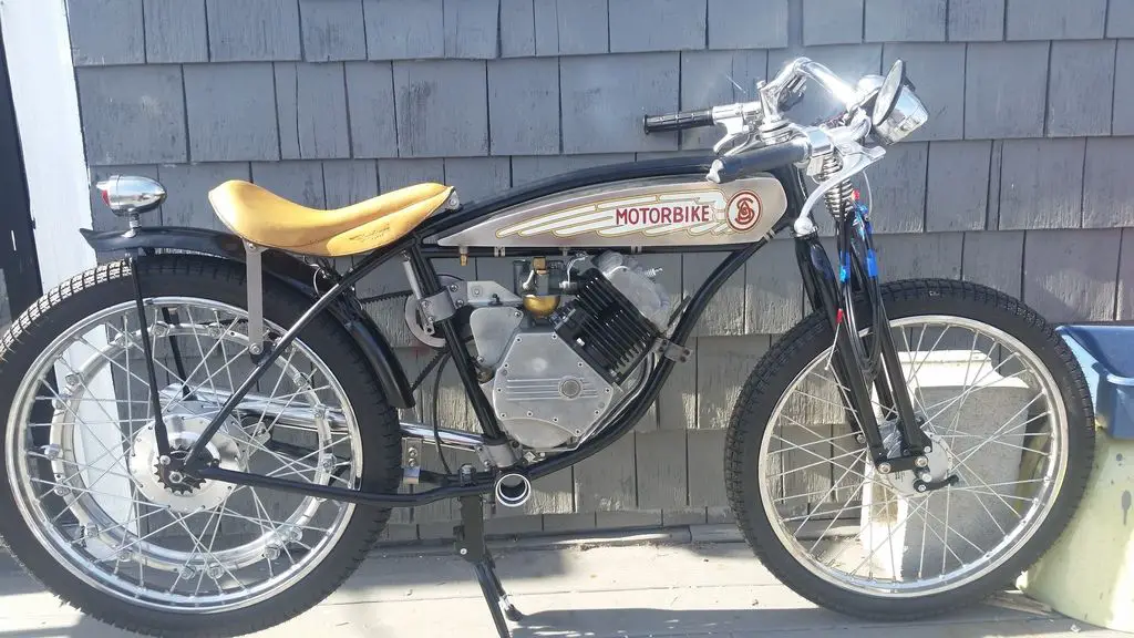

Just about done , just a few bits and pieces to install. Going to DMV today to get sticker.
