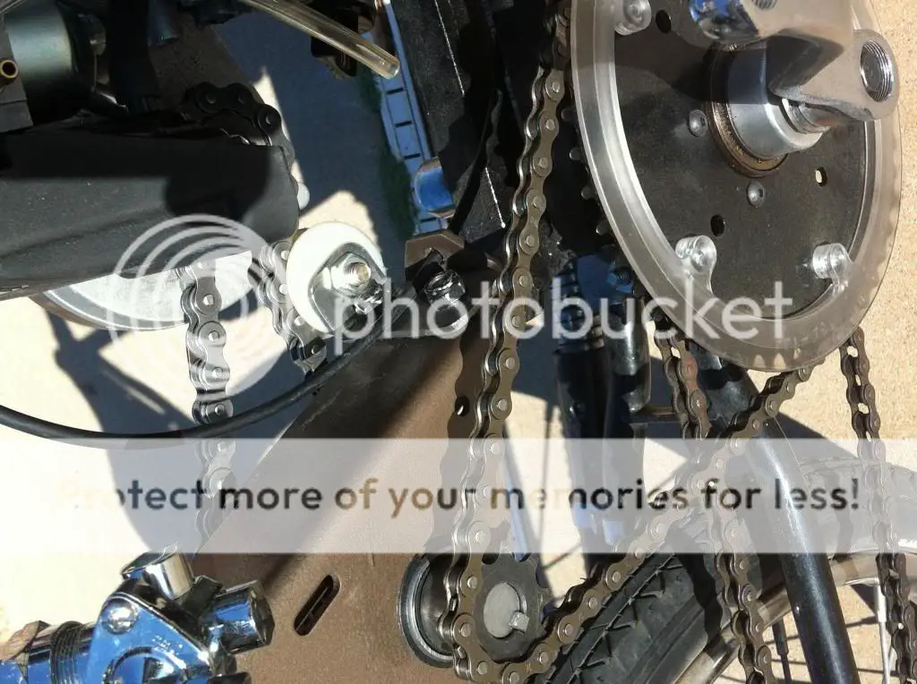

Here's my solution to the extra slack in the drive chain. It works great and uses the jackshaft mounting bolt (u bolt) to mount it up. Simple is good and it works great.

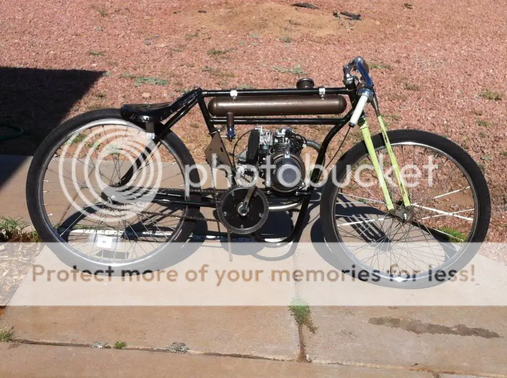

Here's the full side view. Seat is mounted absolutely as low as possible. I wanted it real low like the real BTR's, solid strut mounted to the upper seat stays.
I'll get more detailed pics as the details progress. I still am planning some sort of faux oil tank behind the seat tube, lettering, and pinstriping, a leather seat pad (riveted to the seat pan), cream tires, CORRECT BARS, and some sort of filler piece for the drop loop. I have a nice piece of scrap plate brass that i might drill out to make a cool looking filler piece with some speed holes or something. Also i might make a brass plate to fill in the center of the pull starter. Oh and i need some old looking steel pedals too. I was thinking of some names for the lettering job. Any suggestions? I was thinking of calling it 'Brass Monkey' with of course green and gold striping.
