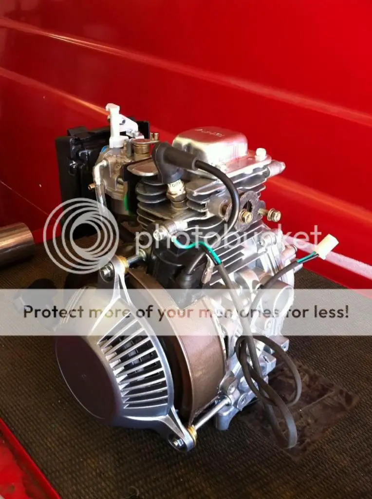

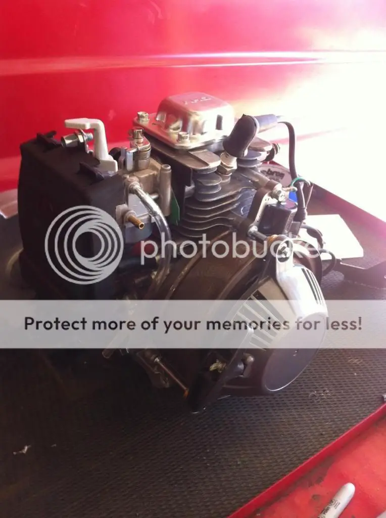

I took my motor out of the box today and took all the ugly shrouds off and threw away the plastic fan cover. The cooling fins on the motor look much better than the shrouds. I did the coffee can mod that Im sure all of you guys have seen to make a new fan cover.
The fit came out pretty good after trimming with some tin snips. I painted the cover a bronze hammered finish, which will be a common theme on my bike. I painted the pull start a pewter metallic to try and get it to not look so plastic. Its okay, but it still just doesn't look right. I might make a machine turned alluminum or brass round plate to go in the center that might fix that up. And now ive got to get rid of that ugly air filter.

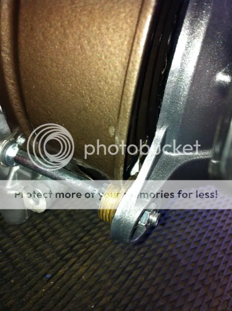

Oh also, if anyone does this mod, i just got rid of the shoulder/allignment washers because they didn't allow the nuts to tighten the pull start up to the motor. I stacked like 5 brass washers and one large brass washer on top that holds the tin in place, and the alignment for the pull start works great.
I second that motion to add the luver/slits but over all you have greatly improoved the appearance of the engine,even the outer shroud looks decent perhaps a hammered silver paint on it would get rid of the plastic look.
