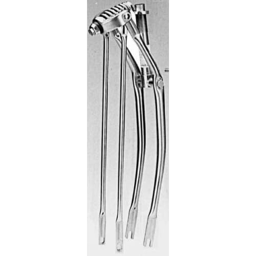

There is a company called "Pyrimid" who makes the single spring (girder) front fork
in 26" as a bolt on. It's a straight replacemen and they supply them in chrome or paintable
black if you wish to paint them to match your bike. (those forks which use multiple springs are called "springers" from what I've leaned here)

I have the single spring girder fork pictured above and it works great on my bike. Just buy the longest head tube available and cut it down. That's what I did. All you need is a hacksaw or Sawzall and metal blade.

I am using the fork eDJ showed in his post and so far it is holding up. The fork post is extra long and must be hacksawed off to match bike, but that is not hard for anyone with a hack saw. You got to keep an eye on the bolts and keep them tight but not over tight. 700mi and working great and a good price. Went to the bike shop and the old schwinn type was as much as a monarch so get a monarch if you are going to spend the money, best looking forks I have seen yet. But these springers of mine and my spring seat make riding smooth sailing.

If that thing is a Japanese repro like I have, it is flimsy through the horizontal pivot. I just hope my real one will cure the problem.
